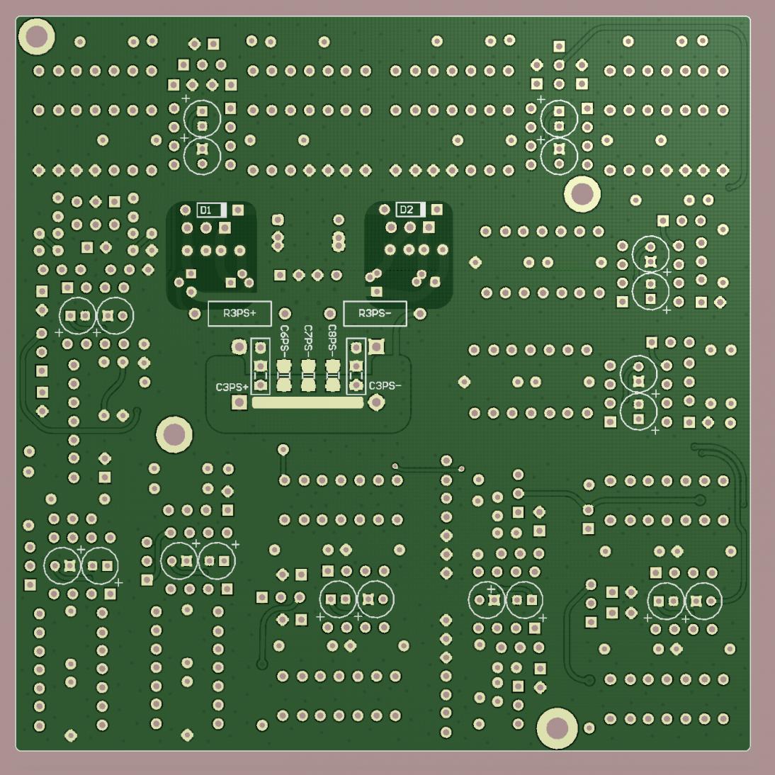

Almost there 🙂
Changelog in v4:
+ Reverse diodes on regulator's input-output.
+ Completed the power supply traces.
+ Optimized the thermal relief pads - now thickier and with rotation in some places.
+ Vias are everywhere i've found appropriate to stuck them. And even more!
+ Multiple footprints for small PS caps - (2/2.5mm and 2.5/3.5mm).
+ Holes! Actually four of them - i should withdraw the hole in bottom-right corner (at TS) for better power traces routing. Three is a magic number.

+ "Proper" power traces for opamps, leaving center point between bypass caps clean of traces - the currents from "+" and "-" should flow thru bypass caps and end-up in single point canceling each other out.
- 3 traces left unrouted 🙁 i'm unable to fit them nicely - lots of power traces to cross - i should leave them hanging - anyway the board is suited for rearrangement of connections. There will be jumper wires.
- Had to go with smaller component labels on silkscreen - 7mil thick/35mil height. PCB production allows 6mil silkscreen, so i'm on the safe side.
Ouch, there is some free space under PSU - i can move it a little to give more space for regulator heatsinks. Too bad i already have the power traces routed 🙂 No problem, it is doable. In addition, i'll allow 20mm caps to be fitted on the board - currently there is space for 18mm, and 1mm wouldn't hurt.
I can't give "multiple" footprint feature to large PS caps, as i want to keep the rail planes solid.
*gettin sick of this project*
I've got some elna silmics 10uf/25v for opamp's bypassing, heyah! 320 pieces...
Currently the board allows filter caps of 5x20mm (up to 18mm lead spacing).
I've checked WIMA datasheets and they have caps in 6x20mm case - maybe i should change the footprints on the capacity-demanding sections (bafflestep, woofer/global notches and woofer high/low pass).
I have simulated the board in microcap and it works! 😀
So, todo:
- Move PSU
- 20mm diameter footprint for PSU caps
- Check whether it's possible to squeeze 6mm thick caps in woofer filters.
- Simulate the PSU - to find out proper large cap and feeding resistor values.

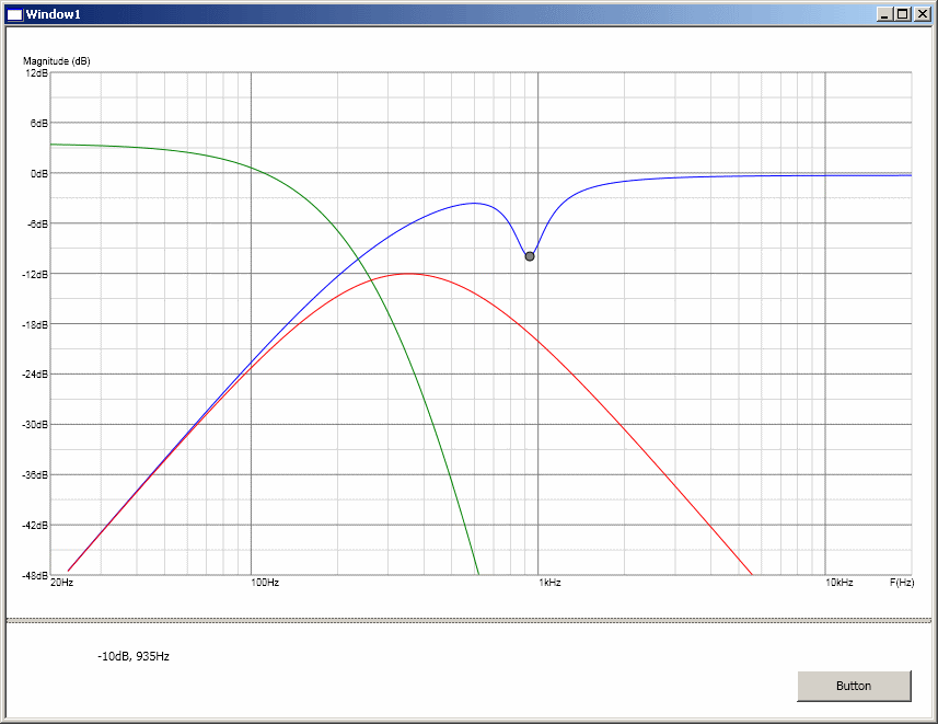

I'm working on modeling program right now.
I already have transfer functions layer - both ftransfer functions written for filter's topology - in complex numbers, and their AC analysis/simulation/chaining.
I had a trouble with finding a good charting component for drawing a frequency/phase/group delay responses... I decided to write my own component for this task, and also try the WPF technology. Viola, my charts are up and running! Nice and fast drawing, and lots of flexibilities.
I want to make a graphical response designer, where you drag the points on the frequency response chart, and these points are attached to specific filter blocks and their parameters. In example, you want to put a notch at 10kHz with a Q of 0.7 and -12db down - just drag a tiny circle to 10khz, -12db, and then "drag" it with right click - to change the "Q" factor. The frequency response should change as you change the "circle" parameters.
I'd like to put a transfer functions of bafflestep and enclosures, and in the future - frequency response import from "frd" or other files.

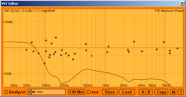

Ahh, the "graphical filter designt" idea isn't mine - i just love how it's done in ElectriQ VST plugin.

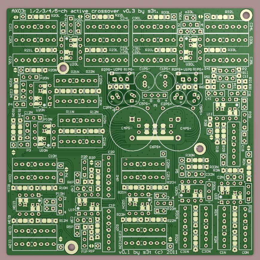

Ok, PCBs arrived.
Errata:
- LM317/337 are swapped. Their 2 and 3 pins should be switched prior to mounting. What a silly mistake 🙂
- PSU input is buried in PS caps - pretty hard to get there after you put all the components.
- Not enough space for regulator heatsinks (i knew it). Could be fixed by squeezing the regulators inwards (there is enough space for this).
- Mounting holes require tiny screws (standart M3 screw but with small (conical) head).

Little bit of updates to software:
Control points are draggable, and the graph is recalculated in real time while you drag the point. You get smooth frequency response manipulation.
Q for notches is changed by right-click-dragging of notch control point.
- Added phase plot to frequency response graph - looks better now. It's color is yet to be changed to something less aggressive than red.
