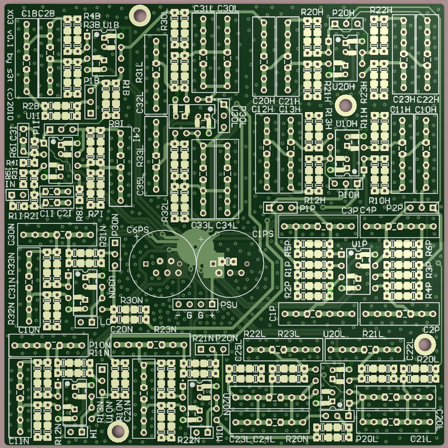

Hi all!
I'm on finishing stages of crossover PCB development, and need yours input on my design.
The crossover board consists of:
- Input LPF for HF noise elimination (passive stage)
- Gain/input buffer with limited bandwidth feedback
- Bafflestep
- Single global notch + buffer after the notch
- LP for woofer
- HP for midrange
- Variable phase for midrange
- LP for midrange
- HP for tweeter
- Variable phase for tweeter
- Each output stage for woofer,mid,tweeter consists of single notch + output buffer.
The filters chaining is as described at LinkwitzLab.com - the tweeter signal travels the following path:
- Input - bafflestep - notch - hp mid - phase mid - hp tweeter - notch tweeter - output buffer, so there is no phase errors between woofers, midranges and tweeters.
Currently i'm doing the following tasks:
- Upgrading the PSU - from simple chunked-up capacitors to LM317/337 regulators on board (they shouldn't produce much heat)
- Adding optional balanced input at input stage (simple single opamp scheme)
- Adding ability to bypass/reroute all the sections (say, you want to use it for full range speakers, but with 3 notches and no phase shifter? no problem!, just chain-up the output notches and bypass the phase shifter/LP section).
- All the HP/LP filters are 2/4-th order (selectable), Sallen-Key topology.
- All the passive elements footprints allow placing both SMT and thru-hole components
- All the filtering capacitors could be up to ~40mm length, 5mm wide
- All the filter resistors are built from 4 paralleled/chained SMTs, or 2 paralleled thru-holes - for getting exact values from limited E12/E24 values range. (the values finder will be supplied as a windows program or web service - you type the required value, select E12/E24, and get the closest value from chained/paralleled resistors).
As a side note:
Each opamp bypassing circuit requires:
- 1206 NP0 ceramic caps (value range is around 1n-3n, or anything you have around, that is not too small for the application)
- 5mm diameter electrolytic cap (anything you have, rated at 16v+, 1uf+).
- Opamp sockets are required - you have to use the gold=plated ones with round pins - they stand out of PCB for a 1-2mm - this space is required for placing PSU bypassing SMT caps.
And... everything is stuck on 4x4in PCB! You'll need 2 boards for stereo.
Design highlights:
- Two-sided ground plane pours
- "Starry" power delivery to ICs
- Both SMTs and thru-hole components are possible in most cases, in various sizes (good for huge film caps)
Pricing guestimation? 10$-20$ for single board.
Ordering? You'll be able to buy the boards from seeedstudio.com, after i test/fix the first PCB batch for design errors.

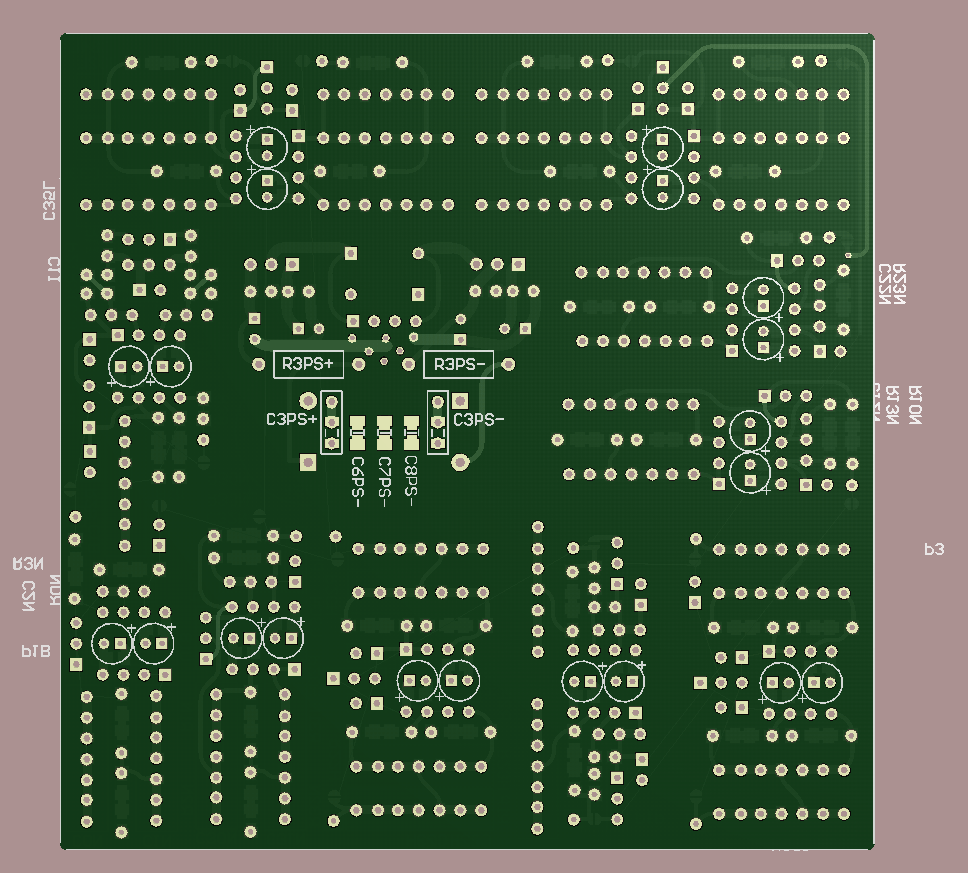

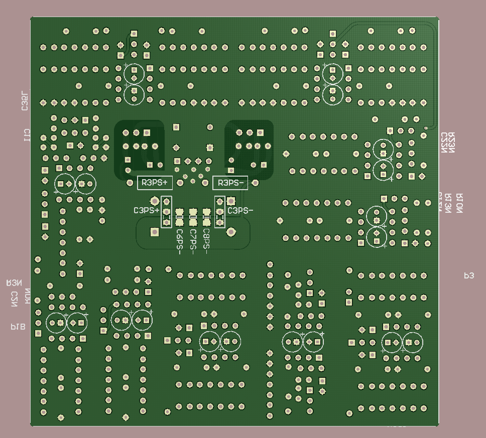

Attached are:
- Top/bottom board views without ground pours (to show the traces on opposite layers).
- Schematics in PDF (please disregard the component values, they are for layout purposes only).
Limitations... - board size, should be 4x4in - hence the tight layout.

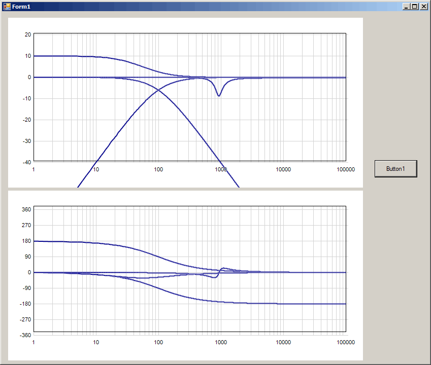

Ok, as promised: The software tool for crossover simulation.
Just a screenshot...
What was done:
- Calculated transfer functions for HP, LP, Bafflestep, Notch for the circuits i have. Each trandfer functions receives a R,C,f parameters as input and returns a magnitude for particular combination of resistors, caps and frequency, in complex way.
- Made some kind of "platform" for transfer function analysis - graphing, frequency sweep, layered display of graphs.
To do:
- Calculate a phase transfer function.
- Add some controls! Changing Q, F, depth e.t.c for filters > calculation of actual R,C values > Simulation.
- Chaining functions. Probably by complex multiplication, and then plotting as it was single function.
- Frequency response loading. That will be a hard thing to do. I'd like to split it into 2 steps:
- - Graphical graph loading and analysis - datasheet graphs could be used, as well as any other.
- - Data import from major measurement programs (LEAP, ARTA, LspCAD etc).
- Phase, phase phase. I have to think what to do with it... Importing the phase graphs of measured speakers should be nice, and alteration of the graph based on phase filter response - even better.

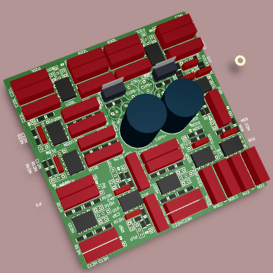

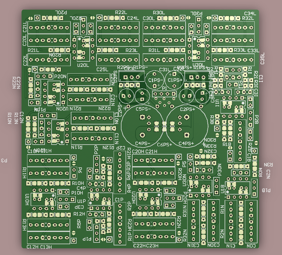

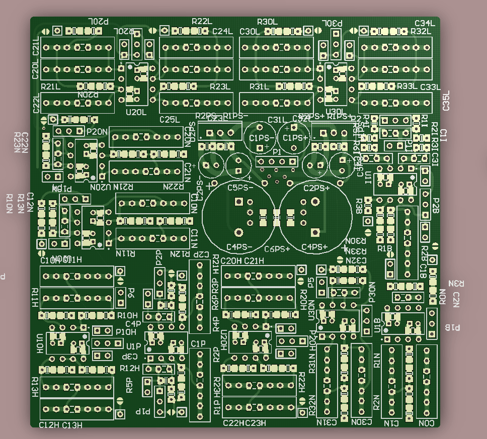

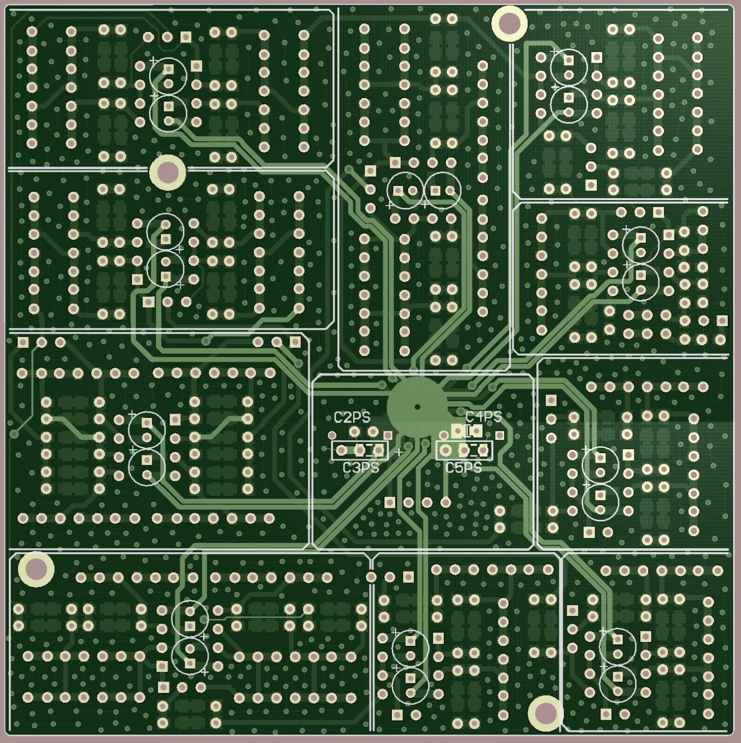

Some updates...
- Parametric EQs instead of notches
- Ballanced/regular input
- Ability to reroute the sections as you wish
- Jumper for 3-way/2-way operation
- Built-in traces for default 2-way/3-way configurations
- Onboard PSU with LM337/317 regs, propertly implemented (i hope so), with huge caps on output (can accomodate 10,000uf caps).
- Redesigned the whole layout of everything
- Had to go back to 2 SMT resistors instead of 4 in configurable places - still, you can stack-up the SMT resistors to get the right resistance.
- The "global" EQ with reroutinc could be used as fourth EQ at output...
That gives us ability to make... well, 5-way crossover 🙂
- I like the Altium's feature of "rounded" traces - they look way better on PCB.

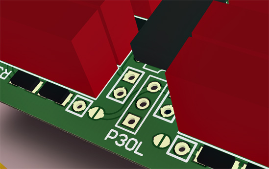

Drawbacks... Well, i can't find a place to put the mounting holes... 🙁

Your approach shows a lot of potential. Here are some comments:
1. Power supply - I am not sure why you have such large caps on the output of the regulators. When the board is powered down, the supply side voltage will collapse before the caps on the output drain, so you will need to use the protection diodes as shown in the LM317 datasheet. If not, you risk damage to the ICs. The DC is already REGULATED. It's not like the caps on a power supply. You only need enough capacitance on the output to stabilize the regulator IC, as little as 10uF. If you use a value under 25uF, you don't need the protection diodes.
Also, you might want to move the voltage regulators to the edge of the board and allow room for the addition of a heat sink to each.
2. It's nice that you included a delay stage. Unfortunately, a single first order section for delay is extremely limited in what it can do. What is really needed is flat delay throughout the crossover region, especially above the crossover frequency. Typically you need multiple second order stages to accomplish this except for the lowest crossover frequencies, because the amount of delay that you can achieve by a single stage for all-pass corner frequencies of a couple of kHz (this is minimum) is too small. Can you make it possible to use multiple all-pass stages?
3. Will the board come assembled? If not, I think that the SMD resistors (and there seems to be a lot of them) are difficult for a DIYer to solder on without some advanced tools/skills. If the board is pre-assembled, how does one change the crossover frequencies and other components/parameters?
4. Without mounting holes, and with components right up to the edge all around, how would one actually mount/use the board? It can't just hover in place! 😉
-Charlie
Thanks for feedback!
1. the "huge" caps are there for a reason. I've used a resistor in series with regulator to detach it's output from the board's supply.
Here is why:
- Regulators don't like big caps on their outputs
- Output impedance of refulator is curvy, frequency dependant...
- The regulator has slow reaction to voltage surges at input, therefore it's PSRR/rejection worsens as the frequency of noise at it's input rises. The C-R-C filter on reg's output cuts all the noise that have passed the regulator.
The regs are there to "charge" the large caps with constant voltage.
The "bypass" resistor should limit reverse current flowing thru regulator backwards on shutdown... but i'll add the diodes too, there is a space for them.
2. I agree on this point. The problem is board space, there isn't much space to put 8 stages (4 opamps) (which are sufficient for regular filter instances for correction of woofer-midrange offset).
The way i think of it is
- the All-pass section can be tuned low, and therefore give a larger delay, but gonna add some phase shift in driver's passband. The all-pass filters are there to fine-tune the phase alignment of drivers in both physical and electonic phase response. They couldn't be coherent, but their phase should match around crossover frequency to give a nice "null" on frequency resonse when one of the drivers is being connected in reverse polarity.
I need to investigate this theory in advance... 🙂
3. No, the board will be "bare". If you look closely, all the SMT components have "advanced" footprints which have regular thru-hole pads too. It's up to you to decide which components you'll use.
4. Yeah... i know... it's bad... but these holes are almost 8mm in size! As much as single opamp 🙂 I'll search the way to squeeze them. at least 3 in count...
I'm limited in board size, as i want them cheap, and there is limit 100x100mm for each board in company i plan to order from.
There are electrolytic power supply caps under each opamp - you could use them as "standoffs" 🙂
Ah, about the heatsink space and placement of PSU at the edge.
When i put the PSU in center, i get short and equal lengh traces to all of the components, and as a plus - the "star" topology power supply, where is no interference between power supply traces of each opamp. I think it is a good decision 🙂
Even the star ground is possible, but i doubt it will be better than double-sided pours. I can slice the layers to create it.
I'm interested to know what selections of SMD resistors you're designing around. In my research there only seems to be one type of thin film commonly around that is actually economical to use but it's not stackable.
I suppose they're not that expensive if I can put together a bulk order with other items.
