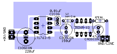

schematics
I've been away for two days.
Guido, Do you mean something like this:

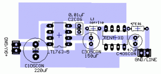

That's what I call a short circuit ! Please have a closer look at the PCB and you'll see what I mean. Pins 8 and 4 ( 5V and GND ) are shorted. The layout in post 11 was better except for the location of the 47 uF OSCON.
I advise a separate supply/transformer with any clock to avoid ground loops. When a separate supply is used there simply can't be a loop because you only connect ground at the ground of the cdplayers pcb ( at just one point ).
When an internal supply is used there is a possibility that the ground via the clock board will be a lower impedance "bypass" of the ground path of the cdplayer ( as experienced by me with various Philips cdplayers ). That can have nasty side effects like hearing the drawer/tray motor over your speakers, intermediate humm/noise that's hard to trace etc. Besides that the clock can cause stray RF that causes the supply to become "dirty". Measurements confirmed this. I don't comment on sonical differences. A ground loop is a ground loop, add the RF to it and that's enough for me. I did not like the 3-wire technique ( sharing the output and power ground over 1 wire ) as used by some clock manufacturers although it does not have the disadvantage of a ground loop.
When a separate supply is not possible please only use the raw digital supply as suggested. The analog and servo supplies have a hard time already... Take your time and make a drawing of how you want to wire the new clock. Ground is again the keyword here. Shielding of the clock is not a luxury and using shielded cable is a pre. Some turns of the output coax through a ferrite core avoids RF to wander across the shield of your cables.
