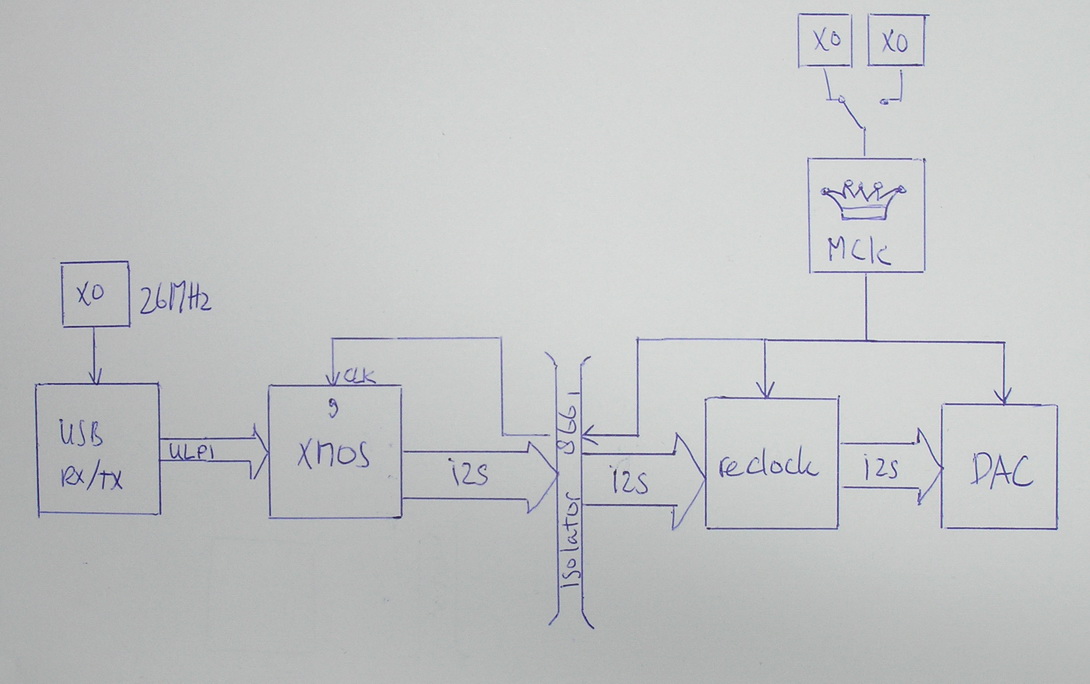

The real-time, synchronously operating nature of the XMOS architecture isn't fully utilized for reliable audio processing by using the 26 MHz reference clock IMO.
As explained in my previous post the audio MCK, being referred to as 'application clock' in the second document, is sampled using the XCore clock of the device. By being derived of / locked to the 26MHz clock, the XCore clock isn't closely related to the audio clock.

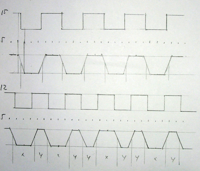

What this means in terms of timing I tried to illustrate in first picture. The top 2 signals shows the sampling of a clock signal with a rate exactly 3 times (for XMOS 1 bit port the number would be ~20 times). Although the edge is not as steep as the original, timing is still in tact because a slaved device is edge driven. The 2 signals at the bottom show sampling a non-related clock. The slaved device still being edge driven, will be subject to a deteriorated clock.
Conclusion would be that clock phase isn't a problem, as long as both clocks are related integrity is preserved. To describe this relation: Both the sampled and the sampling clock should have the same highest prime number divider in common. For 22.579 MHz audio clock prime numbers are 2,3,5,7, for 24.576 MHz audio clock 2,3,5 , for 26.0 MHz clock this is 2,5,13. (so XCore frequency can't be generated with higher prime number division than highest prime of respective audio clock either, the number 5)
IMO best would be to slave the XMOS device to the master audio clock, just like the reclocker and DAC. This way the XMOS reference clock is related to the audio clock, and can either be used directly to generate i2s in the audio driver thread, or to acquire the audio clock like the current procedure. Experiments should decide what's best.
As a bonus the PLL of the device will reject the added jitter to the audio clock by the isolator (provided the PLL_AVDD pin is powered separately). Switching back and forth to both clock families would also mean the XMOS device / PLL need to be reset to the new clock, complicating switching a bit, but I expect that shouldn't be a problem. Further on, the reclocker will correct the jitter added to the i2s and sp/dif by the isolator, just as joro intended.
The USB transciever is still clocked by the 26MHz clock. The incoming ULPI will be sampled by the XMOS device on 8 bit port, with the same effect as described. But this time the effect isn't a problem, because at this stage of the transmission it's about data, not timed data; Here jitter of this level isn't a problem for data integrity.

Sorry, I messed up with the prime numbers. In order to have an accurate sampling of the incoming audio clock, the sampling frequency must be an integer multiplication of that clock frequency number.
For 22.5792 MHz this would be a factor 22 (496.7424 MHz XCore) and for 24.5760 MHz this would be a factor 20 (491.5200 MHz XCore).

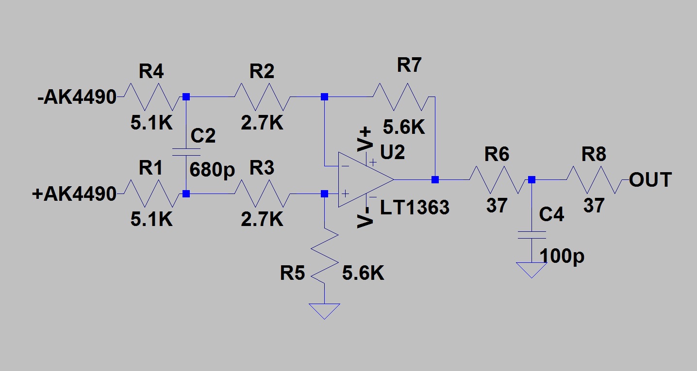

You published output schematic that suits best for you. I have made some other things in last time but yesterday when I look clossely to both boards ...dac and output board, you just published schematic and put filter simulation for output board...but i see that on dac board it is first part of filter ...5100R and unknown capacitor then goes to output board wih your schematic...so it is 3rd order filter not 2nd order....am I wrong?

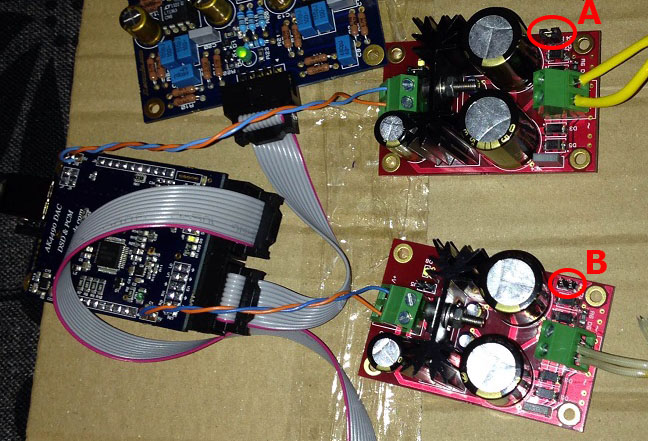

I am a beginner DIYer. I'm riding the combo I2S over AK4490 + USB + 49710 LME.
I think I need help
I looked assembly, and I saw:
The A 5V board has the jumpers installed
The B 5V board does'nt have the jumpers installed
Is correct?
Why ? (Both entries of AK44490 board have written same voltage: 5V)
Thanks!
Thank you. So in original sheme 3rd order.
What was the influence in sound when you start to remove capacitors...?
That's wright.. but first filter on AK4490 board is very high..
I only remove 150p capacitor from original schematic, I think that kind of filter slowing down opamp..
