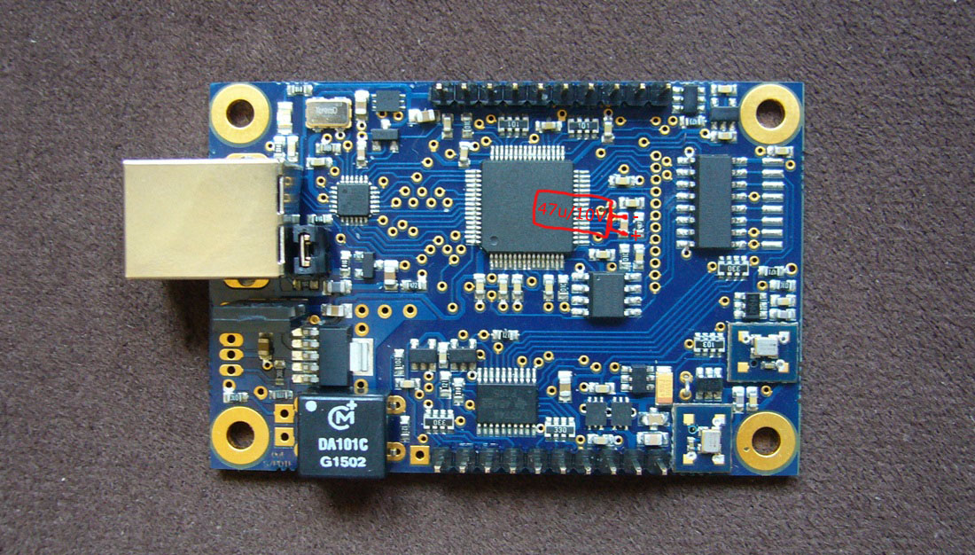

Why I think reclocker isn't effective
I like the concept of reclocking the i2s output from the XMOS after galvanic isolating it. But it doesn't work in this design unfortunately.

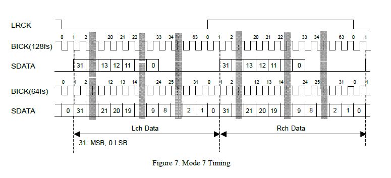

[see picture]
By reclocking (basically: sampling) the signal with the MCLK or 2* MCLK delivered by the clocks, the maximum jitter/timing error of the i2s from XMOS to be corrected by reclocking would be one master clock cycle. In our case of 45.1584/49.1520 MHz this would be 22/20 ns. While oscillator jitter is mostly specified in the order of pico seconds, one would assume that reclocking would be very effective if the jitter of XMOS+isolator stays below 20 ns.
But what if it doesn't? What if the variation of the XMOS signal's clocking is bigger than 1 reclock cycle? For bitclock and data lines this won't be a problem, data will be clocked in by DAC still on time, but for LR clock an error of 20 ns means that the next sample is delayed, very bad for Sound Quality.
Because the I2SoverUSB board isn´t immune to transport (different pc or USB cable), as was already argued by SoundCheck, I was wondering why the reclocker didn't solve this, and studied datasheet of XMOS. The XMOS chip clocks are derived from an internal PLL which is supplied with 1V on its own PLL_AVDD pin. In this design this pin is attached to VDD via an RC-filter network. Because PLL is voltage controlled, it's supply has to be stable and noise free, which is not the case when tied to VDD, regardless how good your main supply of the board is and/or local decoupling of the VDD supply pins. Better would be to have a separate supply of PLL_AVDD.
So I decided that the PLL psu needed improvement, and attached (temporary, using hot glue!) a rather big electrolytic of 100u/16V across the SMD cap of the RC filter.
Simply by adding this capacitor I made this USB interface a lot better, I didn't think my setup could sound that good! Now this USB interface really stands out. This also means IMO that there's a big weakness in the current design of the I2SoverUSB board, which should be addressed in future revisions.
[I'm using the I2SoverUSB board with i2s output attached via short ribbon cable to dual AKM AK4399 DAC, using two separate very low noise power supplies for XMOS and reclocker.]
Actually this mod didn't reduce dependency on transport, but it certainly did improve sound, just try it yourself! Any comments welcome.

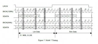

[see picture]

Your picture has different cap value than what you specified in your text... Which one is the one you currently use?
Do
I don't have the proper equipment to do these measurements. But improvement is so obvious, I don't think figures are needed to prove the better performance, though measurements would be nice to verify my theory...
It's a small mod, just give it a try, only if you want of course 🙂
