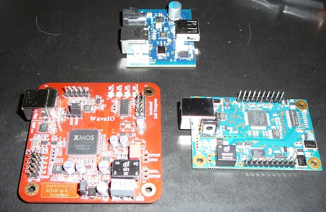

Has anyone compared that converter to WaveIO made by Lucian? .... Im asking because I feel Lucian board looks more "professional" to me.
Spoken like a true diyAudiophile. Even though Joro's board has better specs in every category, Lucian's board has gold plated traces. Bling aways wins.
Actually, both boards have their pluses and minuses. I have both, and there are things that could be improved with both. But the JL Sounds board is quite good. I do wish that when feeding an external clock that it would go through the isolator. I think he ran out of isolator channels. Also, am not terribly fond of the SiliconLabs RF transmitter/receiver style isolators he uses. The have about 3.5 times more jitter than the NVE GMRs.
But at least Joro put them on the right side of the clocks! (That is a big fail on the WaveIO, and may be the reason I prefer the un-isolated output of Lucian's board.)
the output pins arrengement seems better on the Wave board : GSGSGSGS nothe SSSSG of the Joro's (would try if only !). Alqo better ndk clocks on the wave I/O!
What a pity Joro does not fix this output with a more serious layout here with ufls or a plug with a gnd return path for each I2S signal ! I asked last summer... but had just an answer about the clock board 🙁. So not easy to use with two multibit dac chips because the interlink missing quality (imho)

I have a licensed XMOS driver - it's free for downloading. Of course the author rights for this driver belongs to XMOS, I just represent the driver according to the conditions from XMOS.

There is an OEM board with GSGSGSGS pinout. This board is for people like you, who wants to build all around the I2Soutput according to your own visions 🙂What a pity Joro does not fix this output with a more serious layout

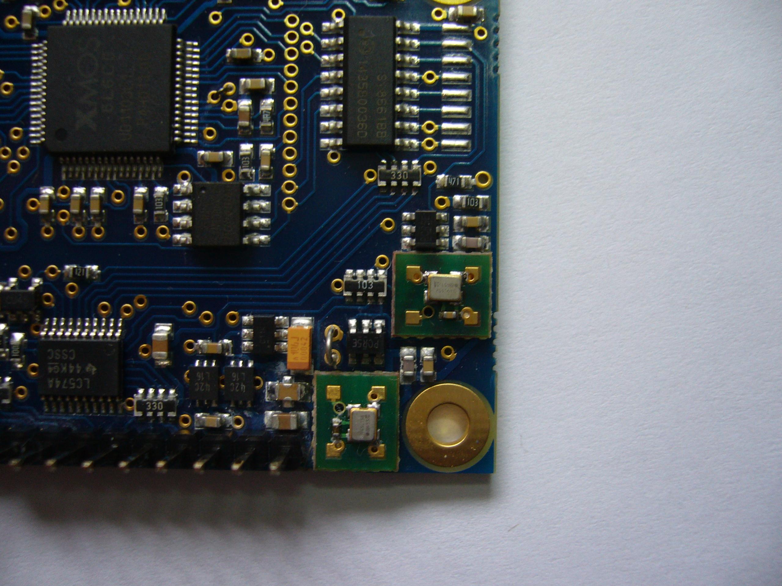

Hi Joro,On the last batch of boards there are NDK NZ2520SD 45.158MHz and 49.152MHz oscillators.
Can you post the instruction of how to accomodate NDKs to older boards.
Also, can we purchase these tiny pcbs?

As I mentioned the boards are equipped with NDK oscillators (the waiting was long). Regarding GSGSGSGS you are correct, in terms of EMS, this kind of interface is better, but in terms of jitter according to me – no. The GSGSGSGS increases the capacity of the signal wire (almost double), this leads to slant fronts of the signal, which is precondition for bigger jitter in consequence of the non avoidable noises in the system. In many of the top players made in the beginning of 90s the GSGSGSGS is not applied, but this doesn’t stop them to play gorgeous. For example you can check the service manual of AKAI CD93, which was referent for a quite long time. Why is that? – the audio transfer on I2S and the transfer to the DACs work synchronous, as on falling edge the info is switched, i.e. the noise common form every bus is on the same moment and does not interfere the fronts of the signals next to it, that’s why the above player and many other plays good.

Yes, of course. I’ll need some time to make a tutorial.
The boards will be free of charge for people already has the XMOS board, there is an option the oscillators to be soldered on the boards (this also will be free of charge).
