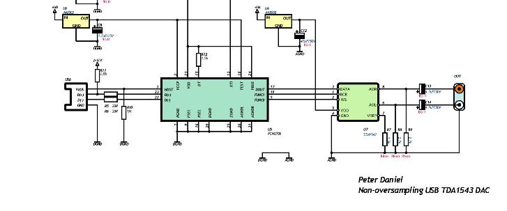

Yes precisely! It would also work for TDA1543. In my case, I started with a Peter Daniel 1543 DAC. He does very nice minimalist designs using good parts and careful placement. His design takes I2S right from PCM2706. No resistors flip flops .. nada. See pic. He takes care to have very short signal paths. His clock is right on the pin of the 1543 and 2706 to 1543 is a few mm.
I was building a DAC starting with audio bd from an ARCAM Alpha. It used resistors to attenuate I2S. I tried taking I2S direct from Peter's 2706 to the 1541a, and presto worked like a charm. While both are good, I prefer the 1541a, and for the next 2 years, I used Peter's DAC to generate the I2S into my 1541a. Just used very short (3") teflon CAT5 to take the signal. Frankly, even with this length, the 1541a beat the 1543 design. The 6n2p tube output vs BG N caps on output might be a factor. Point is a few inches of CAT5 for I2S did not mess it up.
Now I have replaced the Peter Daniel converter with WaveIO. I am using 3 mBNC connectors that I took from digital cellular devices. These were put in long (6") to test and work fine. Soldered directly to the pins of the 1541a. I will trim these down to minimum length just on general principals.
I have no doubt that guys like ECDESIGN are building more resolved version of the 1541a. I do use DEM reclocking from his site but again, no flip flop. I take the WS signal at 44.1kHz. It is lower than optimal but light years ahead of the stock 470pF cap done spec'd by Phillips. I am going to play around with using the clock feeds from Lucien's board (88.2) to double the speed of the DEM signal without messing with more components. But that is in the future, as I am pretty happy with this initial setup.

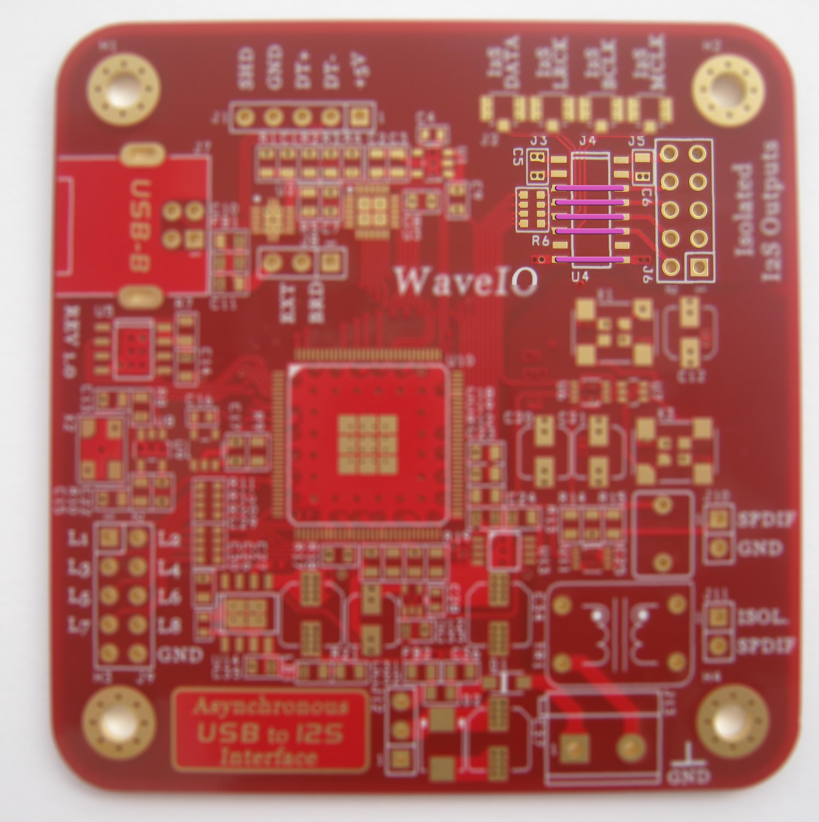

Hello Albert, I can not make any changes to actual PCB and to look at least aesthetically pleasing to the eye. But, few DIY "adaptation" can be done to it:
if you want free holes into which you can solder wires and don't want to use the mBNC coaxial connectors then I could leave the NVE's isolator chip and 10-pin headers unmounted and with few wires your request can be fulfilled. The isolator chip and pinheader wil be at your disposal when want to reverse this operation. Please see the picture below for details:

I'll be very happy with the isolated output. Isolating serves an important function. I thought the I2S output passed a D/A chip. 😱 - but it just passes through the isolator.
