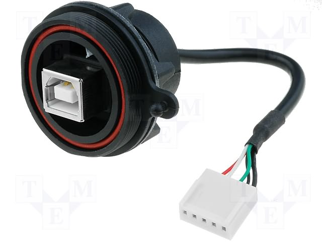

Thanks all for the feed back. I realize one layer of error I made. I was setting the wrong jumper (USB). With the correct jumper set to EXT and 4.9 volts of power, I get a steady light on the LED, but the PC will not recognize the WaveIO board. I go back to power from the USB, and it springs to life. I tried a different copy of the OS and installed drivers from scratch, but the card was not seen and driver install was stalled.
Any ideas what I am doing wrong? I just want to minimize the power load in the PC and to supply clean power to WaveIO.

Hello Walter,
make sure that J8 jumper is set on the BRD side all the time! That jumper is used only to switch between on-board (BRD) USB-B connector and EXTernal USB signals available on J1 pin-header for cables like the one in the attached image. In your case, J12 must be placed on EXT option to be able to power up WaveIO using external sources.
Hope it helps,
L
