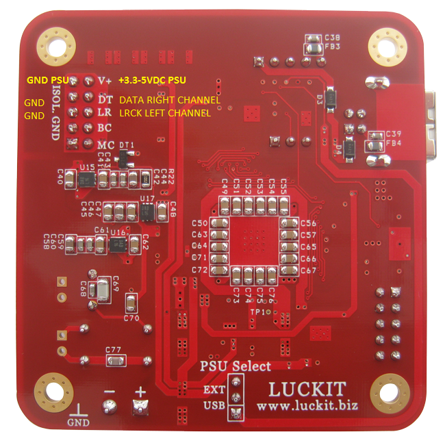

I don't have a great knowledge of electronics, so when I first wired up the isolated
outputs, I was a bit confused about how to wire the leads on it. You are probably better
at this than me, but just in case. You do have the + psu lead going to the V+ pin, and the
V- lead going to the pin directly opposite the +V pin on the isolated ground side don't you?
And then earth leads from the isolated ground side connected to the board you are also sending
the DT/LR/BC signals to. Mine is wired like this and it plays back DSD 256 very well.

Hi Simon,
Yes I wired like attached picture, of course not the same PSU powering the WaveIO ext. USB
N.B. Bit Clock isn't necessary for SE low pass filter DSD no DAC
Felipe

Today my external PSU LDO regulator failed in very ugly way and let around 10V to the output pin so waveio was exposed to it around 15 minutes.
Protection diode D2 burned but luckily waveio survived, after removing diode it was able to play music by using USB power.
Lorien, kudos for designing such a robustness!
@ ljufa: thank you for kind words! Just remember to replace the protection diode with the same type so it can be able to keep away your WaveIO from any troubles it might come form your external PSU.
As for DSD, I can confirm that WaveIO is playing DSD from here too. A friend of mine managed to ran few tests with positive results and now I'm waiting for lintweaker to do appropriate changes.
