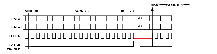

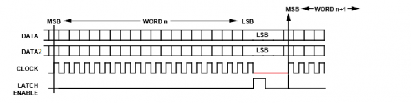

Example:
(note: 20 bit AD1862/PCM63/PCM1702: only 19 internal shift registers, not 20!)
