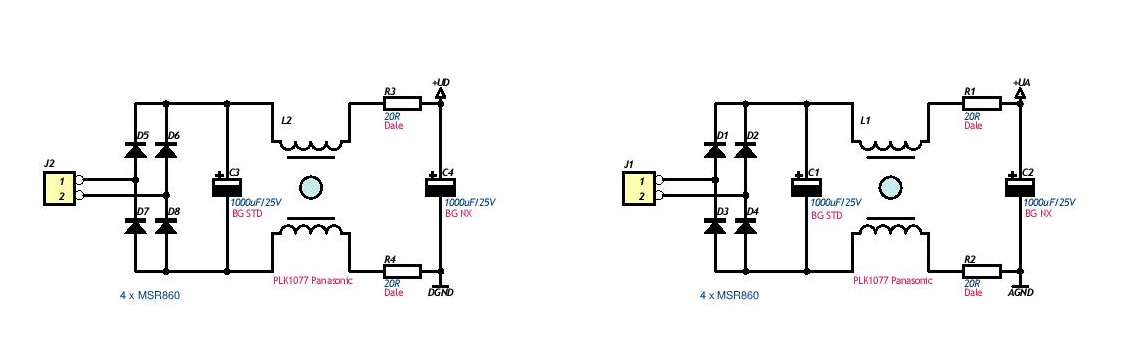

In this supply I used 70R 1/2W PRP resistor. Looking back at it, I realize it is only CRC. I may go back and try it with CRCRC or even CLCRC with a filament choke. I did this on the +15v supply to the 1541a with good results. Thanks for causing me to look closer. 🙂
I pretty much used what I had on hand. A good engineer would have done all the math and simulations so I will not be offended if others chime in to suggest an alternate approach. I kept in mind the advice from ECDESIGNS to keep transformer small. I used a small 6VA Hammond 229 here wired for 12v output. I had to balance keep resistor small to still get enough current to drive the Salas shunt.

What R values did you choose in your CRCRC . . .
Can't speak for Walter but I usually use 0R5 or 1R0. WWs are ideal.

Thanks for this add. I think I will keep playing around with this. On the WaveIO 5V PS, I too went CLC repurposing a Peter Daniel supply. It did have a very noticible improvement over a simpler linear supply that used a standard bridge and CRC.
This one just supplies the 5V to the WaveIO isolator. I think it is time to try a choke. Had really good success with choke on the +15V supply inspired by the DDDAC thread.

Hi Wlowes, I would look at a bit more capacitance. This was designed for 50mA or so draw. your load peaks at nearly 10 times that.
Thanks Luke, right you are.
I did rebuild it with different caps & resistors to accommodate the 10x current. I am still tinkering with all of the supplies to the WaveIO and 1541a and having good results with clclcl.. filters employing 12mh high current inductors and large # of Panasonic FC 1800uf caps. I'll post findings when done.

I will order some common mode chokes for mine as well.
Did you not use regulators on your tda1541? I remember someone on the forums saying they preferred clc and no reg.
I use salas shunts on 1541a and on waveio isolator. Did not want to risk the 1541a chip.
actually using fixed radial lead inductors inspired by ecdesigns PS. Found them at surplus but similar to digi part 445-3823-ND. well worth the extra space and effort.
