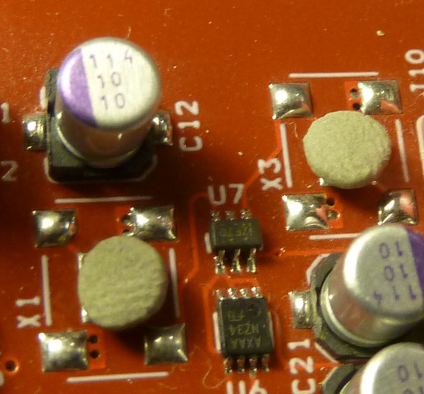

A tweak that takes WaveIO up a notch
I confess, I am a Blackgate capacitor junky. That confession aside, I have long wondered if my BG addiction would play with Lorien's excellent WaveIO.
No longer a curiosity. To satisfy the itch, I soldered a 4.7u Blackgate N to pin 4 of X1 clock. (actually to the + side of the OSON feeding X1). For convenience I took ground back to the ground pin at the SPDIF test pad. This also done in parallel with vibration dampening by placing mounting putty directly on the clocks. Solder cap then squash a round ball of putty onto the clock and surrounding real estate. This alone does bring out more detail and bass but bleeding together. The BG cap just explodes the whole thing sharply into 3d.
OMG! Game changer. Massive jump in holographic presentation. Tight bass cranked up. Even high end extension.
If you have one of these somewhere, rip it out and try it here. If you can find one. buy it. This just allows WaveIO to continue to show what it is capable of.
I don't have any BGs to hand but I did try just covering the clock with a blob of BlueTak. You're right - it makes for a significant SQ improvement: sharper, better focussed.
Of course, the sensitivity of X-tals to vibration is not news. Another tip in like vein is to wrap a few turns of PTFE tape round the PCB's mounting pillars. (I'm reliably told that PTFE is used widely in aircraft electronics for vibration control.) If you can get the thicker, yellow-labelled tape graded for gas pipes, it's easier to work with but the thinner plumber's grade is fine too. As suggested by someone on AA's Tweakers' Asylum, try also wrapping some round the connectors on USB and similar cables. Neither tweak makes for a huge, night-and-day change but they're perceptible and not what you'd call expensive.
One thing that definitely didn't work was "de-coupling" the WaveIO PCB from its mounting pillars with 3mm rubber (Nitrile?) O-Rings sandwiched between brass washers - they made it sound decidely worse. Still, the trial at least convinced me that PCB mounting could be critical.
I've given it a try today with two little blobs of plasticine on X1 and X3.
I got a marked difference, better sound, not a subtle change, more details, better microdynamics, firmer in the low end, more things at the right place at the right time. It seems to sound louder as it always I experienced when a tweak or a change makes the sound better.
I'll give a try to the standoff tweak as well. I had interesting experience in the past with shigaclone comparing 4 to 3 to 2 to 1 standoff (2 in diagonal without rubber damper was the best).
+1 with Blu-Tak. It's incredible but true.I've given it a try today with two little blobs of plasticine on X1 and X3.

Those clocks are sensitive to temperature changes and adding this on top most probably acts as a insulator, keeping the crystal at a constant temperature. OCXO are doing this natively with built in heater, but very expensive!

Massimo, you are so neat.
I should have posted a pic. My blob covers the entire area of you photo! Right over the Oscon caps and all. 🙂
I wondered if the insulation would tend to heat the chip and thus degrade its performance rather than improve it though I have been running all day without apparent ill effect. Tomorrow is, of course, another day. Whatever, Bluetak and the rest are known to be good for vibration control.. . . adding this on top most probably acts as a insulator, keeping the crystal at a constant temperature.
I did the same. Knead, Knead, Knead . . . Plonk! Ditto BTW round the USB socket.. . . My blob covers the entire area of you photo! Right over the Oscon caps and all. 🙂

In my wave I/O i have the very little NDK XOS : do I need blue tack here also or just only for the biggest XO near the entry PS plug ? Not problem of cooling if the can is Blue tacked ?

I leave my WaveIO powered 7/24. No apparent heat issues. I doubt the clocks draw enough power to generate many btu. If anything stable temp likely a good thing.
Eldam, for what it is worth, I also power my Ian I2S-PCM card with same supply as the WaveIO isolator. In my case I use a salas shunt after a pretty well filtered linear PS. Perhaps a small inductor before each would cut down noise from one to the other.
I put my clay on the 2 NDK clocks. (in my case FOX). I think this would be the primary benefit. I did not think about the clock that supplies the XMOS processor. Good idea.

OK. I added a blob of clay to the 3rd clock as Eldam suggests, and then around the usb connection. Definitely worth the add.
Also devised a way to clearly see the impact. Fist listen to a well recorded track with lots of micro detail. Turn the volume down to the point where the sound degrades. There is always a point when the dynamics and bass thin out and the system is sub par. Then add the clay ball. You will notice the sound floor has dropped and the sound is now full albeit at a very low volume. Then return to normal listening level and enjoy.
