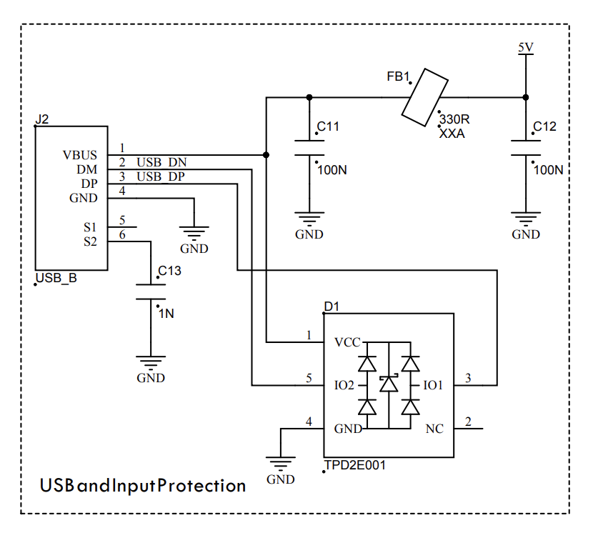

Does anyone have any more info on XMOS issues with ESD, I have two DACs with older XMOS chips (ifi & minidsp) that aren't working. I assume the ESD death symptom is that the device just isn't detected?
I was searching through threads and I can see many references to ESD issues with XMOS boards, statements like:
"these are very fragile devices"
"I have broken 2 ... with seemingly no cause"
"take precautions for static... not taking a single chance"
"I will add ESD diodes to the USB port"
"never hot-plug them"
And a link to an advisory: https://www.xmos.ai/download/Design...onnections-for-xCORE-200-USB-devices(2.0).pdf
Thanks.
There is similar on page 19 of the document at: https://www.xmos.com/download/XU208-128-QF48-Datasheet(1.16).pdf ...or search it for the term "esd protection"
This pic is from: https://www.xmos.com/download/XS1-U8A-64-FB96-Datasheet(X6319D).pdf
