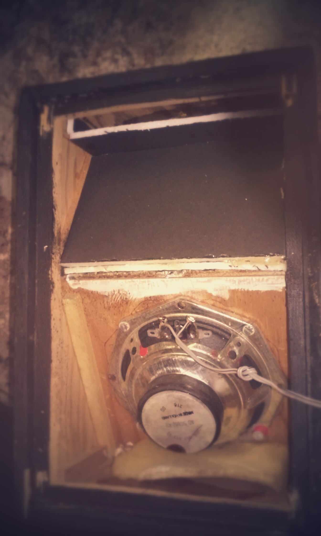

Oh the fun that can be had for a dollar. I picked up a sheet of foam core at Dollar Tree and proceeded to modify what I thought were K4s scaled from a 1955 K12 with shelf. When i got into the project I found that they contained AD5080/X8s which are 5". So my boxes are .42 quasi scaled K12s. I added a duct to the original vent point as suggested in post #7. The only test is a subjective comparison to its unmodified twin. It did improve the sound but I think the 5080s are midrange drivers.

The inside view pic shows duct opening at top rear and the messy area in the middle is where the foam core is caulked to the rear edge of the shelf. It extended too far to miter it to the shelf and I was too anxious to hear it to ponder a solution. I may add a bit of foam core to the rear of the rear of the shelf for number 2. I took the choke strip off the rear panel so I don't think a thickness of foam core there will hurt anything, after all it's a kluge at best.
In the side by side pic the one with the mod is on the left. You can see through the vent to the rear panel in the other one. They are approx 10" tall.
Beauties by no means but will reside in my garage to be heard rather than seen.
