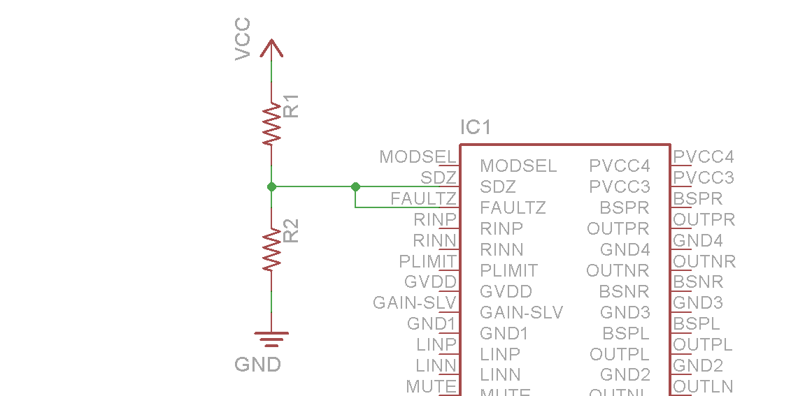

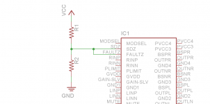

Using the oscilloscope, I found the thump pattern coming off the FAULTZ/SDZ node
(These two pinouts are connected)
This node receives 2.2V from a voltage divider (my supply is 12V)
Please see the attached picture
This same configuration is valid for Both the stereo channel and the sub channel (one TPA3116 for the stereo, and one for the sub)
Now:
I floated this FAULTZ node (don't know why it was connected to a voltage divider source in the first place, since it's an output according to the datasheet)
After floating this FAULTZ, the thump stopped and the stereo music too (muted).
The SUB CONTINUED PLAYING the song perfectly. They are clearly independent, no matter what volume.

Hello LucasBS,
after some experiments my xh-m139 is operable, a solution seems to be possible.
Current status of my experiments:
- The heat sink is removed. -> The PCB is not bended (= reduced mechanical stress) and the capacitive coupling of the two amps is removed. Now the output power is limited by temperature of the chips. I'm looking for a different mechanical solution to fix the heat sink without bending the PCB. If the heat sink is connected to ground the capacitive coupling may be ignored.
- Unused outputs are terminated with a 4R7 power resistor. It should be checked if this is necessary.
- If the amps are connected to a linear regulated laboratory power supply @ 12V operation is o.k., I have tested some different switched mode power supplies to supply the module, some are o.k. some failed. There may be an interference of supply and amps. A decoupling network may solve this challenge but has to be designed and checked.
