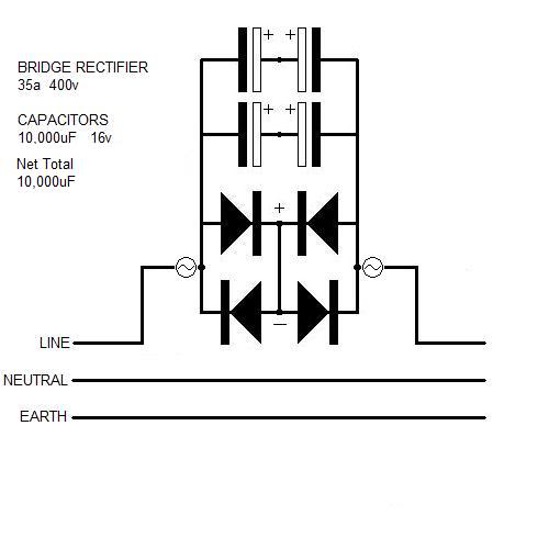

maybe you need DC blocker ........
regarding AC from wall , that's same everywhere - if anything else , having pure AC is a dream
often there is also some DC , riding all around AC , mostly residue from modern switching appliances , refrigerators etc.
if that's the case , toroid trannies will sweat much more then old EI ones .... most probably passing through at least some of that trouble to secondary side
there is no other way to test that then either try to observe mains with scope , measure with DVM ( set to DC) or simply making quick and simple DC blocker (DC block filter) and try with it ( you can make it as mock-up , on wood or plastic platform , as part of short extension cord ; be careful - mains voltage ! ........ if it helps ........ make nice box , with several of these , each feeding one precious apparatus )
look at pic
look at pic

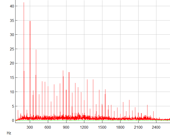

Here's the spectrum of that noise from the midrange section:
Makes sense if your line frequency is 50 Hz in Norway.
What's interesting is that it is barely audible from the woofer section, which I would expect to be strongest around 100 Hz.
I'm doubting any of this is amp related.
Also, based on the clip with the microphone close to the speakers, it doesn't seem terribly bad really, but worth continued experimentation if only for fun and education.
A lovely setup, by the way.
Edit: Do you know the frequency response of your microphone? Just wondering if that's why I can't hear the woofer section.

So, let's say you're getting 54dB from .1 meters away from one speaker, that's 32dB from two speakers at your listening chair, which is just above a whisper as you described. 32dB at your listening chair from 95dB speakers requires about a microwatt from each channel, which would take a couple of millivolts of noise to produce, which more closely matches your description of being tube amp-like. So whatever ground loop or other line related phenomenon is present, it is certainly above the intrinsic noise of the amps themselves. Which just means it's probably worth tracking down.
