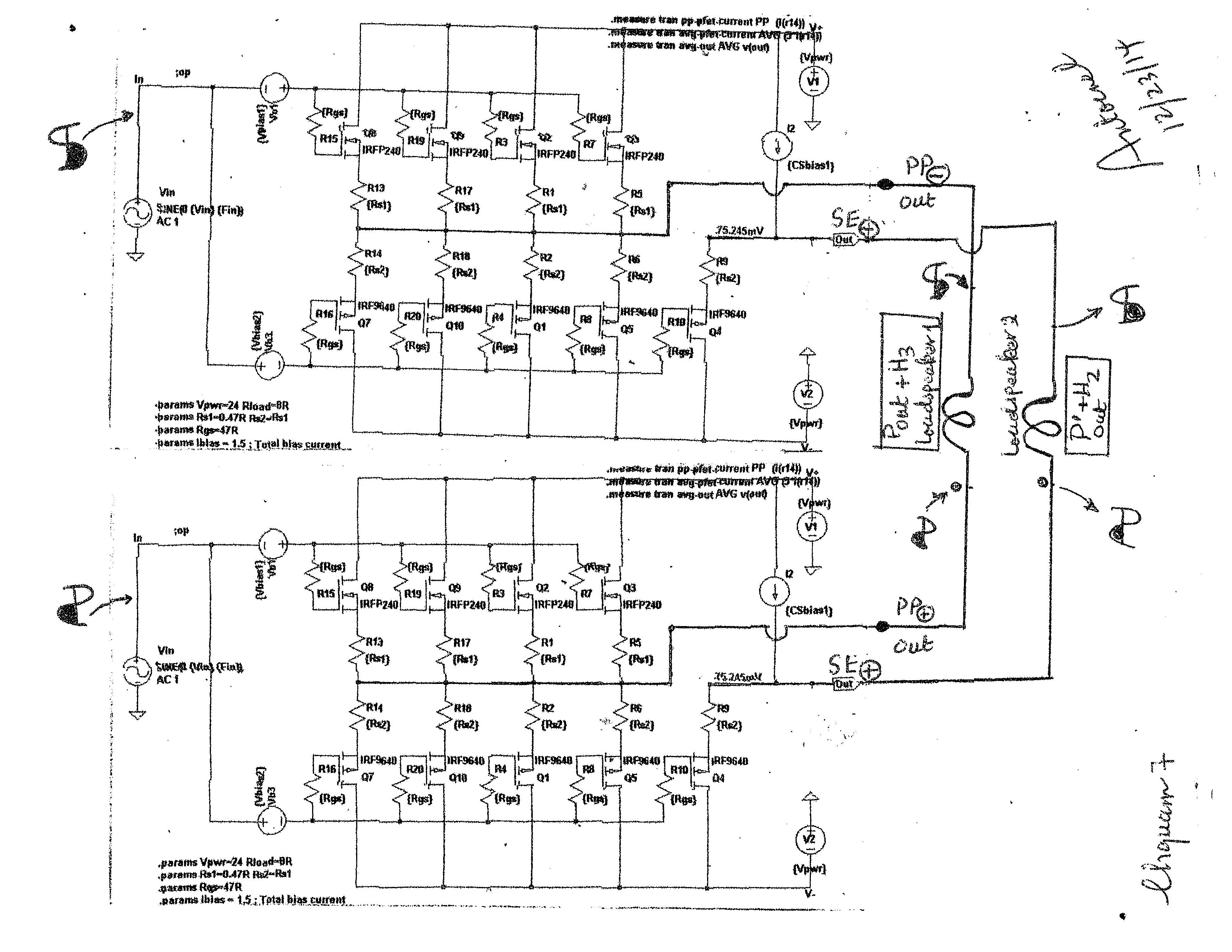

The attached schematic was presented by lhquam in his post #119. It tells this fascinating story:
I wish the issue was as easy as that, but the all 5 FETs on the negative rail are contributing to both the PP and SE behavior as soon as the tops of their source resistors are tied together. However, it is possible to characterize the H2/H3 ratio as a function of:
  • FET device characteristics, primarily Kp and lambda.
  • Source (degeneration) resistance Rs
  • Number of PFETs and NFETs
  • Bias currents
  • SE constant current
The equations are not simple, and are quite difficult to express in closed form. However, the circuit is very simple to describe to SPICE for simulation, assuming you have suitable FET models.

Hello lhquam. Wishful thinking on my part. You have a basis for an interesting and great diyamp. It lends itself to ready experimentation to go along with your simulation; for example by using a dual diyF4 per your post #82. Also, the potential standalone diy "balanced SE amp' in your schematic is already a unique achievement.
In conclusion to my story, a target H2/H3 for this study by lhquam may be like that already determined for diyF6. I've read diyF6 posts by lhquam, generg, Zen Mod, buzzforb, and countless others who have already spent many hours tweaking H2/H3, and may have to continue doing just so for this diyamp using 1K or more hours per posts #71 and 72 by Zen Mod, and generg respectively.
Best regards.

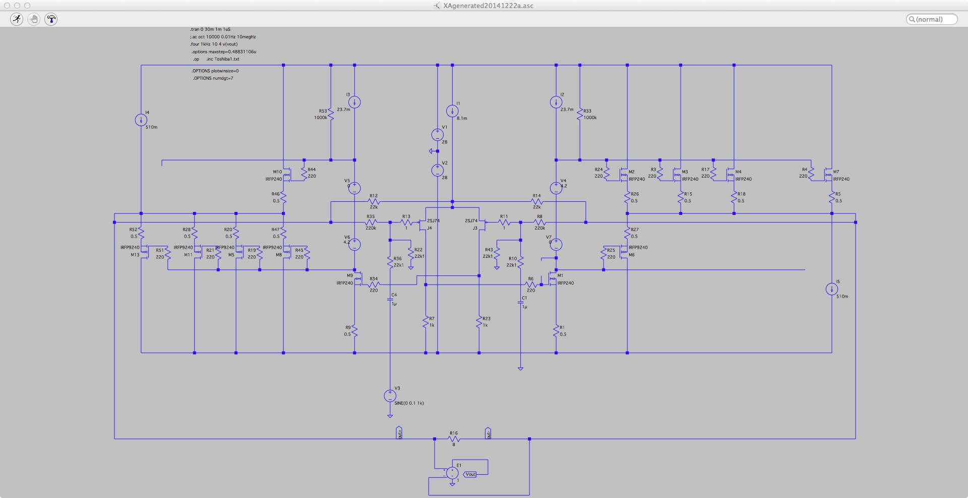

A different angle..
One thing led to another. This maybe a potential approach to manage H2 and H3 plus their magical ratio. The image shows the balanced mixed PP-SE amp which lhquam described; like that depicted in his post#119. There is one important modification therein this schematic to note. The electrical connection between the output of PP was disconnected from that of SE in the top and bottom sub-unit amps. This gives two independent power outputs; a balanced solo PP and a balanced solo SE.
1. The balanced solo PP output [Pout] is connected to Loudspeaker 1 and is enriched with an inherent H3 harmonic of a certain preferred magnitude. H3 may be determined at this Loudspeaker 1.
2. The balanced solo SE output [P'out] is connected to Loudspeaker 2 and is enriched with an inherent H2 harmonic of a certain preferred magnitude. H2 may be determined at this Loudspeaker 2.
3 The magnitude of Pout of balanced PP is greater than P'out of balanced SE; because of the particular [depicted] design of the individual PP and SE amps.
4. Loudspeakers 1 and 2 are independent, matched and are spatial mirror images.
5. Music emanates from each loudspeaker, and mixes the preferred levels of H2 and H3 harmonics [acoustically] in transit to the ears of the listener.
The next post shows Loudspeakers 1 and 2.

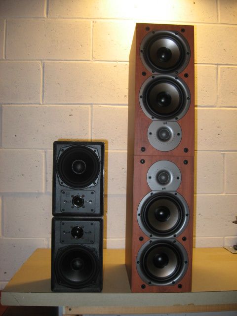

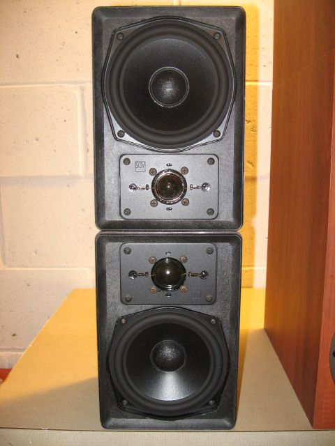

A closeup of an example Loudspeakers 1 and 2 is shown in the left photo. The two A/D/S L300C loudspeakers are independently enclosed, preferably matched in performance, and are positioned on top of each other to be mirror images in the horizontal plane. The right photo is another example showing a pair of Polk Monitor 4B loudspeakers [at hand] next to the pair of L300Cs.
Best regards.

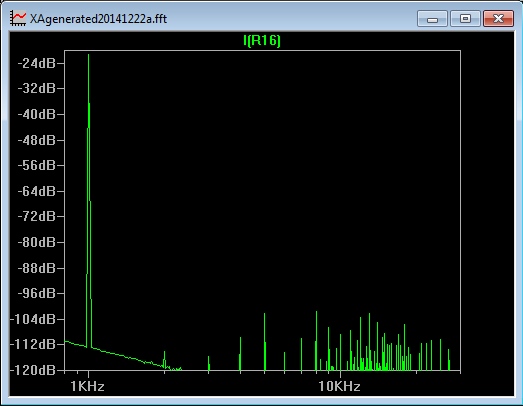

Interestingly the simulations with MOSFETs refuse to behave like predicted in the distortion pattern.
As an example I append two simulations that show the effect. The circuitry with the constant current source working as one half of the push pull stage should generate a lot of second harmonic. In simulation it shows only a tiny little bit.
I will try to find out the reason for the discrepancy, but it will take some time.

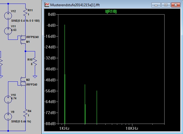

It seems to be a good idea to make the push and pull output stages easy reconfigurable so that you can change by a jumper the way every transistors works:
Interestingly, I have observed the same behavior and have not figured out what is going on. I would expect the anti-phase single-ended stages to sum K2 rather than cancel. It would be nice to understand this behavior before building boards.

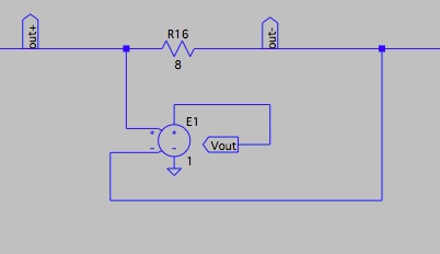

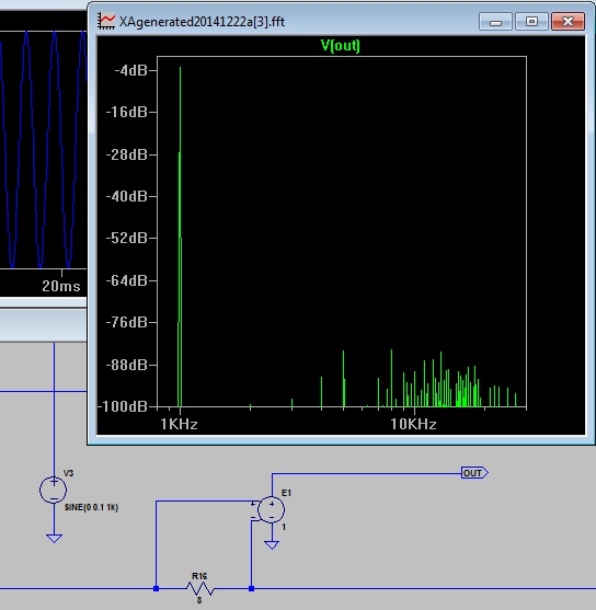

Capacitors (and inductors) can cause problems in the simulation. When I changed the input capacitors to 1000uf (totally unreasonable, but makes the simulation work better), the spectra are much more revealing. The other thing I would change in your simulation is to run it at higher input voltages, like 0.4V. The circuit as presented will not produce more than about 1 watt output before entering Class-AB.
Hello lhquam,
in my last post (with the addition of E1) I changed both input capacitors to 1000µF. The input voltage of 0.1V causes an output swing that is clearly in the class A region. Because this circuitry was intended as a study, the restriction to 1 Watt class A output power is not a problem.
When simulation works as expected, it makes sense to me to change the values to be appropriate for a real amplifier.
One more:
I changed the output transistors of the push and pull stage in circuitry 11 (Q4 and Q5) to MOSFETs IRFP240 and IRFP9240 and tuned the voltages to get the same currents. The distortion spectrum with that is not as expected. It shows a lot of second harmonic. So the MOSFET models do not behave as expected.

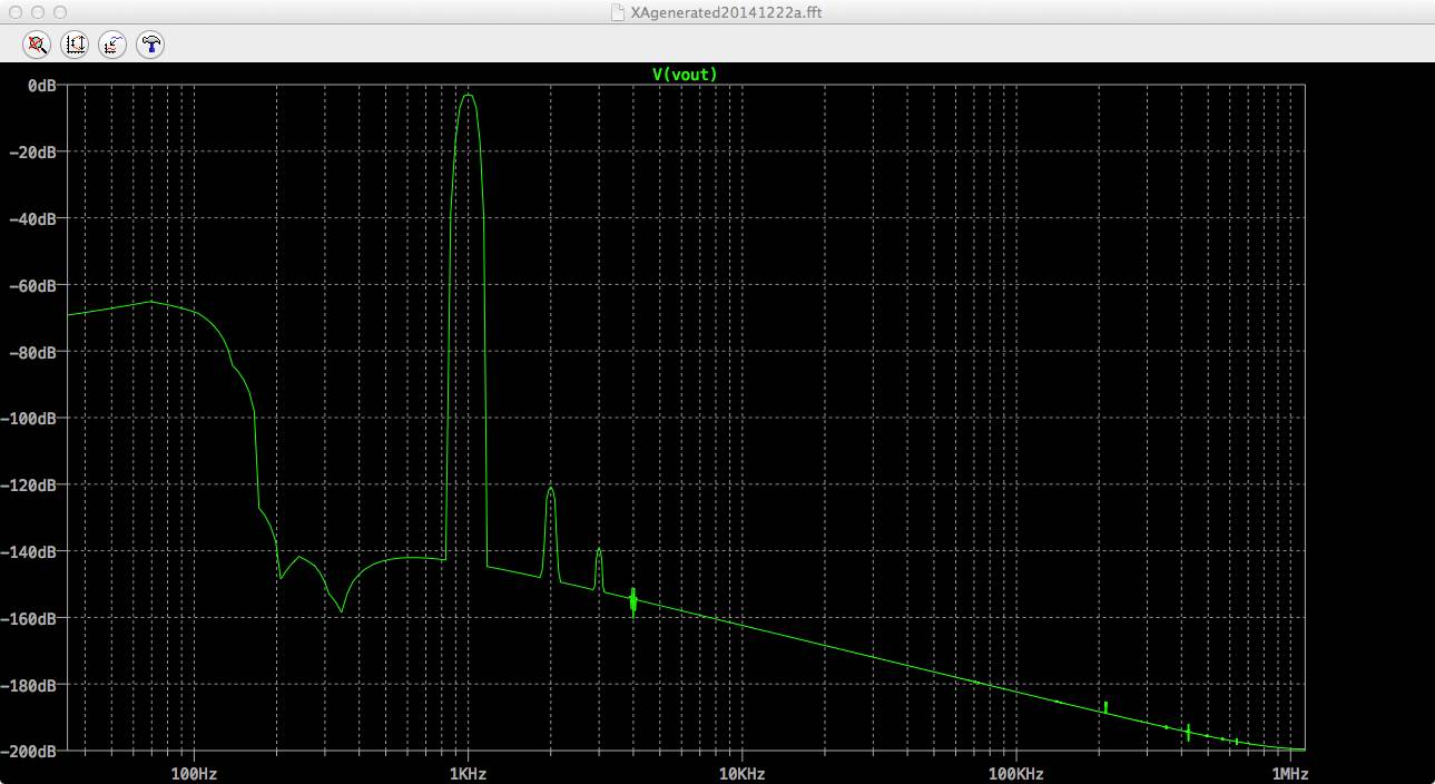

Hello generg,
with your addition of E1 voltage source I get the following.
Did you change anything besides that in your simulation file?

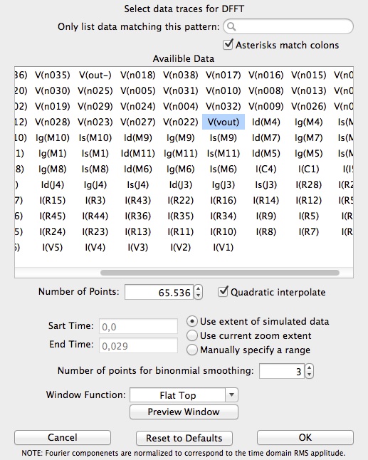

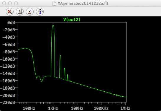

o.k. pr,
- here you can see your circuit and my changes only the E1 voltage
- my set of Spice directives
- my distortion results
and now?
keep in mind I am just a beginner in Spice….
the real Spice master is lhquam…. 🙂

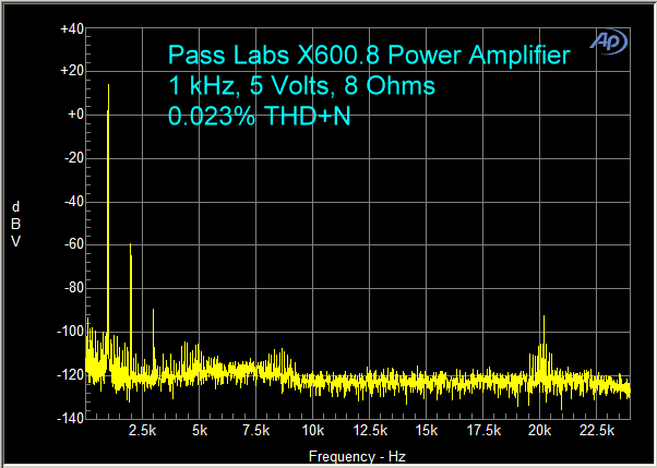

there is a review of the X600.8 with this picture…..the reviewer writes that the distortion is mostly the noise he had in his setting and he calculated the real distortion much lower…
you can find it at Pass Labs homepage new awards….. it is very interesting to read!
Where can I find the review? The THD seems rather high for 5V output, which is only 3.125W if the voltage is RMS. The dBV scale of the graph is consistent with 5V RMS = 13.97dBV.
