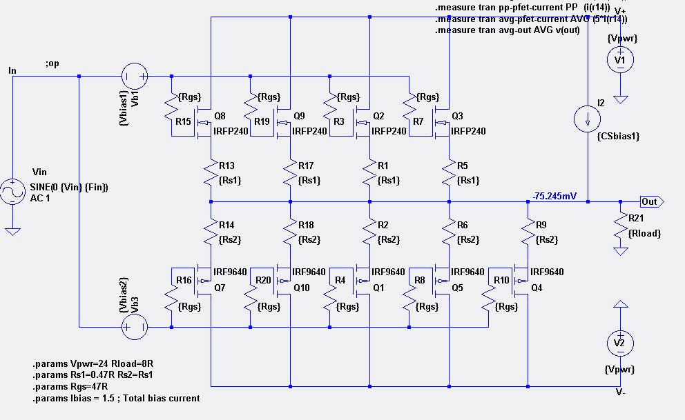

Here is another try at the XA30.8 output stage, based on the images in the 6Moons review.

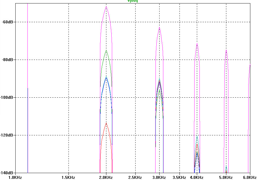

The distortion spectrum is based on a 1kHz, 1 Watt output into an 8 ohm resistive load with the total bias current of 1.5A. The colors correspond to different values of alpha and single-ended bias currents:
- Color Alpha SE bias
- Green 0.0 0.0A
- Blue 0.475 0.71A
- Red 0.525 0.79A
- Cyan 0.575 0.86A
- Pink 1.0 1.5A

I have no idea how Nelson adjusts the current source bias of the XA30.8. I could not detect any hint of a trimpot for such an adjustment in the 6Moon photos of the circuit boards. If Nelson has the goal of a particular H2/H3 ratio, then the output of each half can be measured and adjusted relative to ground to determine resistor values that are soldered in place. That would make it impossible to "tweak" the H2/H3 balance by ear.
The plots shown are based on a 1kHz fundamental. So the dominant peaks at 2kHz are the 2nd harmonics H2, which are the easiest to manipulate with different values for the balance between Vbias1 and CSbias1.
It probably would work for common-source output stages such as in the F5X as well. The idea is to be able to adjust the operating point (bias current) of the fets to compenate for the Kp (transconductance) mismatch between the PFETs and the NFETs. In the F5 with the P3 mod, the overall H2 level can be adjusted for the entire amplification chain. Nelson apparently believes that there is value in controlling H2/H3 in the output stage as well. This might greatly reduce the generation of higher harmonics caused by the global feedback loop.Couple odd ones against case wall. No tellin what's hidden under the main board. Even scarier thought. He did by pre matching fets to certain gain separation. Nah.

Because there is no extra trimpot for SE-current visible on output board it may be assumed that SE-current is set (automatically) together with PP-bias current (on FE-board).
Interestingly that PL has changed numbers of output devices also for older XA.5 amps.
If we compare this with published class A-currents it can be calculated that in each amplifier each output device handles a bias current of about 200mA. May be this value results into a kind of "sweet spot" which Nelson describes in one of his articles.
Wether SE-current is identical to PP-current of one "PP-device" we don't know because values of source resistors are not visible.,,,,,,
