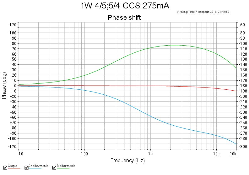

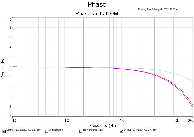

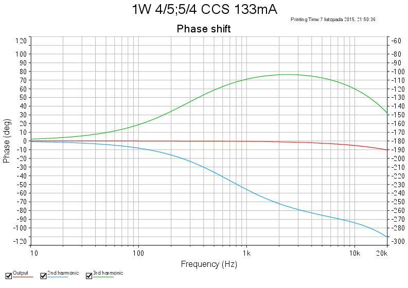

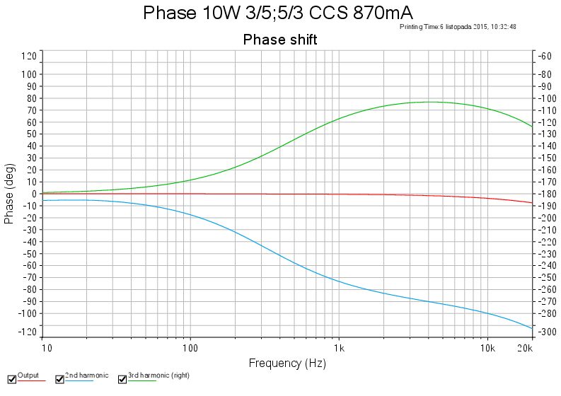

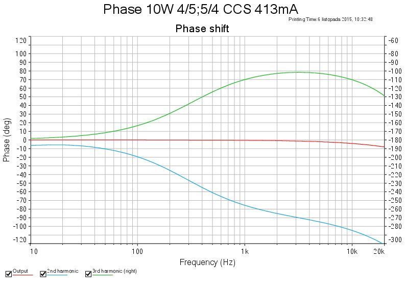

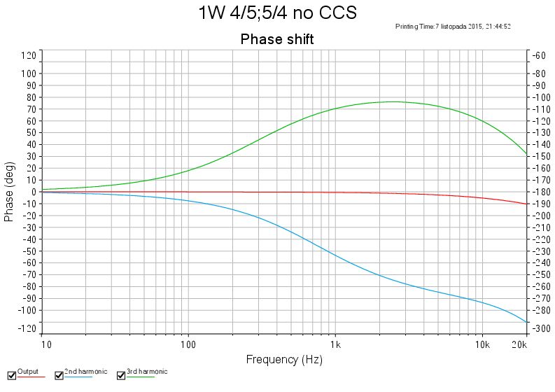

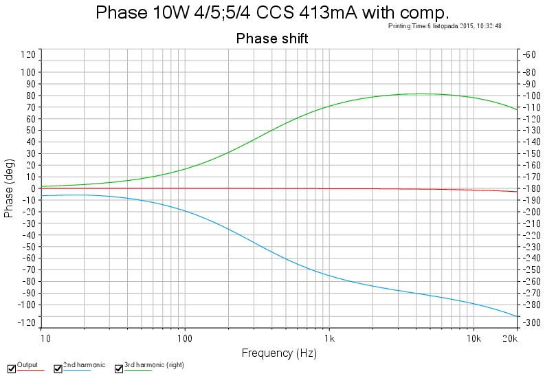

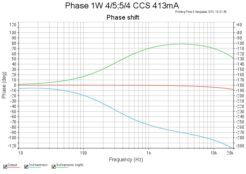

I think that phase shifts plays dominant role in localisation and resolution of sound sources - from psychoacustic - ears are more sensible to phase shifts then to volume & frequency. Here comes some simulations:
1. 4/5;5/4 1W CCS 413 mA
2. 4/5;5/4 10W CCS 413 mA
3. 4/5;5/4 10W CCS 413 mA with compensation
4. 3/5;5/3 10W CCS 870 mA
5. Zoom on total phase shift (the grey is one with compensation (3)).
First, second and fourth are about the same, power and MOSFET configuration have not influence on phase shift - 8deg - good. After compensation (3) phase shift = 3dB - much better. This kind of compensation has not influence on harmonic level and shape at lower frequencies.
So it's time to build something.

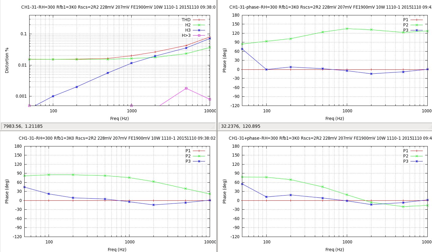

Here are some actual measurements of an amplifier I built which is similar to the XA30.8. The frequency sweeps are at 10Watts into an 8 Ohm load as follows:
DiffOut harmonic Levels vs. Freq | -phase Out Harmonic Phases vs. Freq
DiffOut harmonic Phases vs. Freq | +phase Out Harmonic Phases vs. Freq
  • CH1-31-RH300-Rfb3K0-Rscs2R2-OS228mV-207mV-FE1900mV-10W-phase-sweeps-1110-1.jpg
I need to clarify two points about the plots in my previous post.
The H1 (fundamental) phase plots are totally flat because my distortion analysis software does not have access to the input to the amplifier. The H2 and H3 phases are relative to H1 of the output.
The H3 phase information at 50Hz is not to be trusted since the H3 magnitude is near the noise level of the system.
