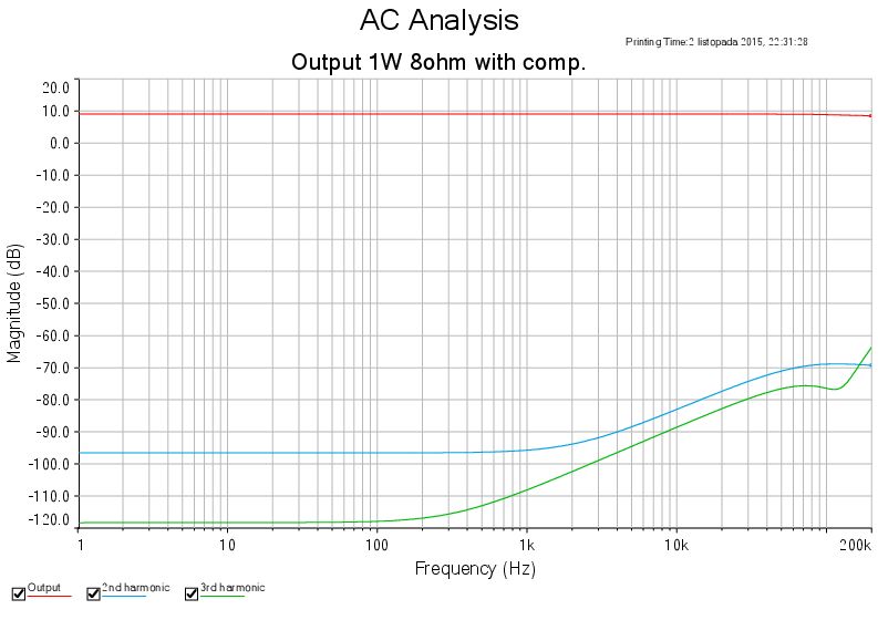

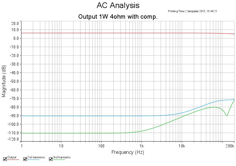

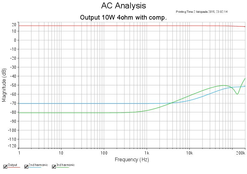

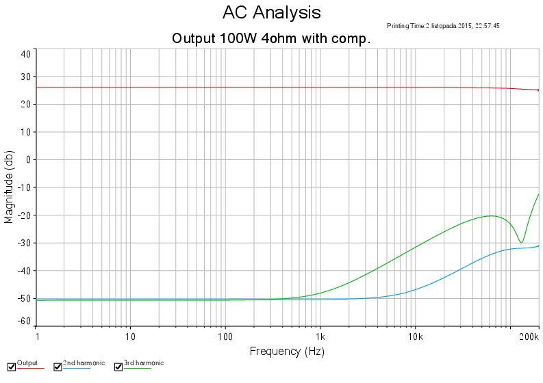

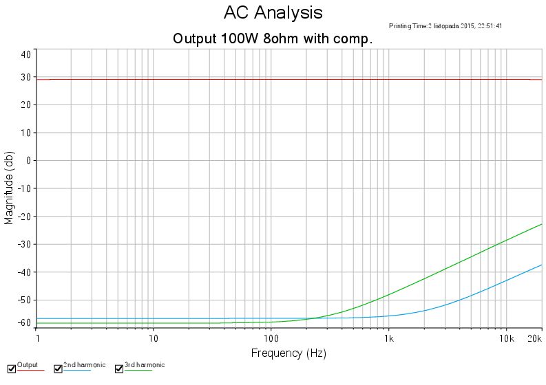

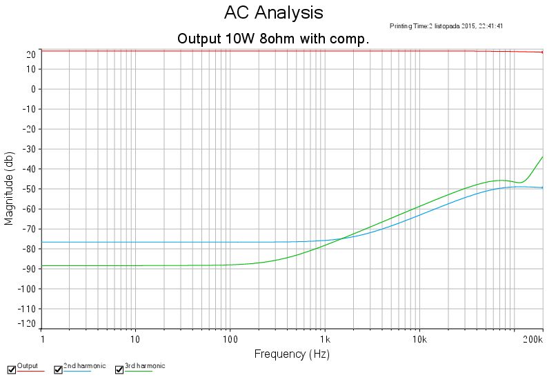

Hi, I've been watching this forum for many months & trying myself build something like XA.8 amplifier. After months of simulating different circuits, i've got interesting results. Look at these simulations at 1W, 10W, 100W, on 4 & 8 ohm load. Circuit is assymetric power end with base current of 300mA per MOSFET (7/6; 6/7 MOSFETS) with two high precision CCS of 300mA replacing missing N & P - channel MOSFETS. Used UGS circuit for simulation is the secret (maybe patented), but I can reveal that is general a little simpler than that posted in #354 & has only two feedbacks one local with high freq comp. & the global one. I'm interested in your opinion. Here comes simulations:

Fairly consistent with reality. As the output current rises, 3rd harmonic
becomes a larger portion of the distortion.

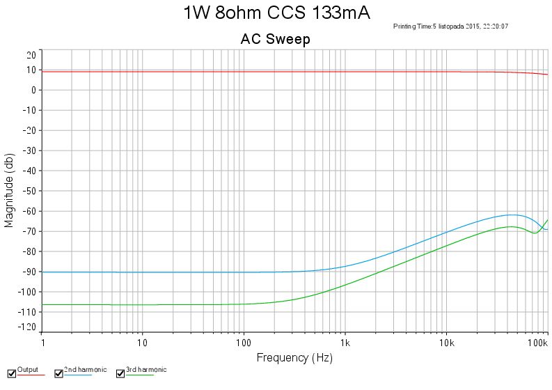

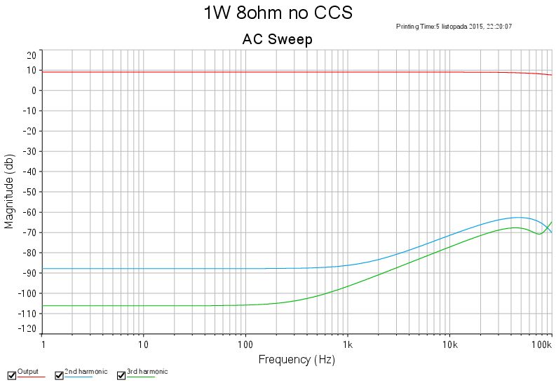

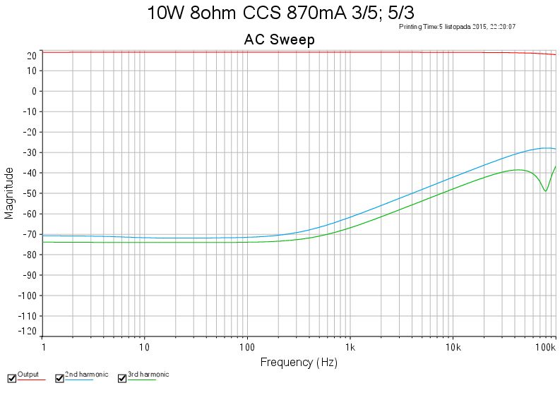

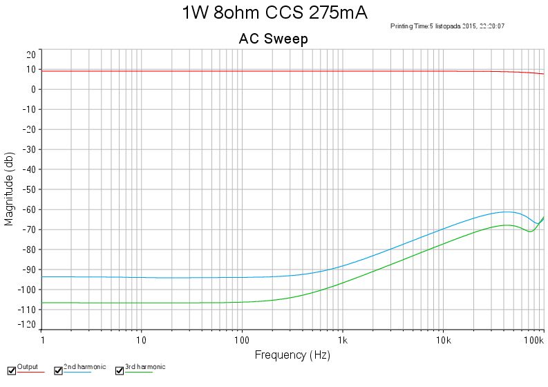

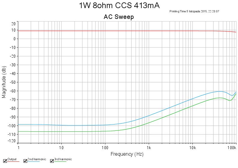

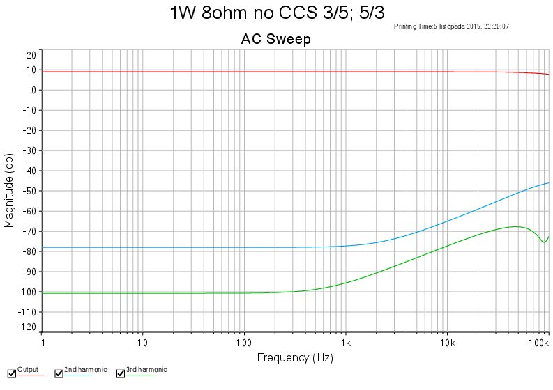

Hi again,
I think I found the secret of good sounding XA line.
So look at the first simulation - "symmetrical" asymmetric 4/5; 5/4 MOSFETS like XA30.8 at 1W on 8ohm output with no CCS at all - dominant 2nd harmonic. On the next pictures until 5th simulation you can see the same circuit with increasing CCS current. As you can see 3rd harmonic is totaly independent of CCS (depends only of global/local feedback) but a miracle is of 2nd one. At 413 mA per branch 2nd harmonic is getting strictly parallel to 3rd by a distance of about 8dB. This distance is reducing along with the increase in the output power, but stays parallel.
So, can we increase/decrease distance between the harmonics? The answer is yes !!! Look at simulation 6th & 7th. I've throw away next MOSFETS so we get "symmetrical" asymmetric 3/5; 5/3 MOSFETS at the same output conditions as above. 6th without CCS - as previously dominant 2nd harmonic but at 7th throwing away MOSFETS & increasing the CCS current by factor of 2 leads again to parallel 2nd & 3rd harmonic with distance between them of about 13dB !!! Moreover this parallelism is preserved with increasing in the power output - sim. 8th. Think, this little amplifier can work at 10W like SE !!!
Conclusions:
1. 3rd harmonic only depends of bandwith / feedback balance,
2. 2nd harmonic is dependent of deep of "symmetrical" asymmetry, higher asymmetry in N/P channel MOSFETS leads to bigger 2nd harmonic (adwerse effect is bigger THD of course)
3. CCS can modulate parallelism of 2nd & 3rd harmonics. Decreasing MOSFET count, needs same increasing of Iccs. So missing one MOSFET per branch I=Iccs, missing two -> I=2xIccs, three I=3xIccs etc. Throwing away all lower/upper MOSFETS in the branch and relatively multiplying Iccs leads to Xs amplifier?
4. Getting 2nd & 3rd harmonics parallel probably leads to proportional delay of frequencies and maybe this is the miracle of good sounding amplifiers.
