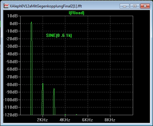

Sorry for the inconvenience that I posted such a long pdf-file. I missed to give a briefly presentation of the result. So here it is with a little delay:
On page 6 I examined the result when the constant current sources are placed in parallel to the p-channel MOSFETs on one half of the bridge and in parallel to the n-channel MOSFETs on the other half - that was the configuration we talked about in the previous posts. To us it looked most promising.
The result of the examination is: it will not give the best performance because the Susy distortion cancellation will not work in that configuration!
On page 7 the result is shown when the constant current sources are placed on both halves in parallel to the p-cahnnel MOSFETs, like it is shown in
XAleph0V12aMitGegenkopplungFinal2.asc. Error cancellation works fine, as shown on page 7 and 8 and the schematic uses feedback. So distortion pattern is preserved and not distroyed by feedback. The tricks I used to achieve this are explained in the text in detail: amount of constant current and controlling the gain of the source followers.

Again I made some thoughts about it and collected them in a pdf file.
Some simulation files mentioned in the pdf file are also appended.
lhquam, please read the file. I found out some things that show, that
it is very unprobable that the former circuit idea will give the best
results. Instead, a different idea with solution is shown.

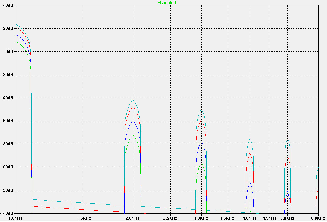

I have studied your schematic in xaleph0v12amitgegenkopplungfinal2.asc and your pdf file and have a few comments.
First, I took a somewhat different approach to preserving K2. First I simulated the output stage standalone with perfect inputs and adjusted it for the desired K2/K3 ratio. Then I adjusted the combination of local and global feedback (and various gain and offset adjusting resistors) in the front-end to preserve that K2/K3 ratio with enough global feedback to achieve a damping factor of around 150. This necessitated a very asymmetric local cascode feedback structure, but not significantly different in concept from that in your front end design. All of this was accomplishing the circuit topology shown in my .asc file. Here are the harmonic spectrum at 1W, 4W, 16W and 30W:

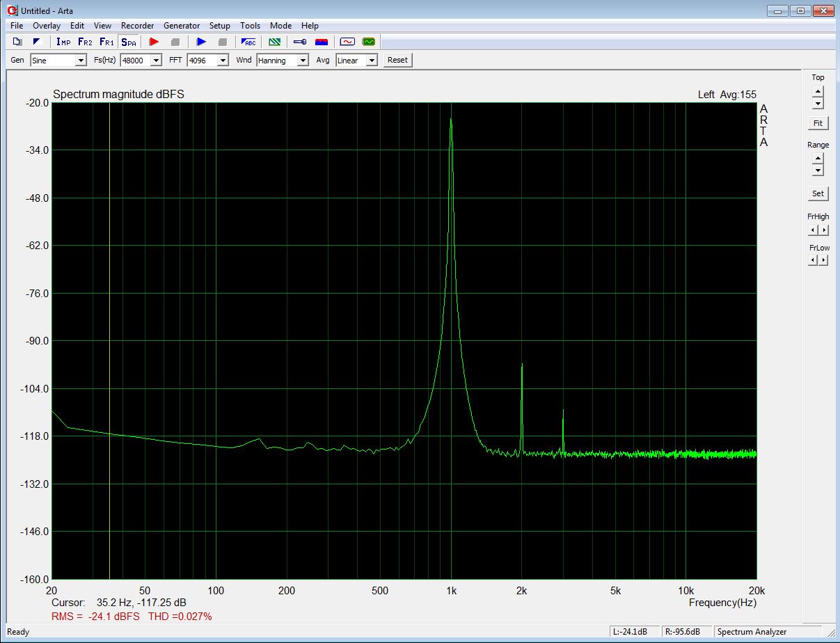

That looks like a no feedback SE triode tube preamp spectrum. If that's XA.8, stick I fork in me, I quit.
