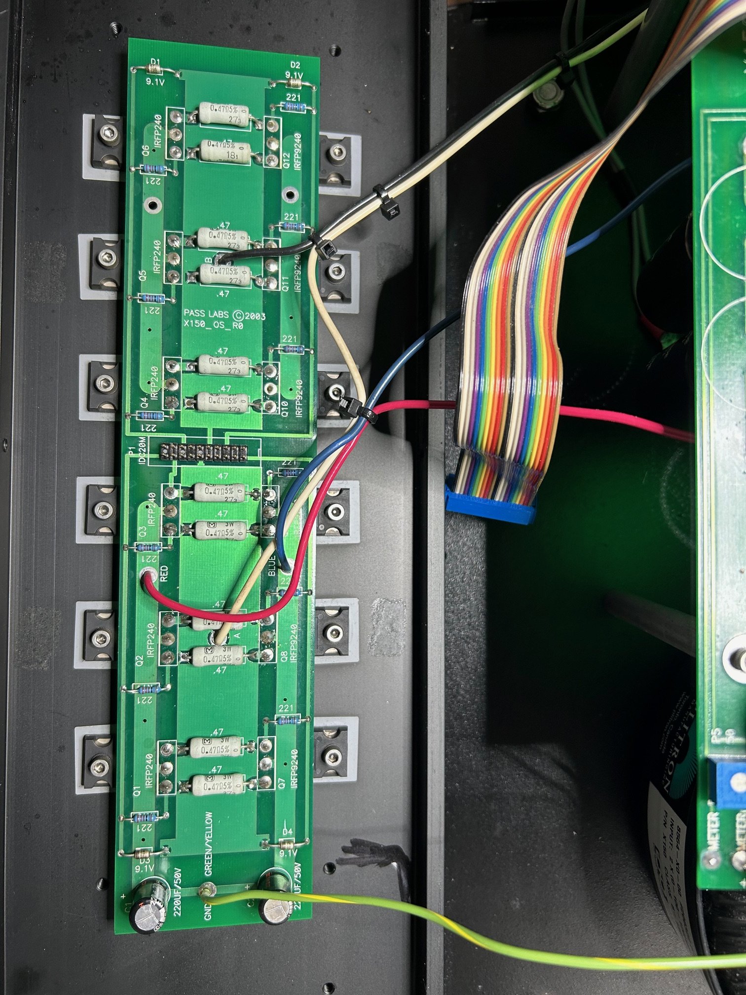

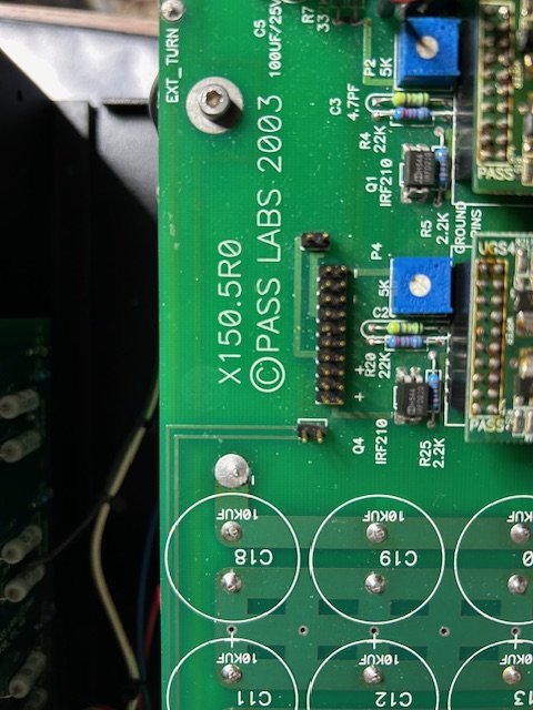

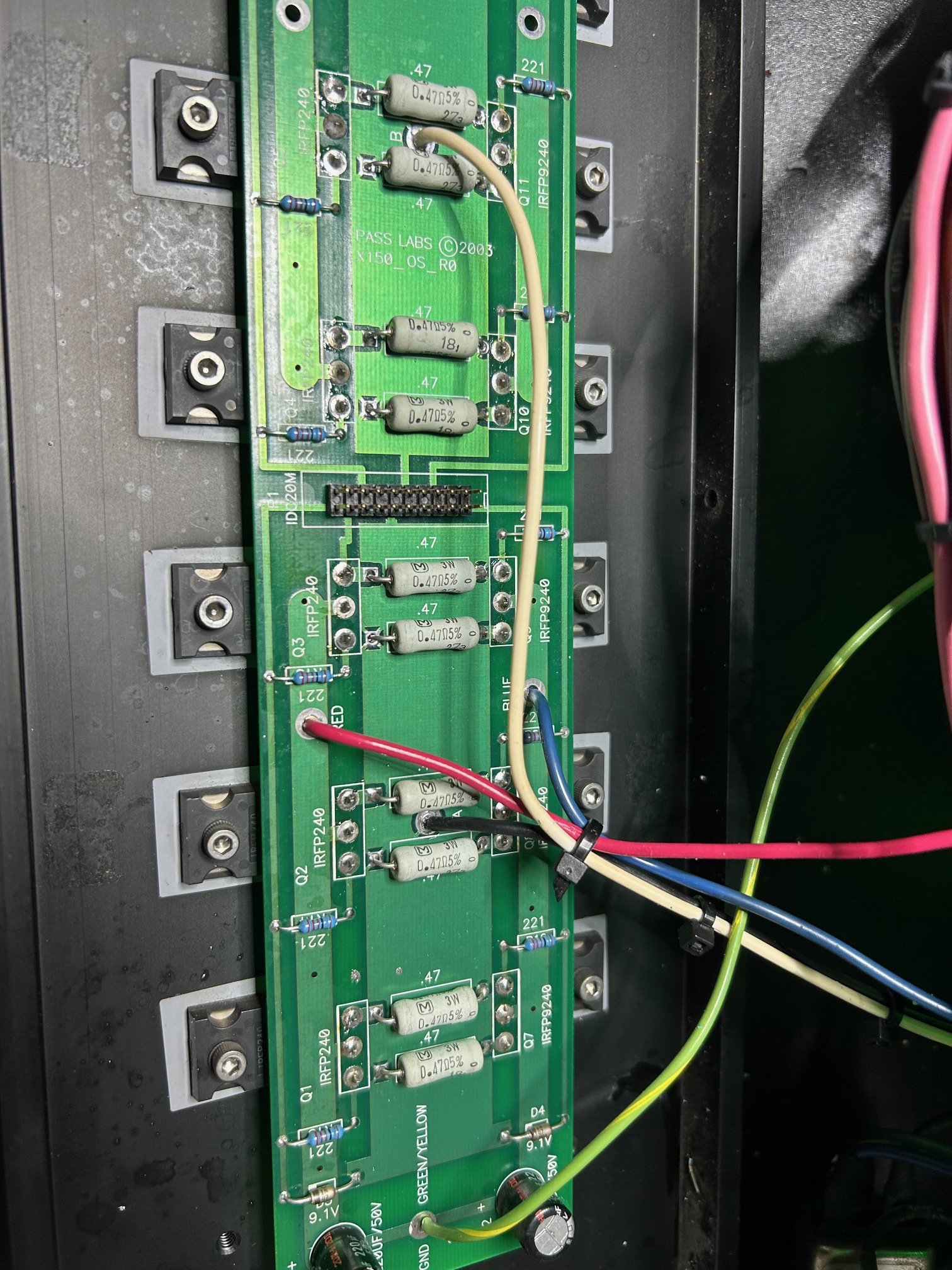

I have a PASS Labs x150.50 amplifier (S/N 14695) I think it is the first version (the board ID is X150.5R0 - PASS LABS 2003) I had to change the output connectors and now I don't remember how the cables should be connected to the output connectors .
Can anyone help me? Maybe if you have the same amplifier as mine you can post some pictures of the connections.

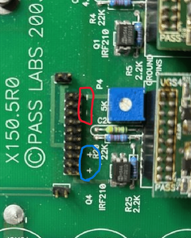

Reference these markings and look on the output stage to see if they are there as well. I suspect they stand for the + phase and - Phase. Probably the gate resistor traces since there are two on each phase. Probably +P +N & -P -N
Looks like the two -'s are for N-type mosfets and + are for P-type mosfets. I would wait for the mighty Zen Mod to chime in or call Pass Labs if needed. You can put some markings on the PCBs to indicate the direction for the future.

An easy way to make sure it is correct is with a meter. The IRF210 wide tab/pin on main board will connect to the IRF240 gates on the output board. There is 220 Ohms from that point to the gates or 0 Ohms where all the ends of the 220 Ohm resistors join.
I checked the layout on this and the two + + sides on the main board connect to the side with the red power wire.
This will also Ohm out correctly. Half of each module feeds the left and half the right.

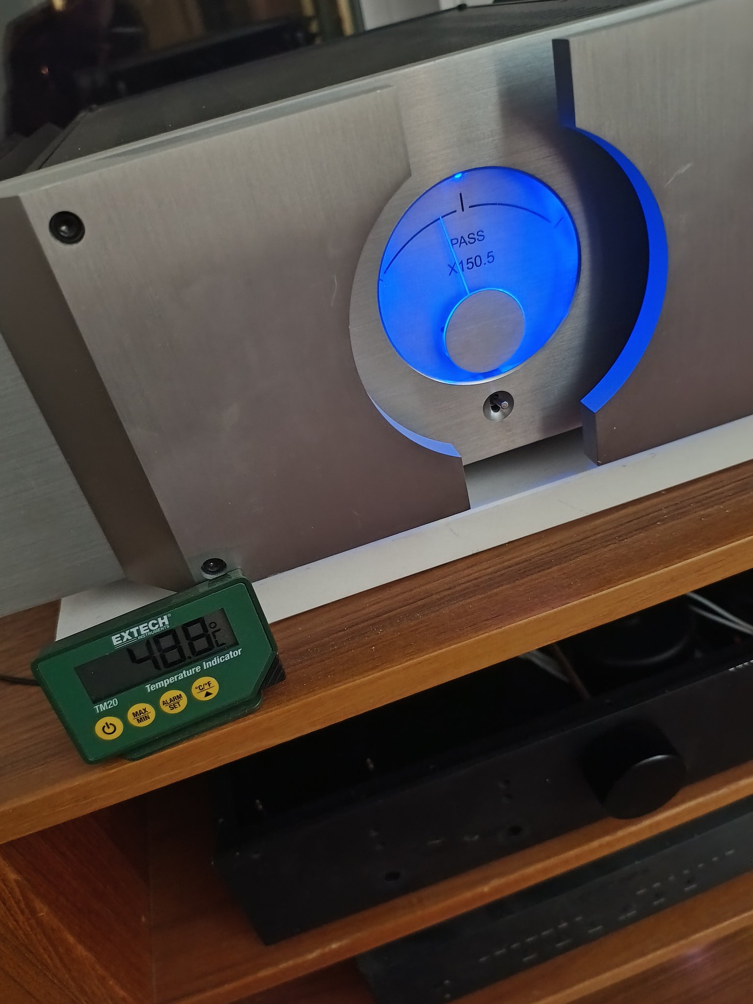

X150.5 is singing so wonderfully sometimes I have to pinch myself. It remains a reference for all other changes to source... In the cooler temperatures, it is serving double duty as a heater in the front room and after 3 hrs listening, the needle is dead still at about 3/5 till center. Temp ever so slightly approaching 50. At 50, the best recordings will come to play..just heaven. As always reference speakers are phase and time coherent Dunlavy Audi Labs. PS, that's the ZenMod Iron Pre SUSY right below. A thing of beauty that. Brought to another level with a shunt attenuator with zfoil load and takman to ground. On the X150.
