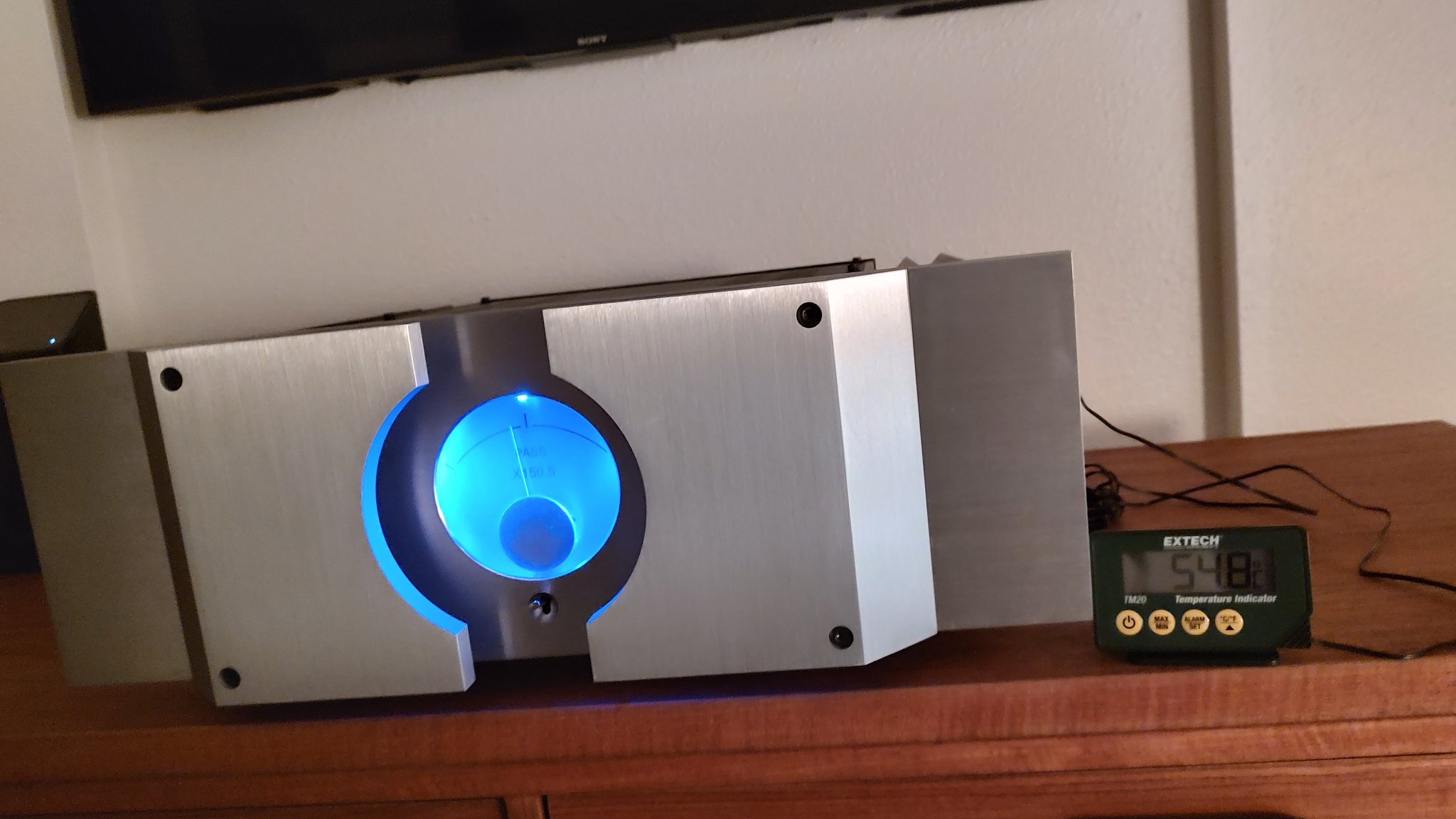

So , Zm No need more test.. Sound is perfect. Went and tonight reached 54. Opened the door.. Turns out Jim is a neighbor so wrangled Iron pre boards out of him. It was tough and we dickerd on price for at least an hour after some hand drawn schematics and some mutual respect was achieved, well the price was Silly. Iron Pre SUSY was a thought you had and I listened. PS populated
Above hasty..To the point, at 25 ambient I'm 50 all day long idle. Pushing on A/B 54. Opened the door. Need to look at spec sheet for ops mofet but I do know Tc for ecx moves after 60. Peace. Hope things are well in your part of the world!
