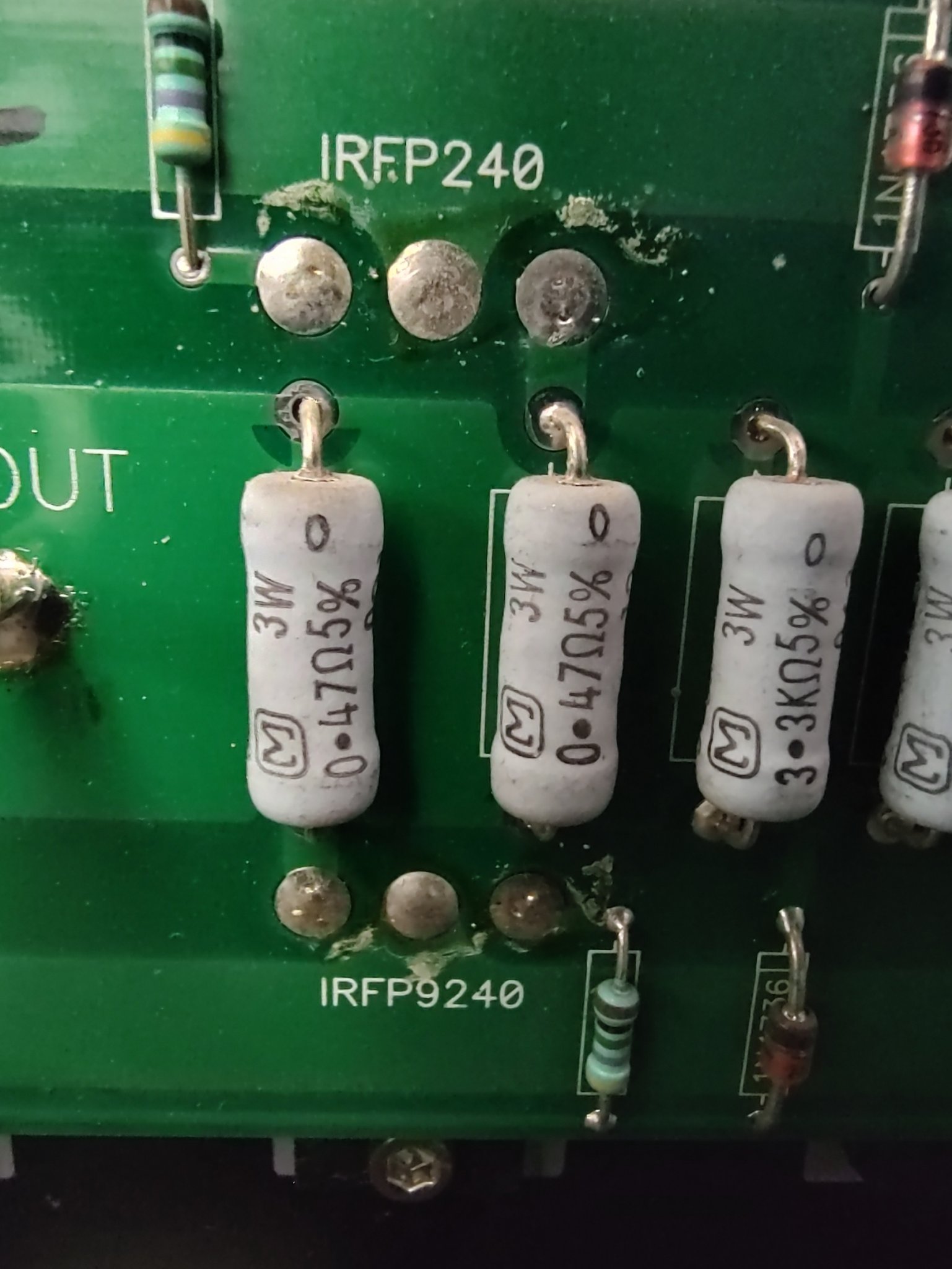

I wonder if you should consider reflowing some solder on the big R's. Looks like a void on the left one, though it may look fine on the other side. It's hard to see well, though.
Yes, I noticed that in the photo as well. Could be a shadow, but I'll definitely give it a closer inspection!
It's not necessary or advisable to solder both sides of the board, just the side having traces from the pad.
If the pad in question is not soldered on the plane side then it should be, to provide a direct path
for the current rather than through the via.
I don't think they intentionally soldered it only on one side. Likely fully soldered on the other side which is really good enough for production work. Also, that is the side they were looking at when soldering. The pad conducts to both sides... That is the output plane which they may have put on both sides to double up the amount of copper the output sees. Or just the pad.
Could fill solder on the top if your OCD is kicking in. If you are goind to flow some resistors, make sure you have a good soldering gun. Cardas solder flows like butter. Isopropyl alcohol is good for cleaning the leftover flux off.

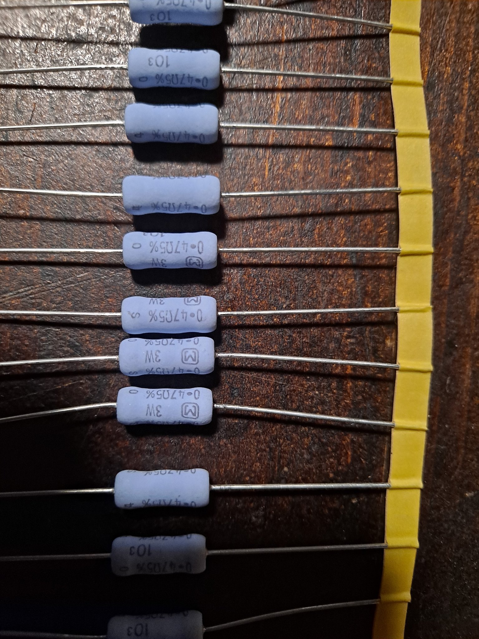

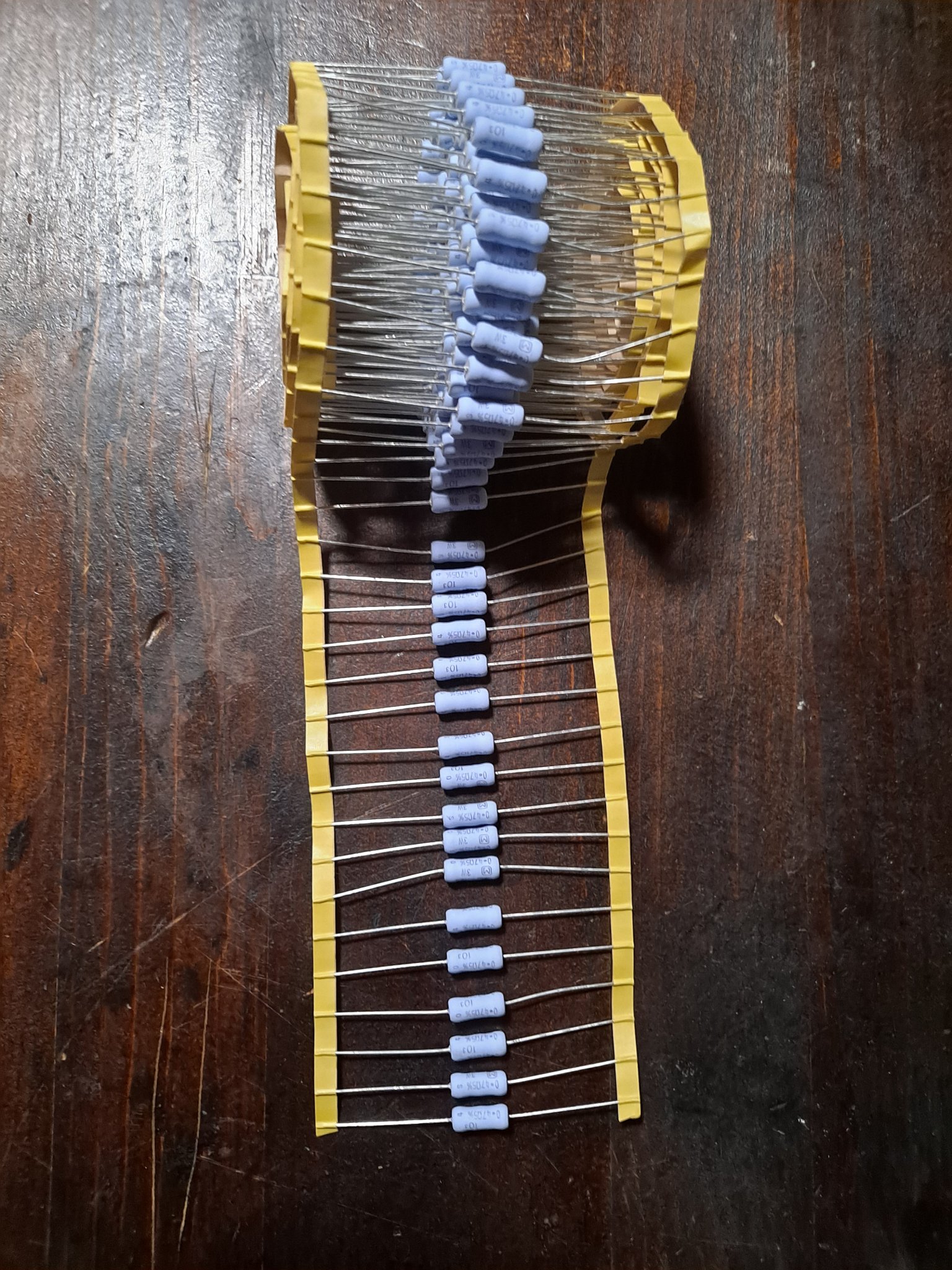

Interesting I did not know that. Do they make them for Panasonic? Here are a couple pictures of the ERX resistors I got from Digi key
in short, Technics, Panasonic, National ........ everything is/was Matsushita
I mean, interesting when chasing parts and facts

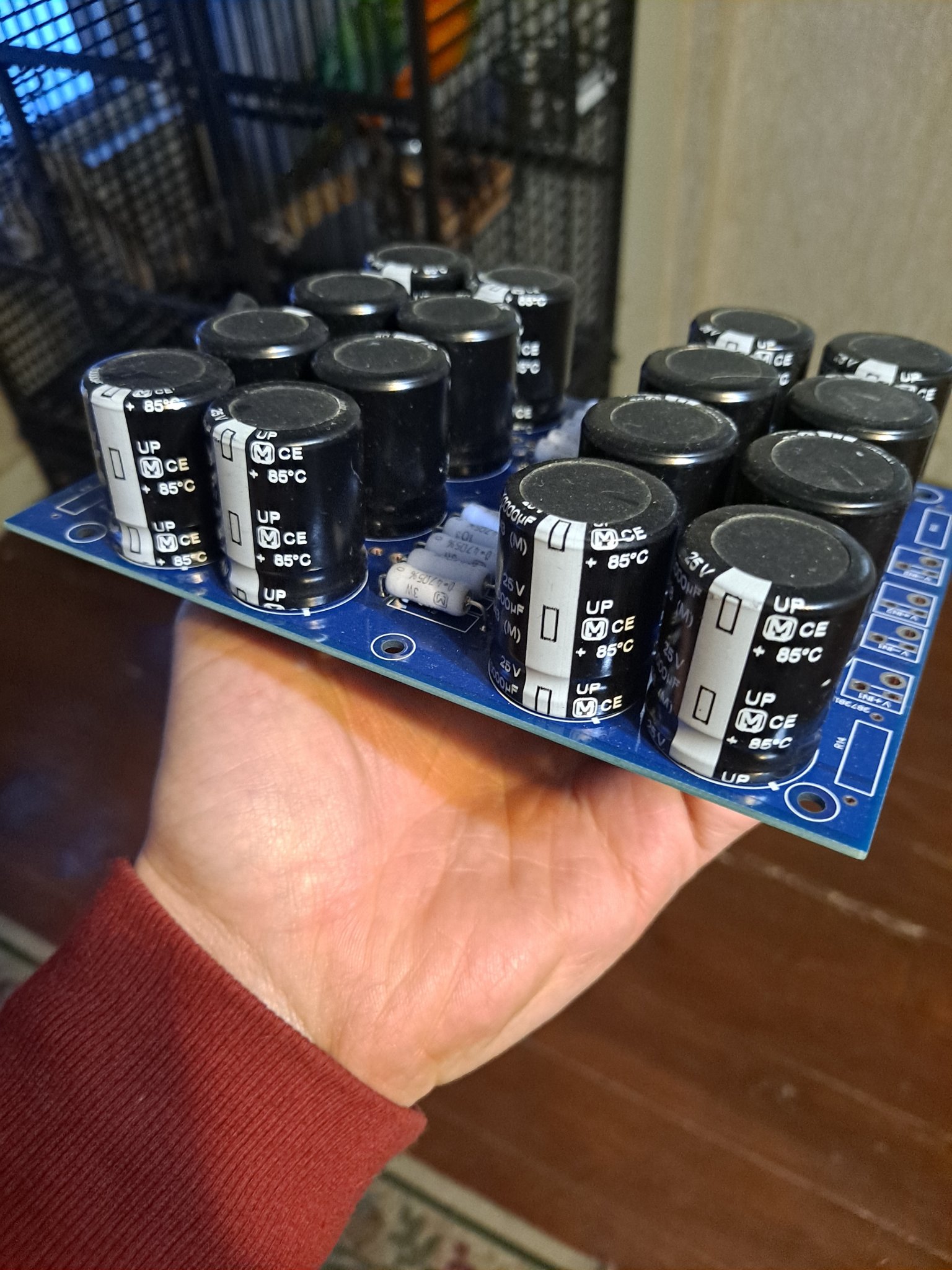

I remember some years ago someone wrote that the caps in the J2 power supply was 'nameless' even after others pointed out the meaning of the "M". 🙂
OT alert:Also hear some Panasonic caps that also have The same "M"
That power supply looks great, but is that an animal crate, screen door, or jail in the background?
Made me think of this scene:
