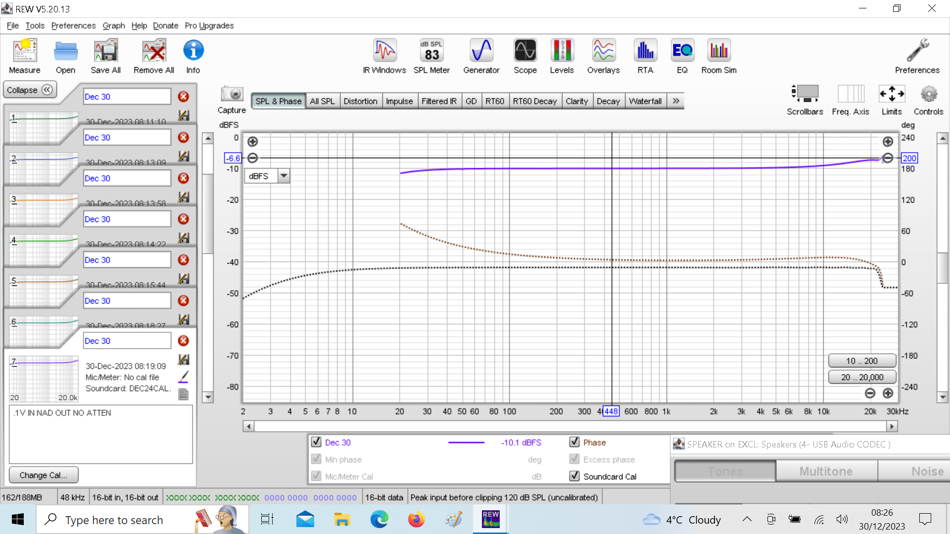

Attached screenshots with the X10 driving a Sowter 9545 transformer through a NAD 326BEE CD input with the preamp attentuated by 20db to suit the Behringer audio interface.
I am testing the transformers in preparation for use as differential to single ended using the X10 as a DAC outout buffer.

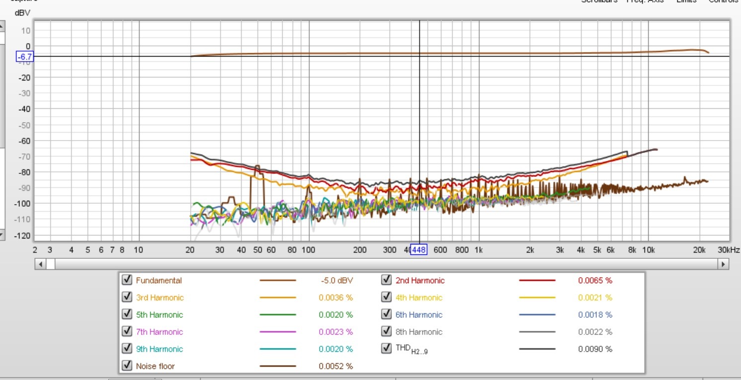

Ouput coupling capacitor increased to 100uf PP connected to the Sowter transformer primary. Secondary load is the 100k input impedance of a NAD 326BEE.
UAC222 used for measurements. Tube is 6N11. Lowest line is the soundcard cal.

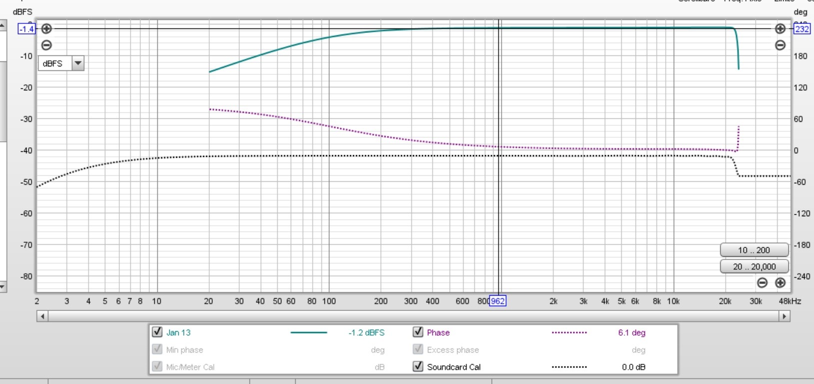

Lower trace is with 2.2uf ouput cap.
