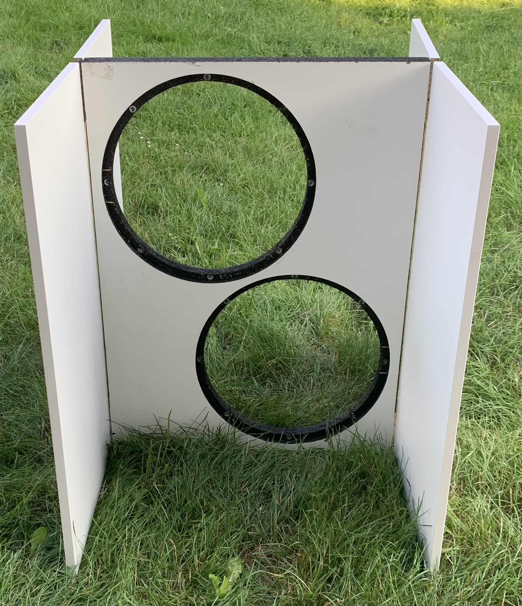

This first idea is based on 800 x 400 mm panels (that are sold in hobbymarkets), all the same dimensions. The top is not shown, for the first test, it would be just rectangular, if it is ever built properly, it will be in the shape of an hour glass.
The top panel length would be ca 57 cm and front width ca 97 cm with 45 degree angles - which would be about the biggest I could possibly fit into the room. It is meant for two 15" woofers.

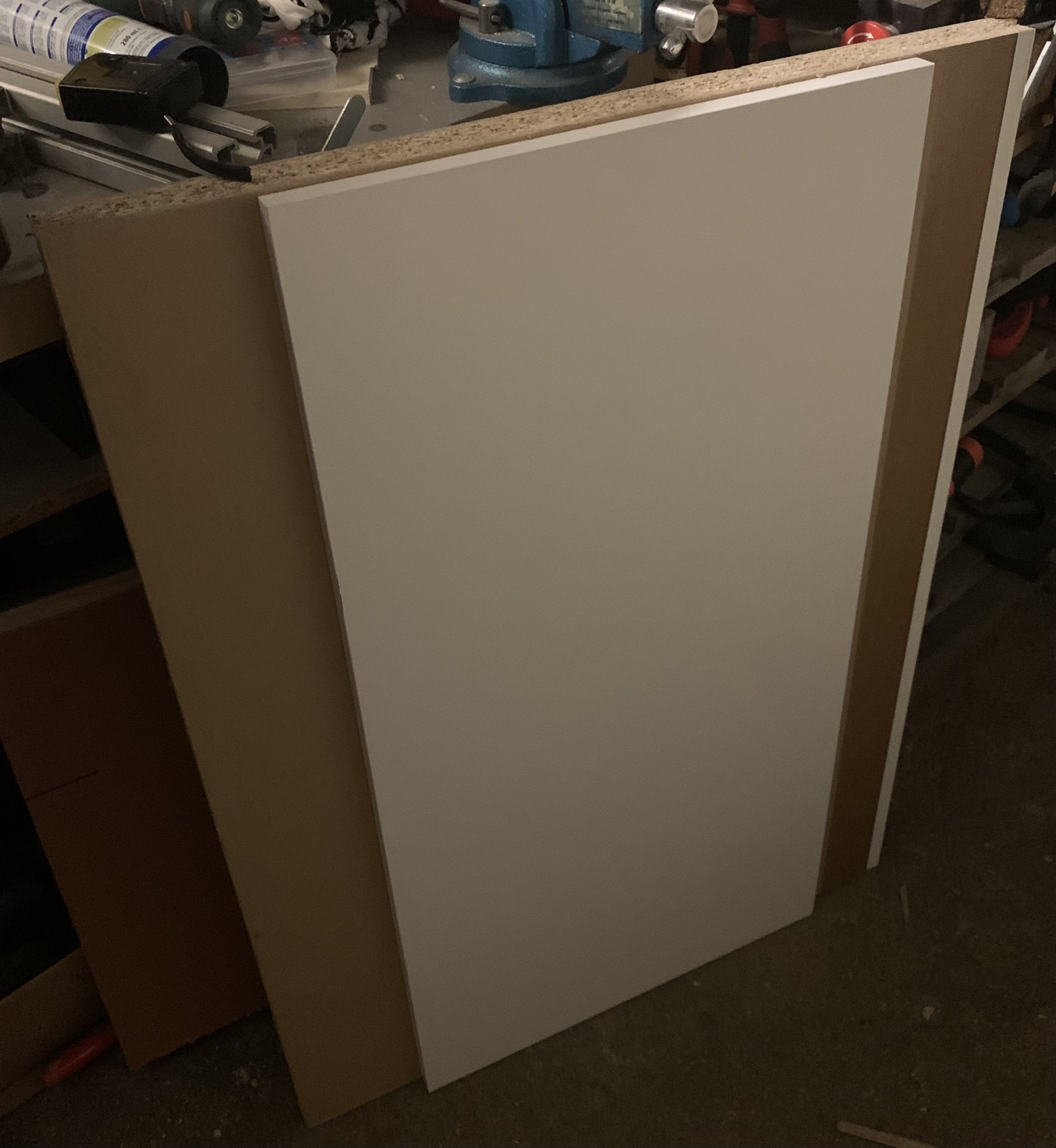

The center part will be cut out of 38 mm thick kitchen work top, woofers mounted from the front with a recess. The wings will be 16 mm thick shelves on 600 long mm piano hinges. I need to visit the local hobby market this week🙂

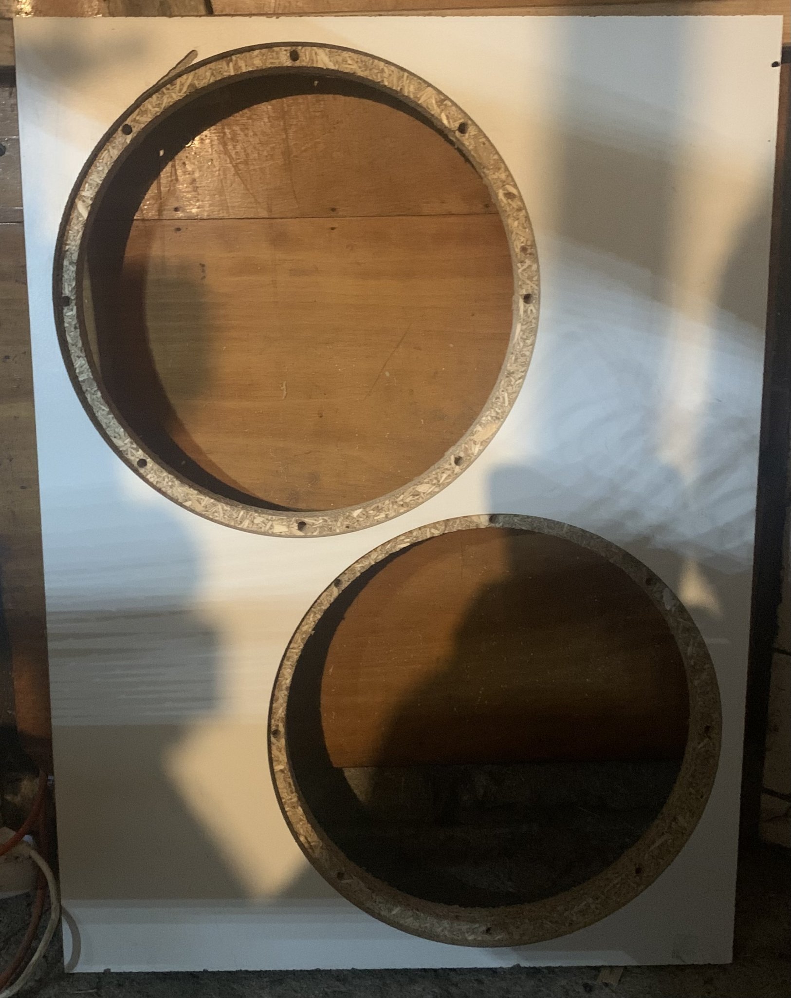

Finally a free evening to make a few cuts outside. I have decided to make the central part slightly wider, the woofers will be slightly offset to the sides. The plan for the weekend is to CNC the woofer openings and mount everything together - and maybe first music test as well.

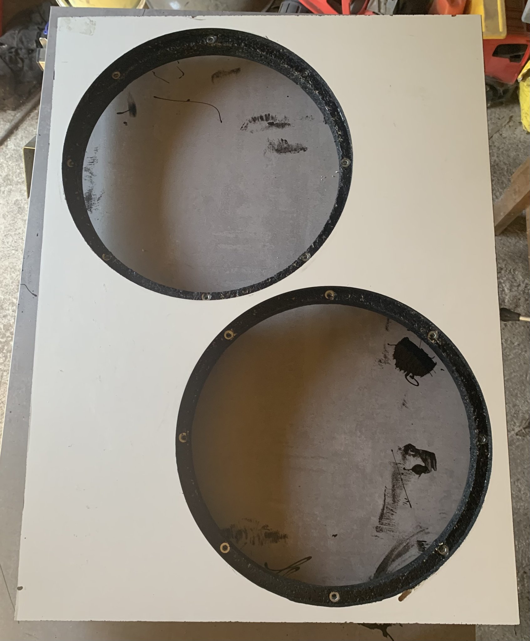

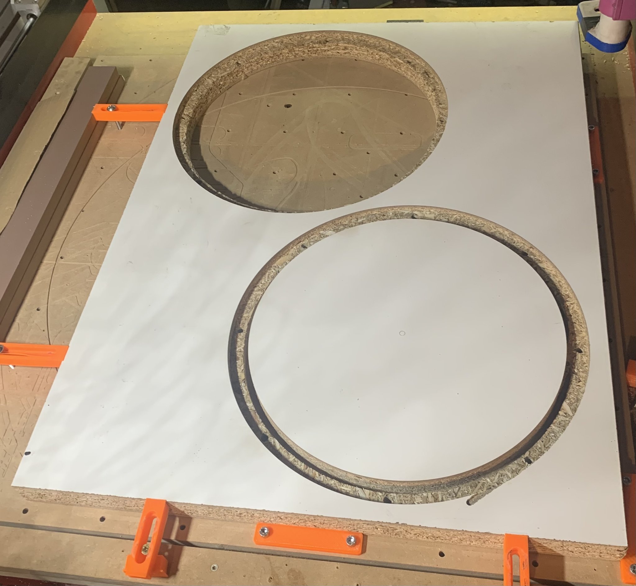

The baffle is cut. Tomorrow, I will sand the edges and paint them black, so that the chipboard holds better together. I had a small incident with a blunt milling bit - I will just leave the mark there, it is just a test unit anyway.

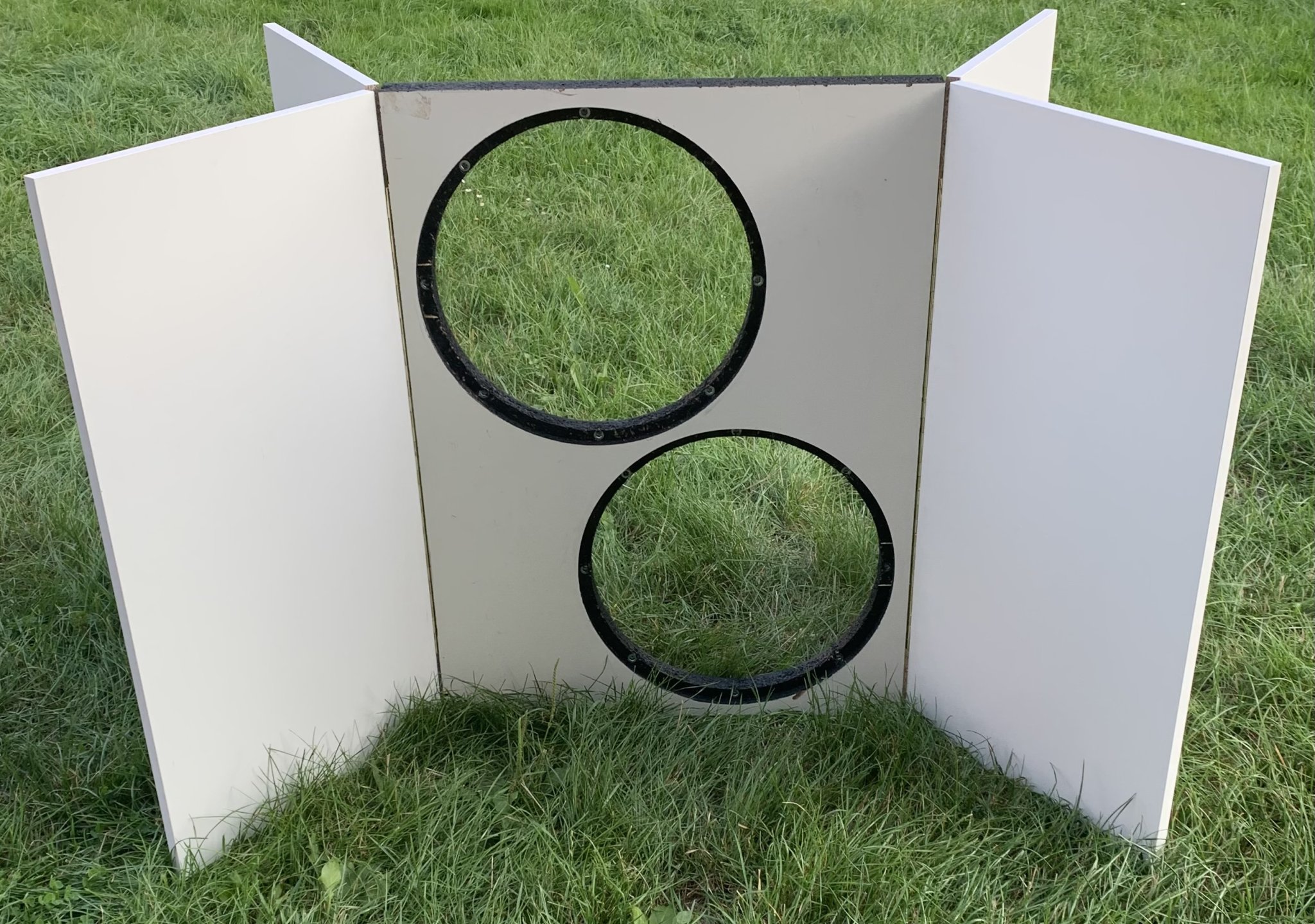

Threaded inserts are installed. The paint on the edges served its purpose, just added a second layer on the outer edges and around the inserts, where I had to file down the bulges caused by them. If I can find the right size of screws, the wings will be installed in the afternoon.
I have a question - do I need an air tight seal on the hinges? I would think it is not necessary, since it is open baffle and the wavelengths are very long.

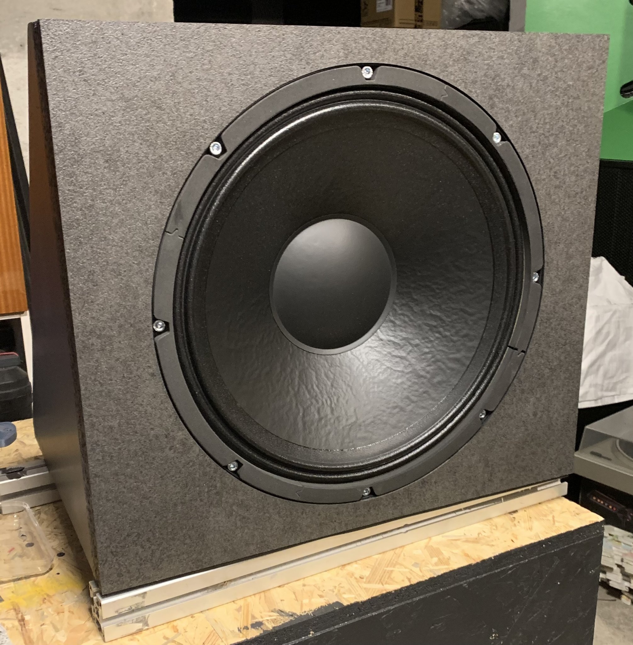

Drivers are installed, but it is getting too cold and damp for outdoor measurements. I also need to figure out a way how to move this thing more easily, it became quite heavy now and the nice 3D handles I printed do not allow full unfolding (I should have realized that sooner).

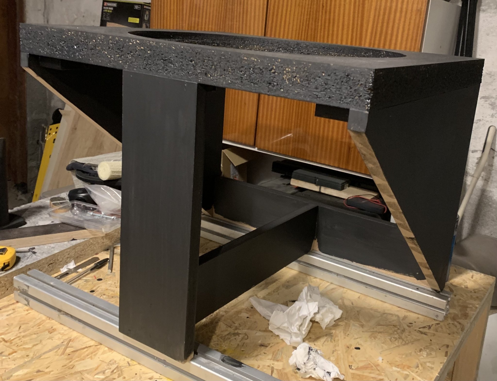

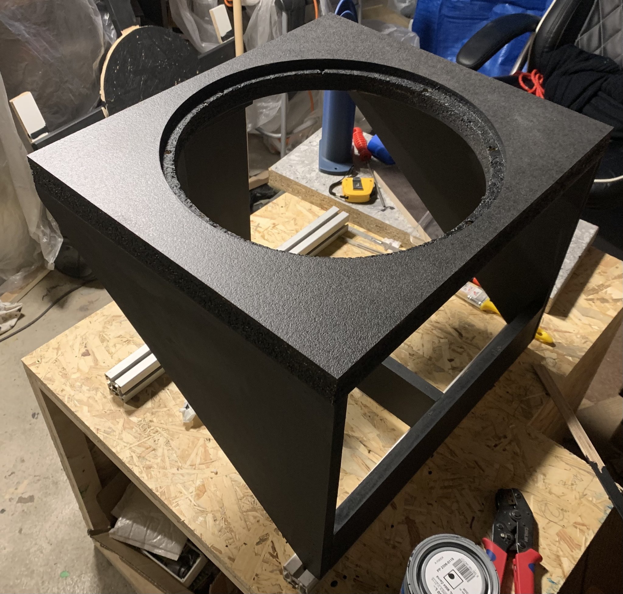

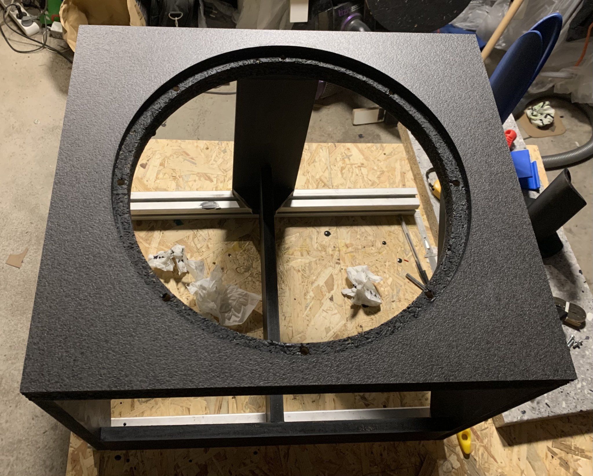

There is no way this could fit my smaller listening room, so I came up with this - a small open baffle bass module that fits the shelf. The baffle is identical to the DSP assisted BR box I built a few weeks ago. Inspired by @perrymarshall 's designs, it uses "lambda" shaped wings. I have recently found out, that at my listening volume levels I have plenty of amplifier power for boosting the low end with a DSP, so the baffle is more a woofer holder than anything else.

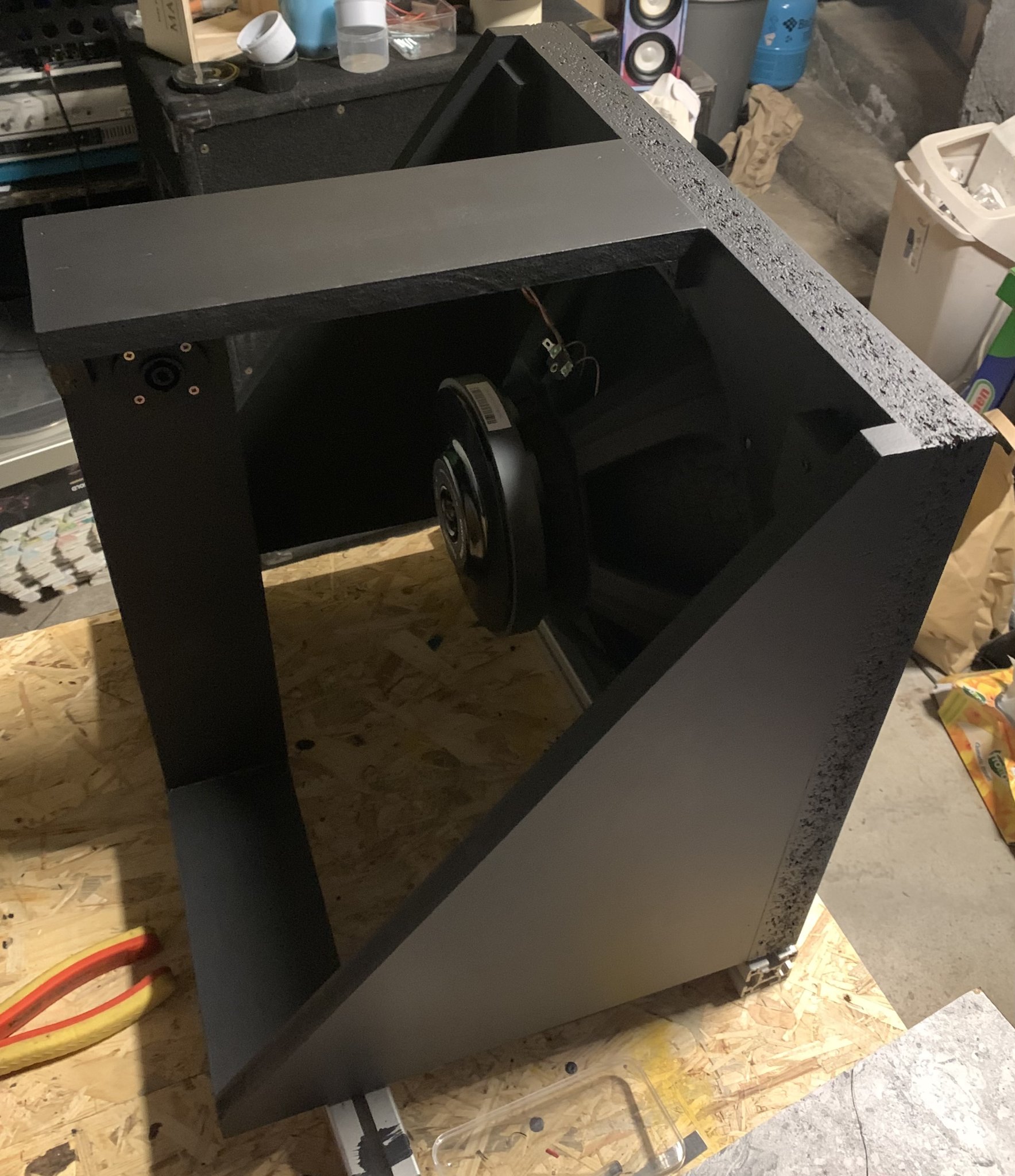

The Lambda-Wing is finished and ready to move up for testing when I make some space for it. I am curious how much different it will be compared to the DSP assisted BR box of identical dimensions. This one will be DSP equalized also.

I have not used or measured it yet, I need to move it to the shelf in the upper room where the test and listening happens. I have the 15OB350 in a DSP assisted 36 Hz tuned bass reflex box and listening to it crossed over at 200 Hz. Cannot say a bad word about it for this frequency range.
