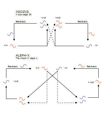

In order to inject an interest into this thread, I made two concept diagrams of feedback systems of XSOZV2 and Aleph-X, and compared them as follows. Do you see any error? Or any comment?

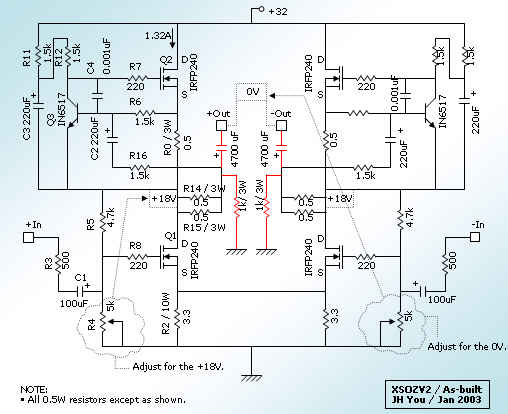

Output capacitors
For an experiment, I added output caps to my X-amp as drawn in red. The caps are of 4700uF/35V/85degC ordinary electrolytic. First of all, these caps block me not to see DC at the speaker cable connectors. Most of all, however, my interest was in the sound effect.
I expected that the caps would degrade the sound. Yeah, it was so however surprisingly as much as I could draw a conclusion that I would keep them there. 🙂

I presume that X-SOZ of Henrik¡¯s will give us very good sound. I also presume that Aleph-X of Grey¡¯s will do the same. I get to have the impression based on the presumption, not based on the fact, because I have never experienced with my ears the sounds coming out of the two amps. Yeah, the Aleph-X might be the king.
The Aleph-X has two stages: the input diff amp stage, which is x-fied, and the balanced output gain stage with negative feedback to the front end. Meanwhile, mine has no input stage, but the single output diff amp gain stage, which is x-fied with somewhat negative feedback. Mine is considered simpler along the signal path. This is the key point I have thought about.
Do I need the input diff amp stage as in the Aleph-X? If so, my BOSOZ is the equivalent diff amp of the input line stage. Do I need the ¡°generalized¡± high input impedance of XSOZV2? I do not really think so.
Do you imagine that the XSOZV2 gives us bad sound? If so, I should say that the balanced Zen V2 must give us very bad sound. The original Zen V2? Very very bad sound. The original Zen? Hopeless sound. Should I say so? No, I should not. All are untrue.
Have you ever heard of XSOZV2 sound actually?
I have not wasted any of time, money, space, and DIY-fun. The XSOZV2 is created 100% based on Nelson Pass design plus his in-house technology about simple circuit and its sound. I dare to propose Nelson Pass to consider XSOZV2 (or similar one) as a future Zen-X DIY-project, in respect of the sound...

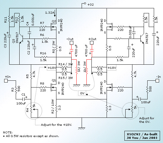

Hi Guys, now, I would like to make a conclusion on the XSOZV2 shown at the top of this page.
Power rating:
(a) With the circuit shown above
- Total Mosfet power dissipation: 85W/Ch
- Output power: 15W/Ch, 8 Ohms and 8W/Ch, 4 Ohms
(b) With R16 reduced from 1.5k to 700 and others remain the same
- Output power: 30W/Ch, 8 Ohms and 15W/Ch, 4 Ohms
(c) With R0 reduced from 0.5 to 0.33 and R16 increased from 1.5k to 2k and others remain the same
- Total Mosfet power dissipation: 130W/Ch
- Output power: 30W/Ch, 8 Ohms and 30W/Ch, 4 Ohms
(d) With R0 reduced from 0.5 to 0.33 and others remain the same
- Output power: 30W/Ch, 8 Ohms and 50W/Ch, 4 Ohms
I have no other data.
For your info, my current version is (b).
Thanks for your having shown your interests in the XSOZV2.
JH
