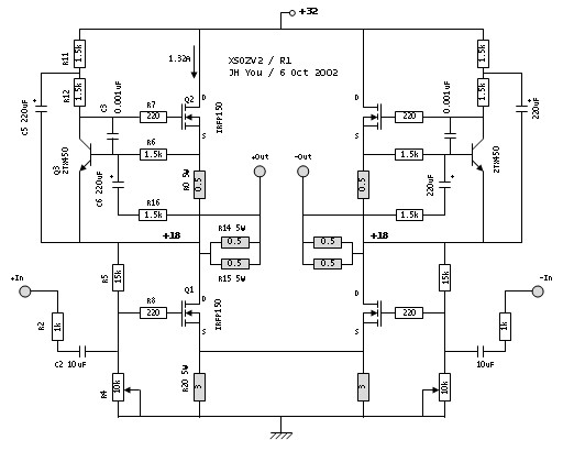

Updated Revision 1
An identification name, XSOZV2, is given to the circuit.
If this ID name gives you a confusion, I will change it at your request.
A brief description about the circuit is as follows:

- MOSFETs are to be properly matched.
- Bias current is about 1.32A.
- R20 is set to 3 Ohms, which could provide the tail of current source reasonably stiff.
- The input resistor R2 is set to 1k Ohms. This could be adjusted later, if required by the source output.
- The drain voltage of Q1 is set to +18V for an AC voltage swing of about +/- 14V. These closely depend on the supply DC voltage and the size of the tail resister.
- R16 is set to 1.5K for a 30% AC fraction. This could be adjusted later for a proper speaker damping.
JH
Is C2 (10µF) really necessary?
Why not using the input-circuit of Henrik? It looks more SOZ like.
How much output power do you expect from the schematic above?

- Stefanobilliani, I am happy with your praise.
- Selfmade, C: Yes or no. It seems up to the personal preference.
- Selfmade, Power: I hope 25W/ch with 8-ohm load.
- Selfmade, Input circuit: I am notoriously ignorant about the input buffer. Inned more study.
- Lieven, Sustained bias plateau of xsoz?: Probably.
occasionally busy night on duty for wife’s ecstasy…
C2 is essential as a practical matter.
Driving this circuit single-ended is not recommended, but
it will work, sort of. Optimally the diff pair is biased by a
current source. You can do this with just a couple of volts
loss, so it's practical.

Yes... Nelson Pass, C2 is essential for the practical feedback.
By the way, Nelson, XSOZV2 is one of your properties.
It looks like a simple circuit, but the following three are there all in one.

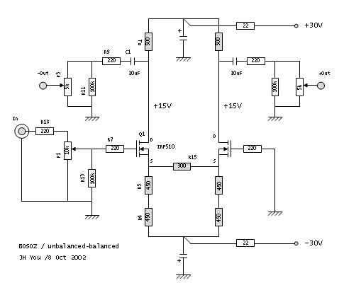

I meant converting unbalanced signal to balance thru (X)SOBOZDriving this circuit single-ended is not recommended, but
and feeding the balanced signal to XSOZV2. Now quite acceptable...? Please...don't say no.
jh6you

As you shrink the value of R15 on your circuit, it
will become a better unbalanced to balanced converter,
and you only need deal with the additional gain
produced.
Or you can use a current source. Or you can increase
the negative supply voltage and use greater resistor
values biasing the diff pair.
produced.

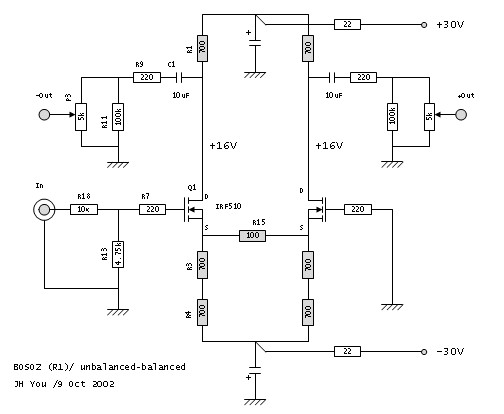

Nelson, please let me walk out of the issue about BOSOZ after this.
Your three alternatives explain me that the current source is the key.
I would try all three someday. Today, however, I am engaged to
the 1st alt only. Here is my new plan.
- DC supply kept of +/-30.
- Bias current reduced down to ~20mA.
- The values of tail resistors increased.
- The value of R15 decreased for a convincingly stiff current source.
- The high gain attenuated at the input with a voltage divider.
- The volume planned at the output.[/list=1]Question: If I shrink the value of R15 further down to 47 ohms,
would it be even better? If yes, I should also change the input voltage
divider from 10k/4.75k to 12k/2k. Is the 2k, if connected to the ground,
too small? Thanks.
JH
This will make it better in terms of the output
balancing, but I think at some point you have to
look at why you are trying to achieve a perfectly
equal output amplitude on both halves. If your
amplifier has an ordinary balanced input, it is not
of any particular value in terms of improving the
noise rejection, since the noise will be identical
on both sides regardless.
Unless you go to a constant current source for this,
you will continually be trading off some other
performance parameter such as noise and distortion
against the degree of output level matching.
If you want to continue to use resistors for biasing, you
probably have made as much improvement as you
need or want.

You shoud check the relation between outputimpedance of your BSOZ and the inputimpedance of your X-SOZ. I havent simulated or calculated your suggestions, but i beleve that you will get a highend roll off at -1db at around 20kHz, wich is too low in my oppinion.
I coud be wrong, but check it!
