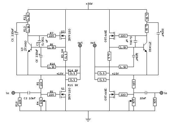

What about this...?The XSOZ can be made pretty efficient with a single

It looks nice, but I think this would be more akin to a balanced ZV2. If I'm not mistaken (and that's a certain possibility), in order to X-ify it you'll need to pin a tail on the long-tailed pair in the form of a normal CCS.

henrik, ever thought of making an additional tail current source (connecting r16 and r17 to negative supply).
So q4 and q8 floating between 2 active current sources and perhaps double feedback loops (kind of r36 and r38 on negative side).
Curious wath the effect could be.
In that way we could play with different values for feedback from pos and neg side (if there's a difference, it must be caused by q4 and q8) to add to the diff. pair.
just an idea, perhaps not a good one

Would this work?

general idea behind previously mentioned post: 'balanced' feedback-loop on an diff. pair.
Could be also a way for better tracking current draw of load.
Remember, just an idea, perhaps not even worth thinking about.

You need some input resistance for this to work the
way you want. This could be provided by the output
impedance of whatever will be driving it.
A pair of .5 resistors at ground is a little low for the X
effect as it is as low as the transconductance of the
gain devices, and only a percentage of the distortion
will be nulled. A high impedance current source, by
contrast, will give the whole effect.
Nevertheless, it is now technically an X amp.
To measure the amount of feedback being applied to
this circuit, drive it with a load and a source having very
low impedance and measure the gain. Then drive it with
the finite impedance you will be using in real operation
and compare the two figures.
Divide the lower figure into the greater, find the log10
of this and multiply by 20 and you have the decibels.
