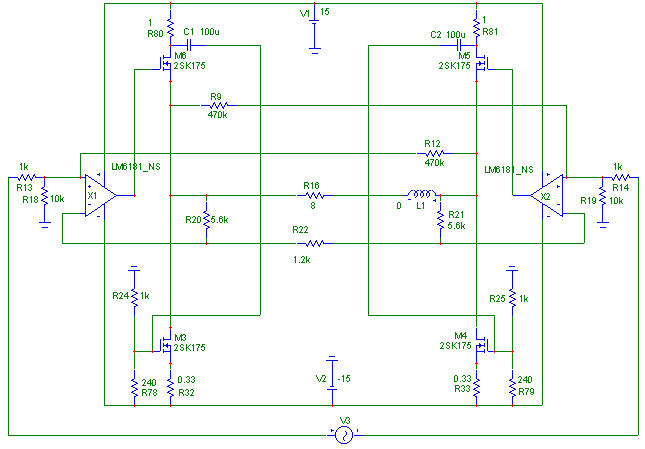

Hi Bernhard,
I have examined the design, and it looks pretty good to me. I'm a little confused at the 470K resistor from the output back to the non-inverting point; it would appear to be positive feedback, or is it somehow related to offset control (can't see why, though).
However, I have misgivings about the complex DC voltage shifter you have implemented to overcome the perceived shortcoming of using a 1R5 sense resistor. I've partially followed the Duke's comments about Wilson current mirrors, which are very clever gadgets - more tricks than a monkey on a mile of jungle vine - but the level shifter worries me.
Let's examine this. As the current falls in the upper mosfet, the voltage at the current sense rises. This positive pulse travels through the cap to the gate of the lower mosfet, and kicks up the current. The measure of current increase is dictated by three things for a given current increment; the size of the upper sense resistor, the transconductance of the lower mosfet, and the size of the current setting resistor in the lower mosfet. Rather than increase the upper resistor, it makes sense to me to reduce the current setting resistor, since most n-channel mosfets will have a transconductance in excess of 7 amps per volt. Let's use a 1A quiescent, dropping to 0.5A. Across an upper sense resistor of 0R47 - the size I choose - the voltage will rise 0.235V, PLUS any rise at the rail because it's now less heavily loaded. By my reckoning, even if only 0.2V of this pulse reaches the lower mosfet due to the loading of the gate stopper, at 7S this would raise the current through the lower mosfet, with say a 0R33 current sense resistor, from 1A to around 1.5A, which is pretty much lineball, and might even need watering down by increasing the value of the current setting resistor at the lower mosfet. BTW, these figures take proper account of the increase in voltage drop across the current setting 0R33 resistor, too.
If this does not check out on PSpice, then fer crissakes build the bugger and MEASURE it rather than rely on PSpice, which I have always regarded as a flight simulator anyway, useful for training, but hardly the real thing....
The elegance of your SS level shifter is unmistakeable. BUT, for reasons outlined earlier, the use of an electrolytic does not interfere with sonics, and the introduction of a further level of SS complexity, with gain moreover, introduces the unpalatable prospect of stability and unreliability.
I don't wish to pour cold water on this, Bernhard, but it's very clever, particularly the way in which you route the feedback signal. Nonetheless, how about single ended beast with more attention to trimming the quiescent to the absolute minimum to avoid switching, to foster the prospect of a little H2, Count? (A name I feel is appropriate after seeing your positively Transylvanian animated icons atop the page!)
Hugh
Duke, Hugh,
honestly I never tried to understand the Aleph current source and it is a mistery to me why it has even two caps.
One reason for this is the secret fact that often it is better not to know too much about what others have done before, which means to be able to look at things like a child who has little knowledge, this can pretend the tunnel effect.
Maybe its time now for me to have a close look at Nelson's masterpiece.
Anyway, the complicated level shifter works well on the sim, as does the whole circuit.
Before -you all were right- with the inductive load, the currents through the master and slave Fets were out of phase.
Now with the level shifter that bug is fixed.
The level shifter gives me the advantage that I can use the small source/drain resistors of 0.22ohm and that the grade of modulation is adjustable exactly to 100%, so that the currents through the fets are symmetric/equal.
Greetings, Bernhard

Duke,
like this ?
Drain resistor reduced to 1ohm but with this the current swing through the slave Fet is not 100%.

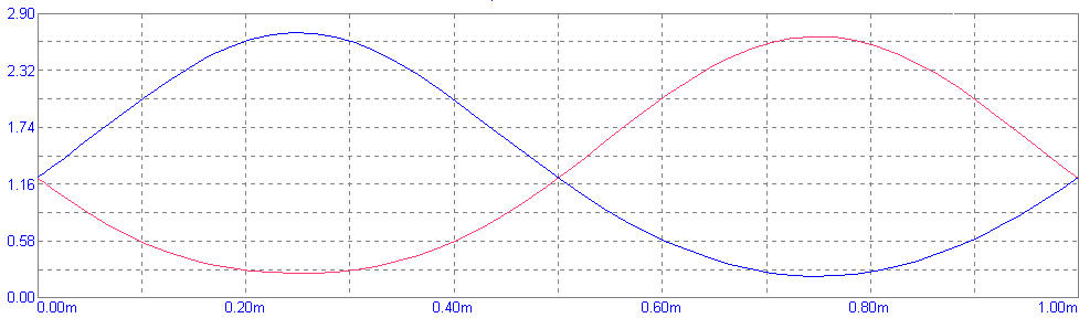

Hi Hugh,
Do you refer to the circuit with sliding bias and single ended classA or the other one or both ???

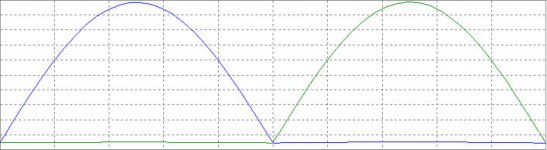

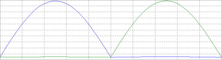

this is the Aleph with and without active current source, it is clear that all devices remain on at all times:
Now in the attached picture of the next post (sorry for the confusion...) you see that the currents also never go below 200mA per device even at full or no input signal.
Is that ClassAB or B and is there switching which might be audible ?
The graph belong to this circuit:
You say that the Aleph CS let all devices always stay on.
My Circuit with sliding bias and level shifter does the same except at clipping, but this is also with the Aleph CS.
And it must be like this, idle through each device is about 1.4A, so how should it ever turn off ???

These are the currents through the upper and lower fets just before clipping.
The clipping will be because of the driving op amp, not because of the CS running out of current...

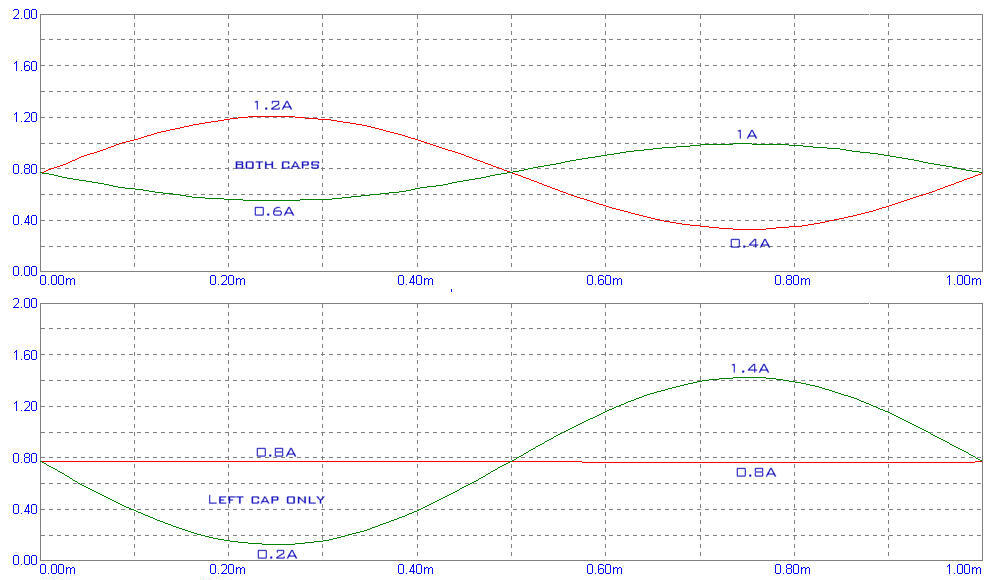

belonging to the sliding bias single ended classA
Nelson writes that the Alephs sound better with more bias.
This could be an explanation:
On full input signal, one of the two Fets carries only little current, around 200mA, if the idle is higher, also the remaining current at full signal will be higher, providing better linearity. 😕

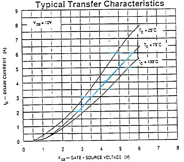

Look at the picture, @75°C the transfer function of this N-fet is perfectly linear between 2A and 6A, so it would be best if the current would swing around 4A idle point.
That also explains why the amp sounds better when warmed up, the transfer function is not linear @25°C @ same currents.
If the idle is 2A, the first few watts will be the best because the currents remain still in the linear area. :wiz:
The higher the output power gets, looking on one fet, the more one "halfwave" (2A and higher) gets even more into the linear region 😀, but the other halfwave (2A and lower) gets into the nonlinear region :bawling: , so no wonder that the last few watts are the poorest :dead:
So, if I'm right this is nothing about voodoo.
