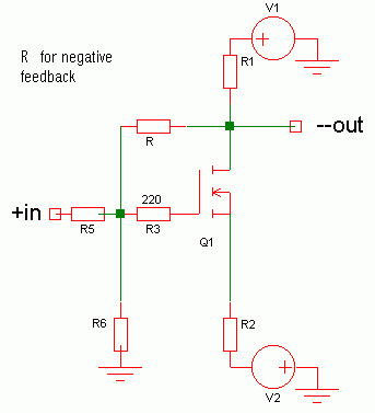

Essentially becouse the X circuit needs negative feedback.
If we think at a generic op amp draw we will see that to have negative feedback , the output must communicate to the inverting input (- in). If , for a while you don't care about the balanced nature of the XBOSOZ , you will see also that each halve of the circuit is a phase invertin' amp.
So each half has its negative feedback(R122 and R123) and the sole comunication between the halves is R115 ( short for max gain ) that ultimately forms the X.
Looking at Henrik's schematic, my instincts tells me that R122 should be connected between R108 and R121 and R123 between R107 and R120 to get the x effect.
Vinay
That will be POSITIVE feedback .

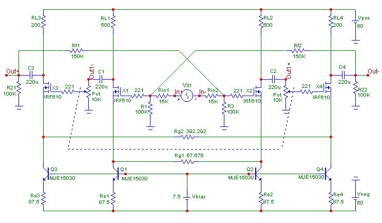

2-stage X-BOSOZ ?
Hi there, X-Gurus
I already have a nice BOSOZ that drives my AlephX, and I was just wondering if I could go a little bit further...
So I'm wanting to "X" my Bosoz, and Henrik's work looks promising to me, but I have a question : my bosoz is a 2-stage one, namely two "native" bosoz cascaded. The first stage provides gain, and the other acts as a buffer (gain #1). The reason is that I wanted to keep the input and ouput impedances cosntant, wathever the volume setting...
So I was wondering how to "X" such a beast. Do I "X" each stage separately (local), or do I include all the mosfets in the "X feedback"? Which is one would sound the best ?
Here is the second solution, at least the way I plan it. Does it seem OK to you ?
(Yes, I know, a lot of stuff's missing, but you get the idea 😉 )
