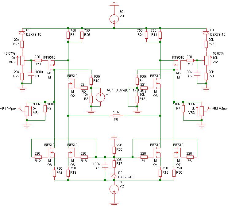

The mosfets are Irf 610 N channel, and
Irf 9610 P channel.
The trimmers are for regulation of output pins at O volt.
Irf 9610 P channel.

Since nobody answered my question about the optimal feedback and quiescent current until now, I would like to propose another upgrade of x-BOSOZ by adding temperature-compensated CCS (Constant Current Sources).
As mentioned early, this circuit does not need input and output capacitors by adjusting VR1 and VR2. However, in practical, the Vgs of Mosfet will be varied with the ambient temperature and Vsd. For small signal amplification, the temperature change dominates the variation of Vgs. In my opinion, stable quiescent current is quite important for this DC coupled circuit.
The temperature coefficient of zener diode depends on voltage and current. In addition, as zener voltage higher than 9V, its tempco is linearly proportional to voltage only.
Genius you can prove the CCS shown in the following circuit could be independent of the Vgs variation, if the tempco of zener is set to be about twice of the one of Mosfet. Note that the following drawing is just an example, and the selection of the voltage of Zener diode depends on practically measured tempco of the Mosfet. High value of current control resistor (750 Ohm) will help to reduce the influence of temperature change, too.
Any response will be appreciated.

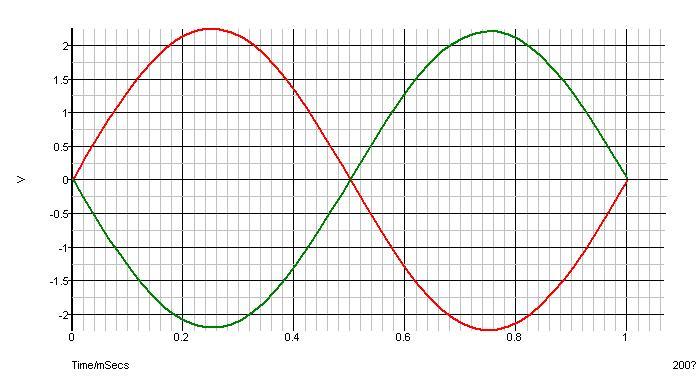

As attached is the simulation of the last posted circuit.
