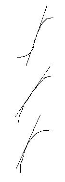

About the push pull configuration. Lets say amplication is perfect at voltage X (bias voltage). Above voltage X amplification is a little to low, and below X amplification is a little to high.
Asume amplifying a sinus wave, upper most is above voltage X, lower MOST is below voltage X. So upper most conducts a bit less current then ideal and the lower most conducts a little to much. The output voltage will be a litlle lower than it should. Around X the device is at its best linearity and so a very small sinus is almost perfectly reproduced. The higher the amplification, the more error and the more the output sinus is not how it should be.
I'm not sure where push-pull is helping reduce this distortion.

--Find a chart which graphically shows the resulting curve for a push-pull output stage.

Thanks for the hints Grey, you are right. (if i may adress you with your first name)
If the tangent line through the point were the bias is, lies above the actual amplification curve and the curve is symetric around this bias point then the push-pull units do cancel eachothers non-linearity out. (second drawing)
If however the amplification curve is above the tangent line below bias point and below the tangent line above the bias point then the pushpull topogoly makes the nonlinearity twice as bad. (first figure)
If the curve below the tangent line is not symetric the non-linearity doesnt cancel out (totally). (last figure)
All this is only vallid when the push and the pull device have the same curve.
So you need to have a push and a pull device with the same curve AND you have to choose the bias point so that the curve is symetric around the bias point and the tangent line of the bias point has to be above the amplification curve for the working area.
Sorry for the crappy paint-art 😉
Now the questions is. At what bias do these two conditions satisfy for the IRFP240 and IRFP9240?
