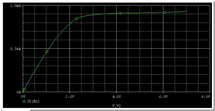

I think both my and your equations are ultimately the same sort of approximations for MOSFET. The problem lies not in which equation, but more about the nature of the equation.
In saturation mode,
Id= K((Vgs-Vt)^2) (1+L* Vds)
as you set your operating point on the graph with Vds and Id (assuming Vgs is constant), small signal voltage variation, vds, about Vds operating point will produce a large variation of drain current, id. Through a resistor or any other type of I-V conversion, you will give a large voltage swing, controlled by a small voltage swing. This is essentially how amplification works.
Now non-linearity is another story. Non-linearity refers to the fact that a small change of input voltage doesn't give a output voltage with the same amplification factor at all points. In the real world, a large resistance resistor is a almost-perfectly linear device, where the voltage input across the resistor will almost perfectly transfer as a output voltage across the resistor. This gives the amplification factor or gain, of 1, with of course some loss due to heat and noise. The non-linearity of a resistor is none, in the ideal world. A MOSFET in saturation does almost the same thing, as you can notice in the graph I attached before. In saturation, the I-V characteristic is almost exactly the same as a resistor. So the non-linearity is minimal, as opposed in triode where there is a second-order dependence.
Now, all about MOSFET are approximations, and the I-V characteristic in saturation isn't really as linear as we want, so there comes the non-linearity. It is not the approximation or the equations that present this linearity, it's the reality. If those equations we wrote are exact description, we would have never needed any sort of feedback or distortion-correction on non-linearity, because those imaginary devices are perfectly linear in saturation.

Thanks for the hints Grey, you are right. (if i may adress you with your first name)
If the tangent line through the point were the bias is, lies above the actual amplification curve and the curve is symetric around this bias point then the push-pull units do cancel eachothers non-linearity out. (second drawing)
If however the amplification curve is above the tangent line below bias point and below the tangent line above the bias point then the pushpull topogoly makes the nonlinearity twice as bad. (first figure)
If the curve below the tangent line is not symetric the non-linearity doesnt cancel out (totally). (last figure)
All this is only vallid when the push and the pull device have the same curve.
So you need to have a push and a pull device with the same curve AND you have to choose the bias point so that the curve is symetric around the bias point and the tangent line of the bias point has to be above the amplification curve for the working area.
Sorry for the crappy paint-art
Now the questions is. At what bias do these two conditions satisfy for the IRFP240 and IRFP9240?
