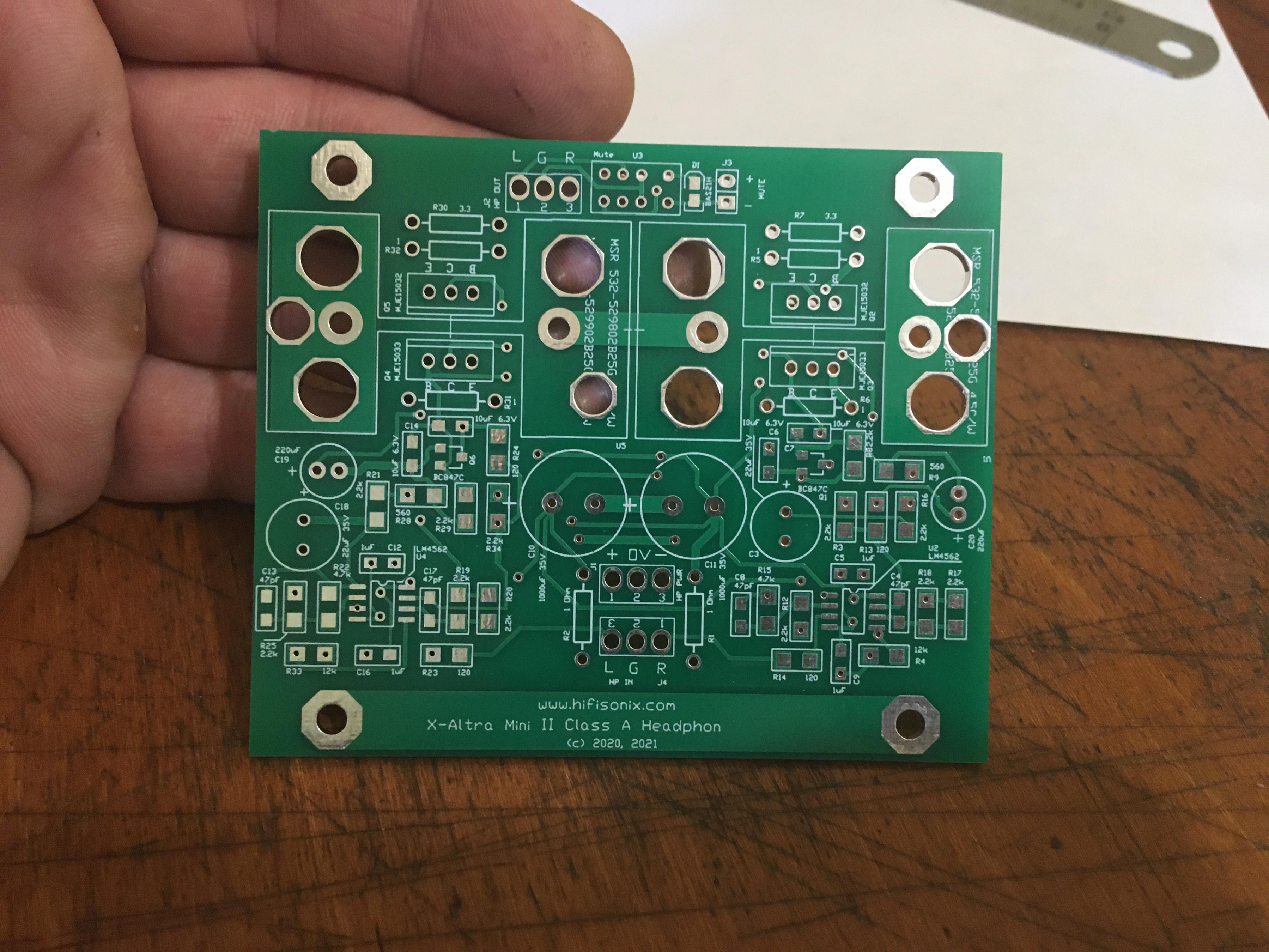

Board arrived today, excellent quality. Thanks Andrew.
You missed out the 'e' in headphone, will the board still work? ;)

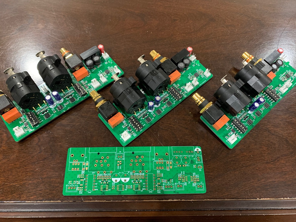

I just tested 3 versions of my balanced/SE to balanced and SE buffer with OPA1656, OPA1642, and LM4562 side by side. The OPA1656 and 1642 both sound superb. Very engaging and bass was very nice. The LM4562 sounded good but I think was just not as engaging. A bit “dry”. However, if you did not compare side by side, the LM4562 sounds fine and one would not know what one was missing. It’s a subtle effect. Maybe the difference between BJT and JFET/MOSFET technology?
The main reason I did this was that I had specd my buffer to use OPA1656, which are becoming increasingly hard to find in stock. Whereas the 1642 is plentiful and a little less expensive.
That's well-put.
Maybe. It just bugs me when I hear a clear difference that I can't quantify by any measurement. :mad: :eek:
