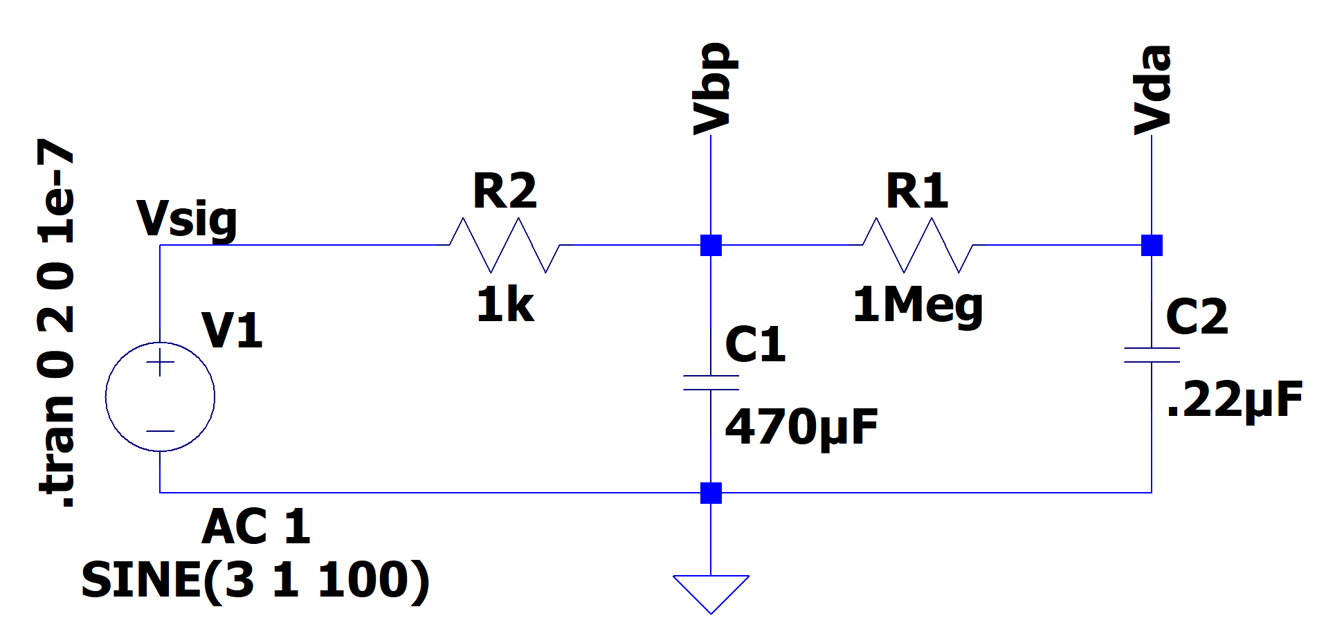

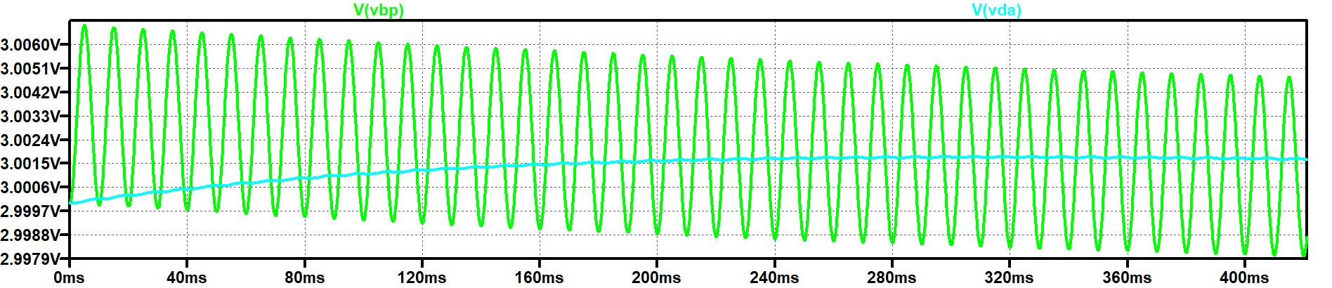

Picking up on the original point of this thread, namely capacitor distortion, here is a quick sim showing the effect of DA
here is the model I used
You can see that if the capacitor is undersized, you will create an AC voltage across the main capacitor which will then result in a higher phase-shifted voltage across the DA capacitor (0.22uF). However, that phase-shifted DA component Vda is coupled back through the 1Meg resistor, so any backfeed component remains very small. If you oversize the cap as recommended by Bateman, Self, et al, the problem - if it exists at all - is negligible. Note I used 100 Hz as the stimulus here, at higher frequencies, the DA voltage at Vda is even smaller.

Except in physical DA the RC ladder network model is not so simple as two-stage lumped approximation. Also someone can contrive a hypothetical approximation to support a desired result....Vda is coupled back through the 1Meg resistor,...

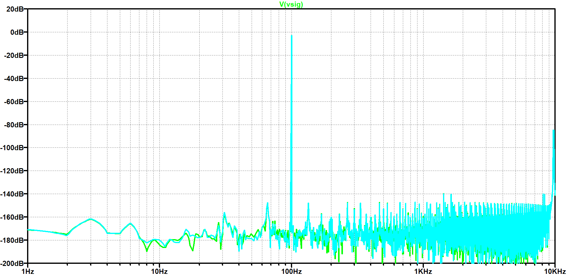

Here is a plot derived from my earlier sim showing the distortion with the DA part switched in and out along with a 3-volt DC offset upon which the 1V signal is superimposed. In short, there is no 2nd, 3rd or any other harmonics. The grass and the stuff at 10 kHz are simulation artifacts. DA is not a distortion-producing mechanism in audio amplifiers. DA cannot smear audio signals because the DA component is orders of magnitude down on the main capacitor and importantly, the associated time constant places any effects it may produce at frequencies well below the audio band.
Imagine a capacitor with an infinite number of floating shells between the plates, all of which in series reaches 470uF. The shells can have infinitely higher capacitance between shells than the total capacitance. This notwithstanding I would be interested to see at what point the distortion is a maximum. In your example is the distortion a maximum when R1 equals R2 and C1 equals C2? This is the more interesting question for me Bonsai.
That’s not a model of DA though is it? The reason DA is not a problem is the fact that the DA capacitance is a small fraction of the main capacitance and is fed through an effective high resistance. And the voltage appearing across the main capacitor terminals is low (mV).

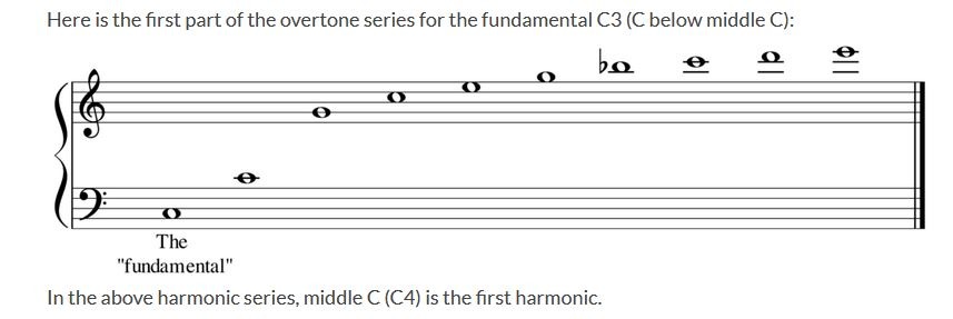

This should be common knowledge on a forum like this but acoustic instruments are not synthesizers so "single" tones have a number of overtones or harmonics.
Here are the typical harmonics of C3 on piano (from https://portlandpianolab.com/the-harmonic-series/).
So a playback chain with only 2nd HD will produce a multitude of IM tones even for this "single" C3 tone.
