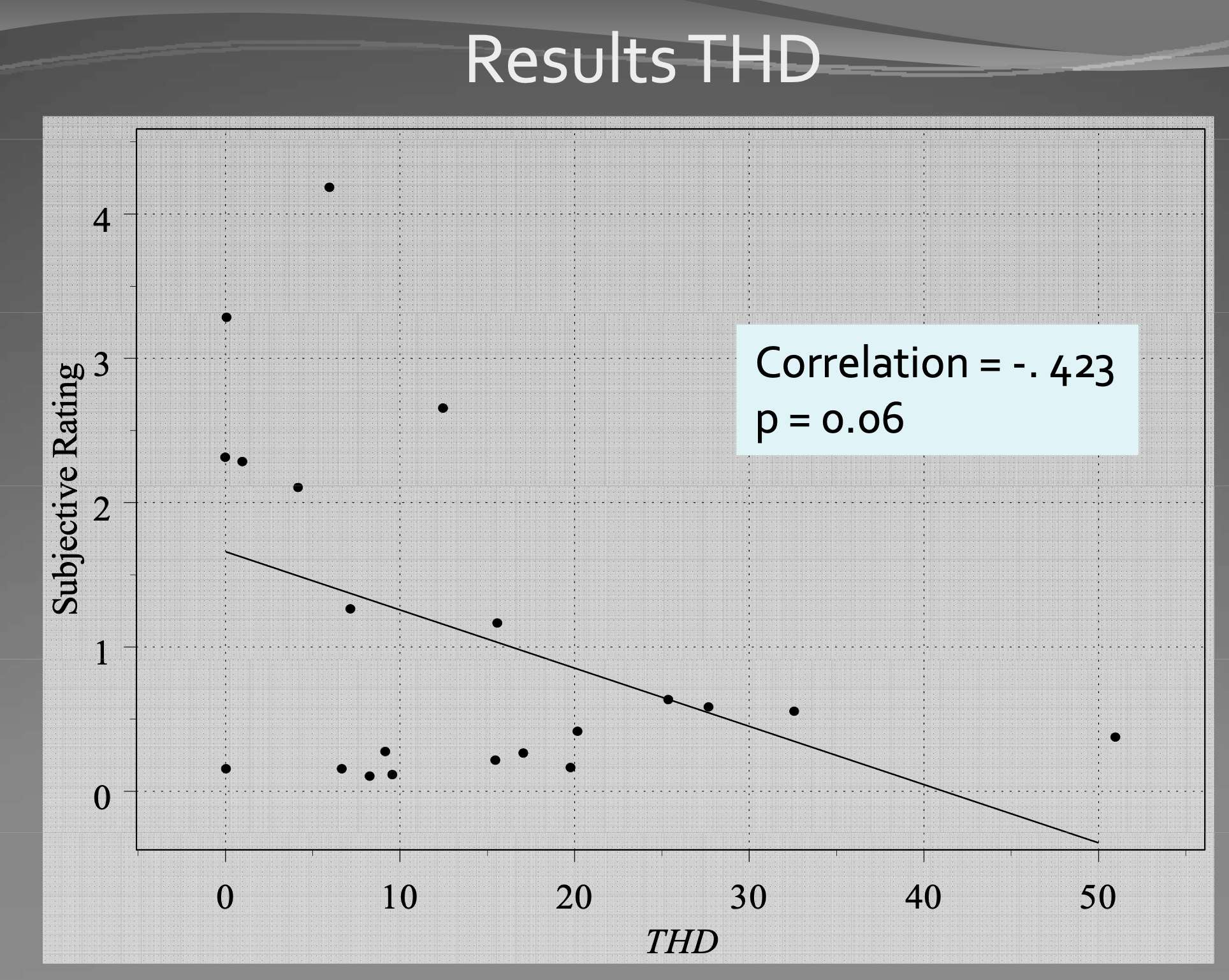

This is from The Perception of Distortion on Geddes' website: The Perception of Distortion
A correlation of -0.423 is a moderate-to-large correlation according to Cohen (1988). So I would argue that Geddes' own data say that THD is predictive of the subjective rating.
But of course Geddes would rather sell you on his Gm number. And it does indeed appear to show a much stronger correlation with the subjective rating in his experiment than THD or IMD, but that does not in and of itself make THD or IMD irrelevant.

Interesting that it is a negative correlation. IME sometimes people prefer a little HD to add false clarity if the system is in some way muddy sounding, which is something that can occur with some dacs without showing up as PSS distortion.A correlation of -0.423 is a moderate-to-large correlation according to Cohen (1988). So I would argue that Geddes' own data say that THD is predictive of the subjective rating.

Yes I can actually. As you can see in Geddes' plot, there is a moderate negative correlation between the subjective rating (i.e., how much someone likes it) and the measured harmonic distortion. Higher harmonic distortion -> lower subjective rating. So, yes. I can say that an amp with 1 % THD will be rated worse than one with 0.1 % THD by a large group of people. That's what his data show. This is one of the many reasons a measurement of THD is relevant.Anyway, the problem with THD is if you never heard an amplifier and you are told it has 1% THD, can you tell from that information whether most people would think it sounds good, or that most will think it sounds bad?

Yes. And from Geddes data I predict that audio amplifiers with higher harmonic distortion will be rated as sounding worse than those with low harmonic distortion. It is relevant to me whether my products are perceived as sounding good and therefore a measurement of THD remains relevant to me.The value of scientific model is its ability to predict the future.

A similar valid argument, based on Geddes' data, is that harmonic distortion was measured because it correlated with the perceived experience, therefore, if one designed an amp with lower harmonic distortion it would be judged to provide better sound quality than one with higher harmonic distortion.
Belcher (1974) arrived at the same conclusion. THD correlates with the perceived experience; higher THD -> lower subjective ratings. He further argued that the result of a multi-tone test (in his case, three tones) correlated even more strongly with the perceived experience, which is one of the reasons I started including multi-tone tests in my product characterization and nudged Amir at ASR to do the same.
Geddes' data says otherwise. As do Olive & Toole's data.However, it doesn't have much to do with how people actually hear.
