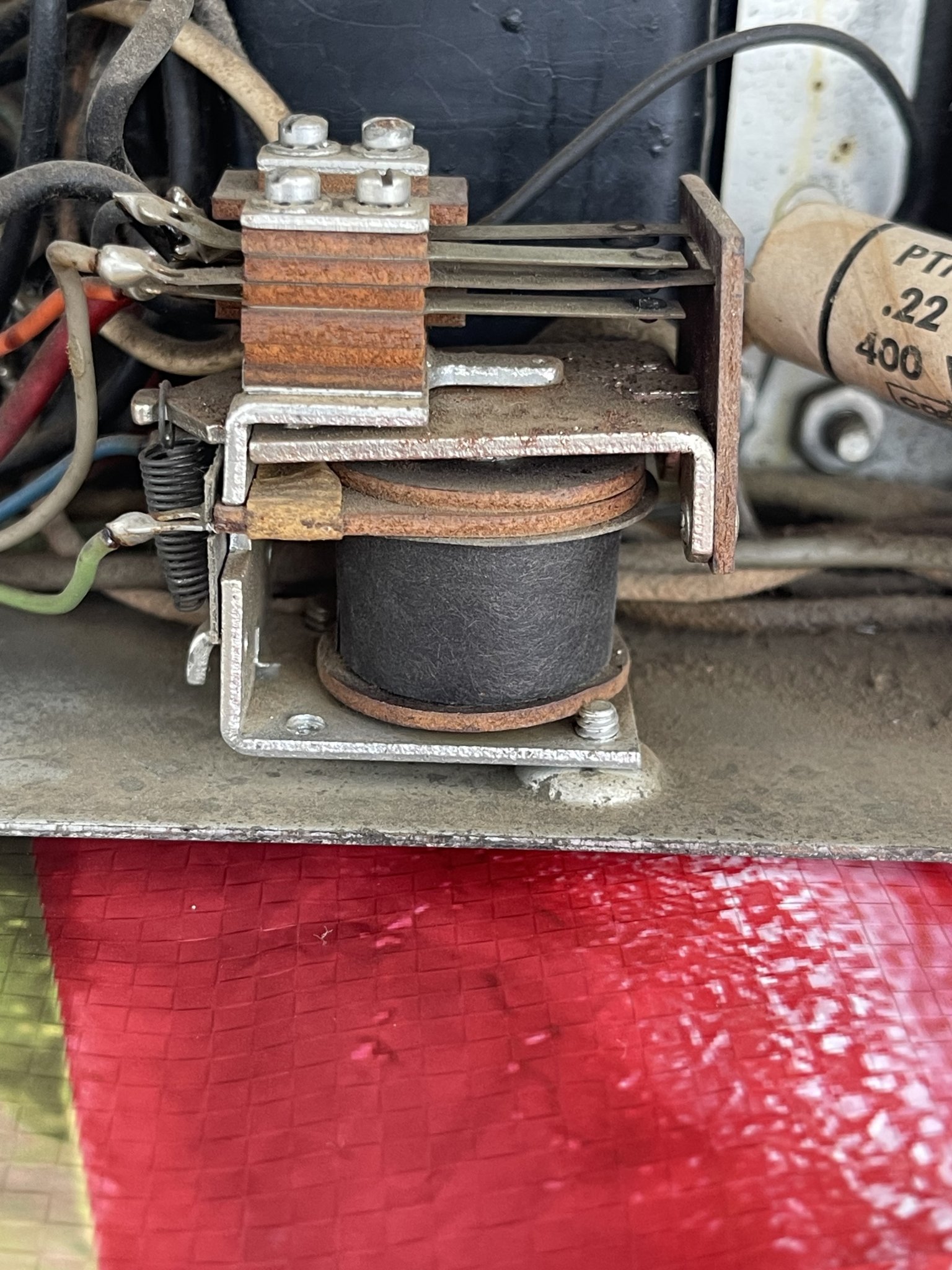

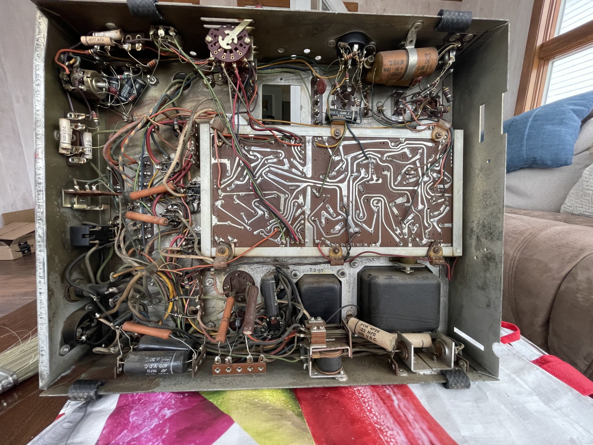

Hi so I misunderstood the jumping out the relay and it equating to jumping out the two connections on the receptacle. After making two jumpers for the receptacle the unit powered on with a strong hum. One of these large resistors got very hot at 40 volts and at 50 volts the 5amp fuse on the variac blew. Also all tubes lit up (which I know dosent show condition) except the top half of one 12ax7a tube only bottom half of this tube lit up. Thanks so much for your help gain

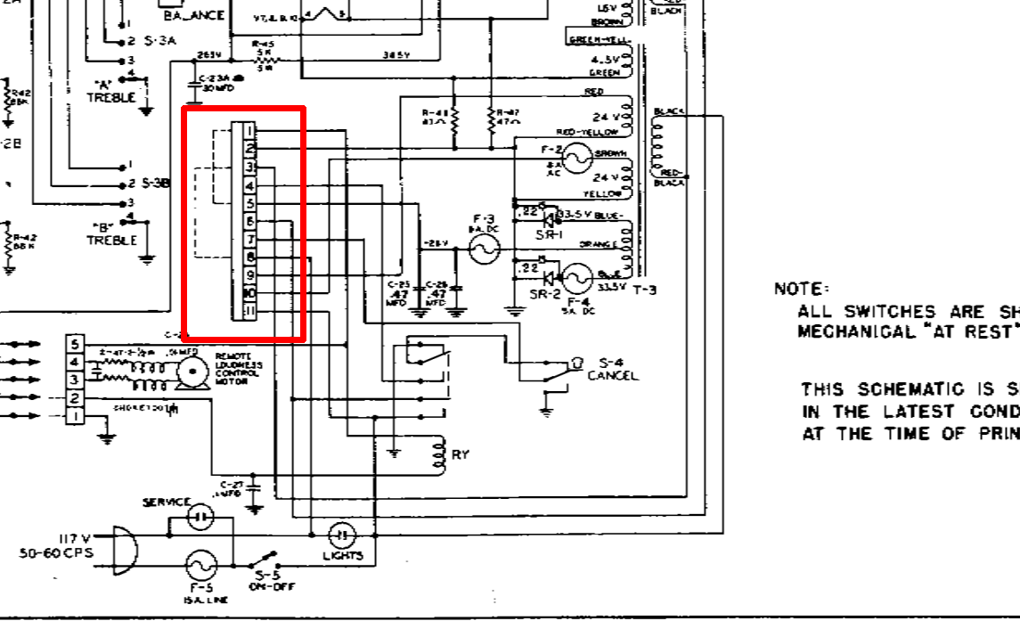

Can you draw a circle around the hot resistor on the schematic so we can see which one it is functionally? One of the cathode resistors for the output tubes?
Maybe an output tube is shorted? Maybe its grid is driven positive because of a shorted grid coupling cap?
Is it the resistor outlined in red below?
Are either of the caps outlined in orange shorted?

Check the resistors shown in the schematic as just to the right of the caps in orange boxes. They are the power tube grid resistors. Something is causing one or both tubes to be pulling too much current. At least, that would be suggested if the 5W resistor is getting more hot than it should. You could also measure the voltage drop across the 5W cathode resistor, but that's a power-on measurement in an area where there would be high voltage on some of the tube pins and adjacent components.

Hello Gentlemen, I’m making progress on the amplifier and am learning a lot along the way. There was a short and it was one that I created. I thought the socket PIN numbers ran clockwise from the top of the chassis only to learn that it was the under side of the socket.
The suggestion to buy a variac most certainly saved the amp as the variac fuse was blowing.
Next the amplifier powered on and there’s was a pronounce hum. I changed the power supply capacitors and left the cans placing them under the chasis. Also jumped the relay for the remote turn on. Thank you all for walking me through.

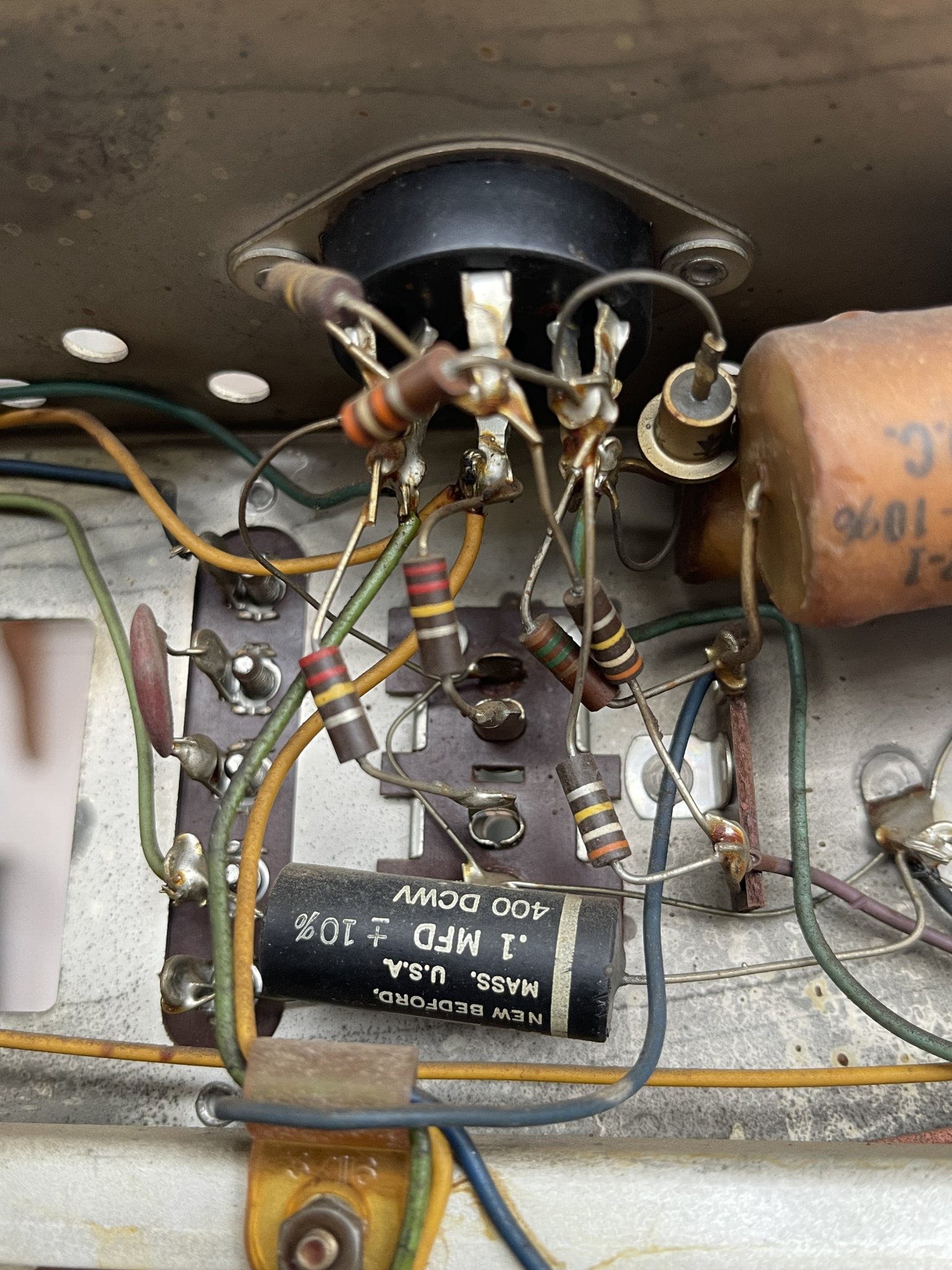

Hi and thank you for any help. Yesterday I cleaned the volume and balance pots and listened to the amplifier for hours. Today I get no audio. If I tap the output tubes or move the tone controls I hear it produce a noise at speakers. The two wax caps at the input rca’s may have smoked a bit as it was very hard to see where it came from. I am going to change them as I know these are problematic. Anything else I should look for ? Do these caps often go bad at start up? Input device is a Bluetooth adapter.
