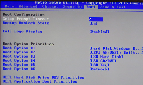

Based on the the section from the manual below, can I not use wtfplay on an Intel Atom x5-Z8300 quad core processor? I ask since I am struggling to boot from the USB.

@SAC: Yes, wtfplay-live will run on Atom x5-Z8300 CPU. Both, core2 and corei7 images should run without problem. I believe that you booting problem is related to UEFI. As for now wtfplay-live does not support UEFI boot. I have made a certain progress to add this feature, but I still need to do some work on it.
I do not know what can you change in your PC's firmware - does it include "Legacy BIOS" booting option?
Hi frd, thanks for replying. I tried all including those you suggest to no avail. This is the first time I have tried this - never touched BIOS before - but I think I am doing it right.
I did not see a Legacy bios option, but if it getting round UEFI is a feature you are adding in the next few months I will surely wait to try it.

did you Change the boot order in the bios, to boot from usb-key?
hi frd_
i don't now, but normally every bios has a secure boot/safe boot Option
i took the sreenshot from web to show what i mean,because SAC mentioned:
This is the first time I have tried this - never touched BIOS before....
alll the best
daniel

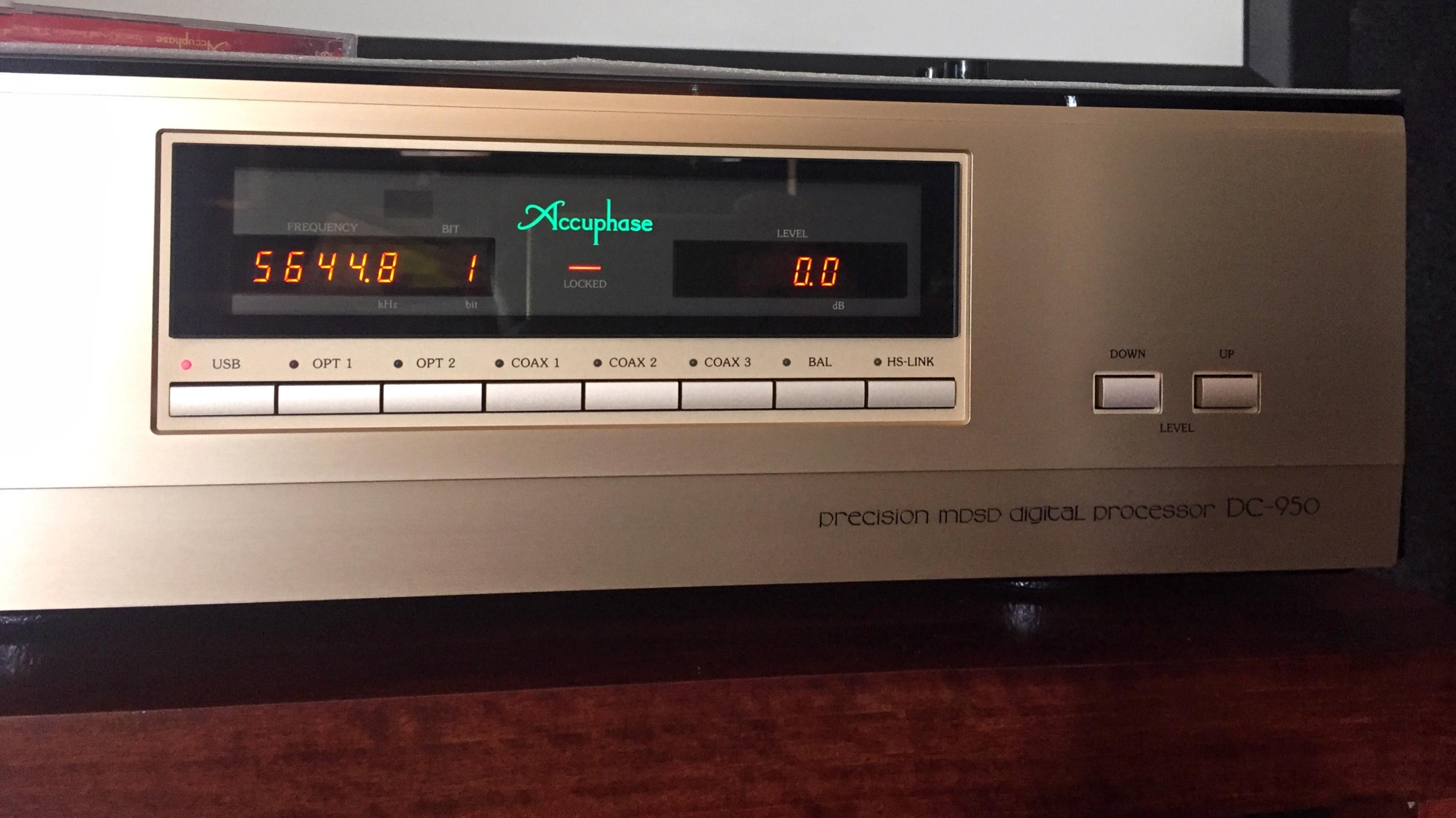

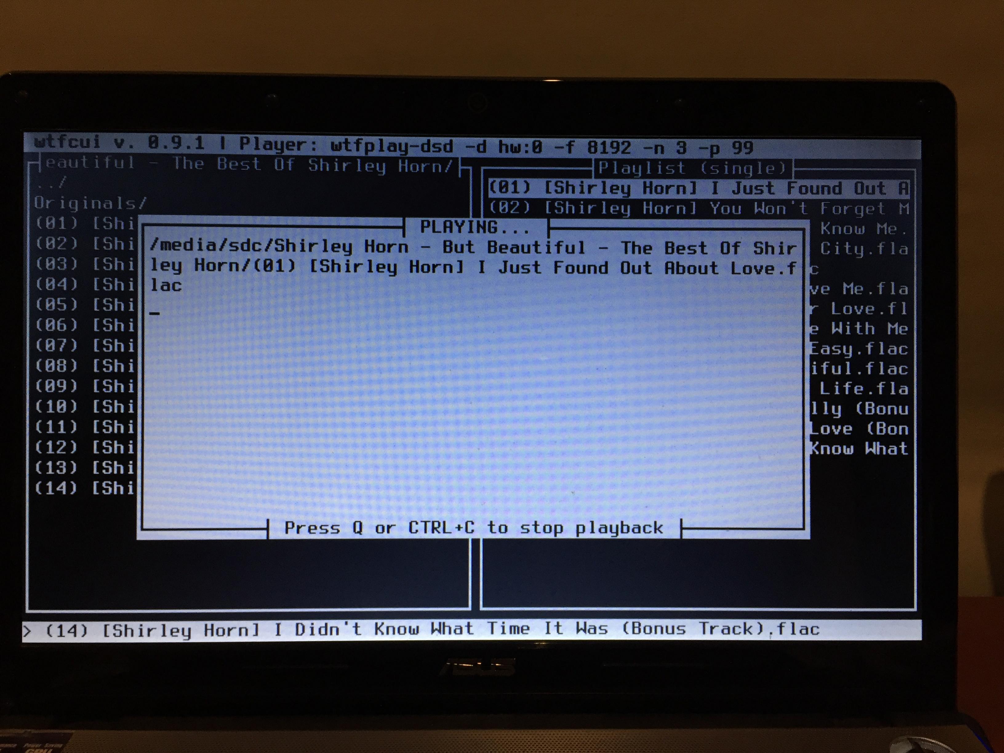

Hi frd___,
Here to report that wtfplayer and wtfplayer-dsd, played well on my Accuphase DC-950. All PCM, flac, waves, and DSD to DSD128, were playing fine. However, DSD256 and higher were not playable. Possibly - the DC-950 driver issue for Linux? Windows via ASIO driver through JPlay6.2 and Jriver were playing fine with DSD256.

Hi Chanh,
Linux uses a single generic driver for all USB audio devices that are compliant with UAC1/UAC2 standards. In theory all USB audio devices should follow those standards. In practice this is not always the case. Whether the standards leave room for ambiguity or device manufactures decide not to follow them it is not really important here. In reality, many USB devices require specific interactions with the driver that go beyond UAC1/UAC2 standard.
The problematic part in those standards is DSD, or rather lack of it. The standards do not define a way of transporting DSD data from/to the audio device natively. That leaves the open door for device manufacturers. They can do whatever they want on DSD ground and implement the DSD transport how they want. This is normally not a problem for them, as with the device they need to provide the driver for the popular operating system. Well, for many years that operating system did not even have a generic UAC2 driver.
I order to stream DSD data natively to the USB device, the generic Linux driver needs to know how to do it. Unfortunately, the USB device cannot provide that information to the driver. This information needs to be built-in into the driver. Sometimes the device manufacturers are kind enough to share this information with Linux kernel developers. More often, the developers need to simply try various things and decipher how to stream DSD natively to the particular USB device. Sometimes, the USB device needs a special, proprietary low level USB interaction to be switched into native DSD mode.
Regardless which case it is, this is the reason why Linux kernel does not support many USB devices in native DSD mode. Your DC950 is no exception here.
I should also mention that native DSD streaming is not a subject of interest for most Linux kernel developers. Those interested very often do not have access the hardware and it is very hard to to this kind of things remotely.
However I hope that the situation will improve in time. I mean, more DSD devices will be supported in the mainline kernel, and a standard way of native DSD streaming will emerge.
F
PS. The text above may have holes or some parts of it may be oversimplified. I just wanted to show the current situation at the high level, without going into technical details.
