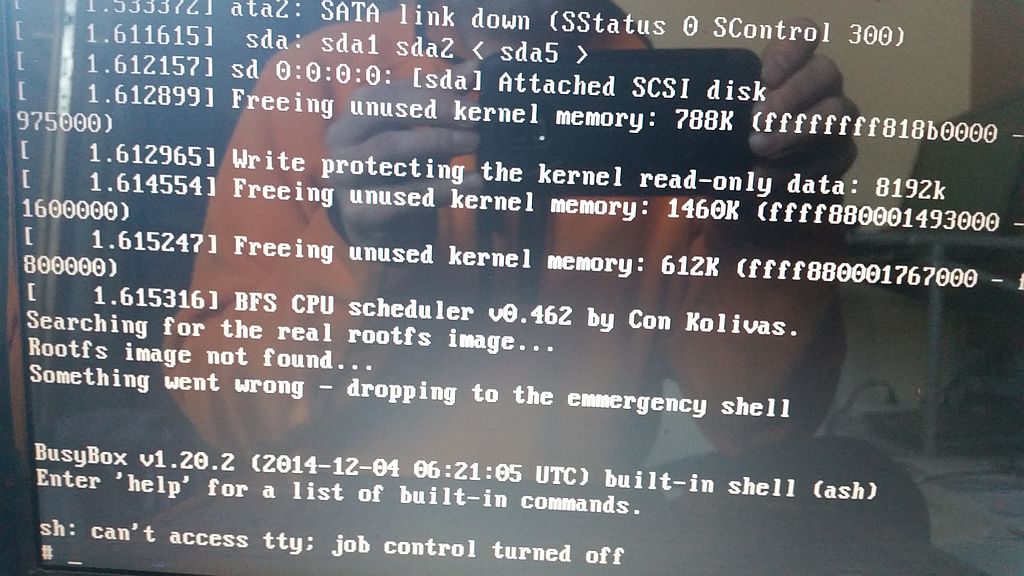

indeed,
it booted from cd
but still the issue,
please find attached "selfie":
Once booted, wtfplay-live gives itself 30 seconds to detect the boot device and find the root filesystem image on it. That failed in your case. Did you notice 30s delay before emergency shell prompt appeared?
Also while in the emergency shell, would you mind trying few commands for me? The first one is to check if the kernel detected the optical drive:
The second command is to see all block devices detected:
BTW, what is the model of laptop that you are using? Are you using SATA or USB optical drive?

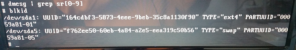

Code:
dmesg | grep sr[0-9]
Code:
blkid

Code:dmesg | grep sr[0-9]
dmesh gave just blinking hush
attached blkid,
sata cd drive
One thought: The kernel did not detect the optical drive. Would you mind checking if the SATA controller in your laptop is in AHCI mode? Thanks.
I have no such options in bios mode for ATAPI CD/DVD ROM Drive
is it possible to check it outside the bios?
Hard to tell, but a BIOS update may be a possibility. I took a look at the manual for your laptop and found a suspicious option in BIOS that is called "Enhanced SATA support". Would you mind trying various values of this setting.
The laptop should also support USB boot - at least the manual says this. You can try it again, but makes sure that BIOS tries all USB boot options first. In the boot priority section I can see USB Floppy, USB Diskette on Key and USB Hard Drive.
