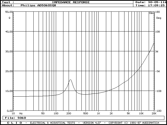

Found the impedance plot.
Fs 2oo Hz on the 5060SQ (Squawker).

Clio measurements prior to shipping,
Impedance:
Frequency response:
Quick FR measurement (little time and cramped measurement space). Distance 0.5m and no baffle (explains LF drop off). Distortion raised 30dB.
