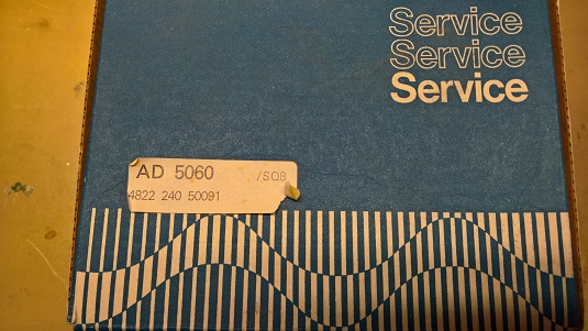

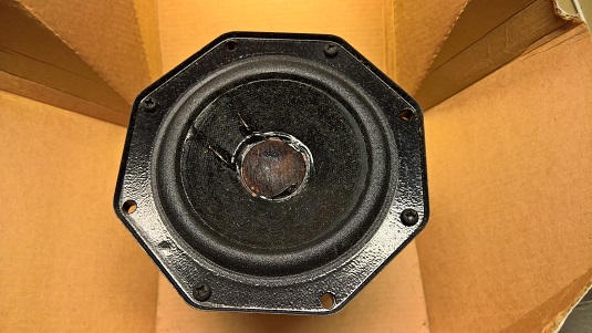

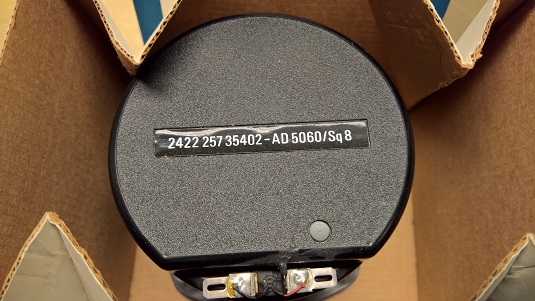

Hi mjona,
I found the AD 5060 SQ8 (8 Ohm version).
PM me if you are interested.
