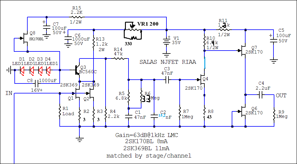

It's a low MC cart 0,21mV very similar to mine Denon DL103R, also high compliance so needs a tonearm with high mass.
See the attached schematic with Salas Folded Simplistic schematic and Guide, I'm now doing one exactly for my Denon DL103R. Do you think can do it?
  • Salas Folded Simplistic MC Doc.pdf

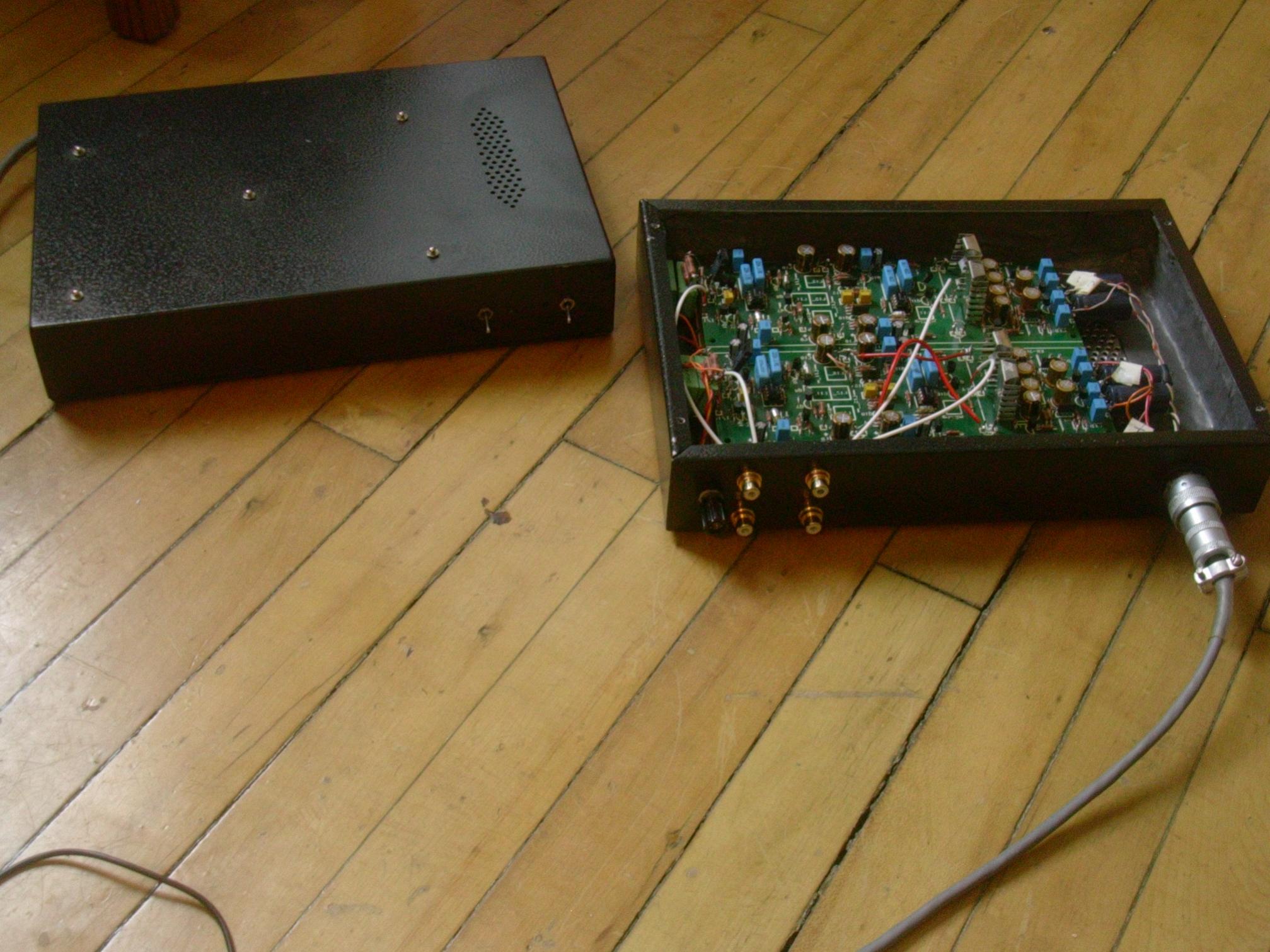

Here they are- I have two of them and a correction they are the 420 not the 432, only difference is that outputs form output amp is TO92 JFET on the 420, and TO220 Mosfet on the 432
Good listening
Peter

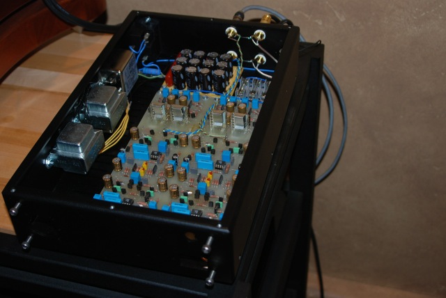

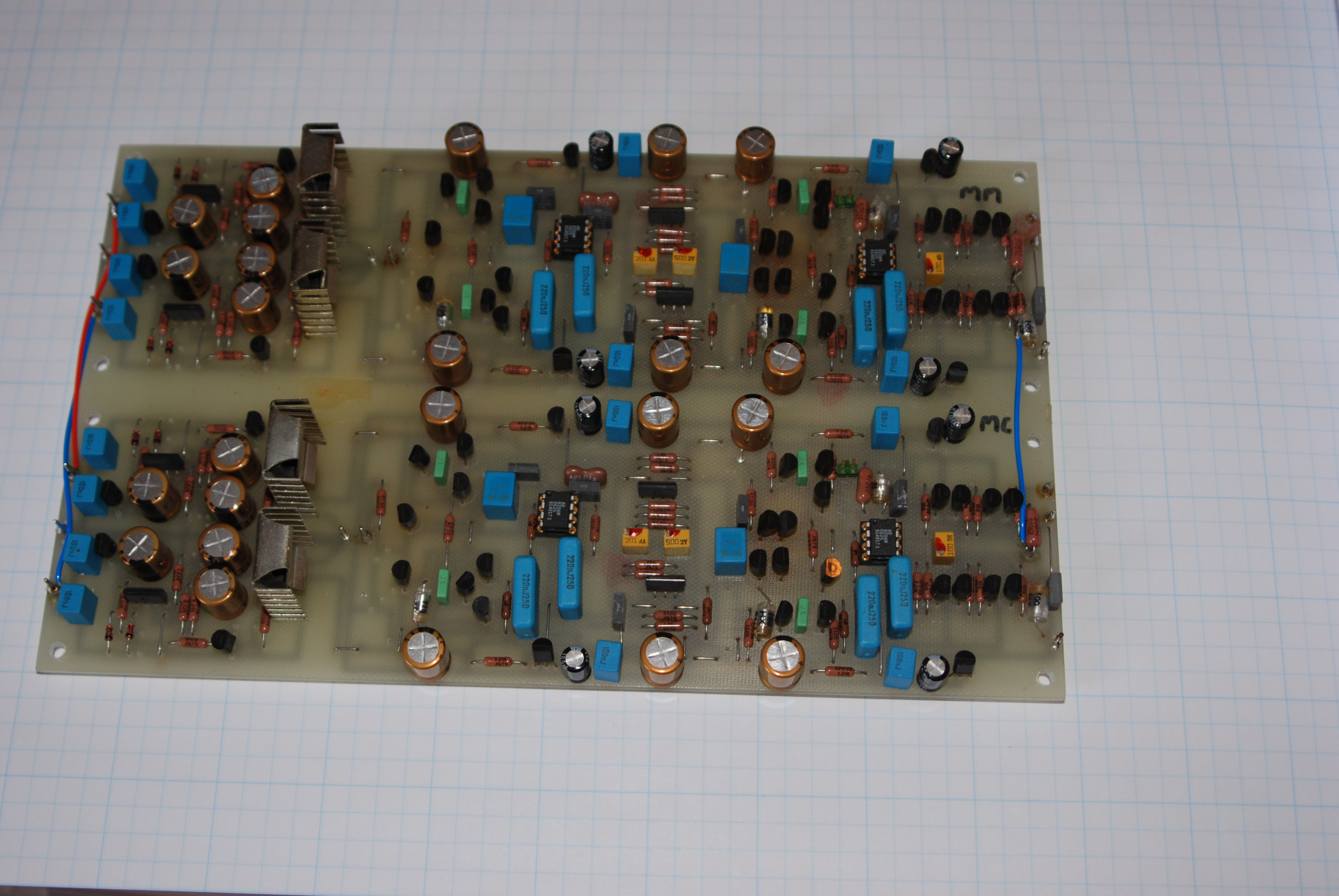

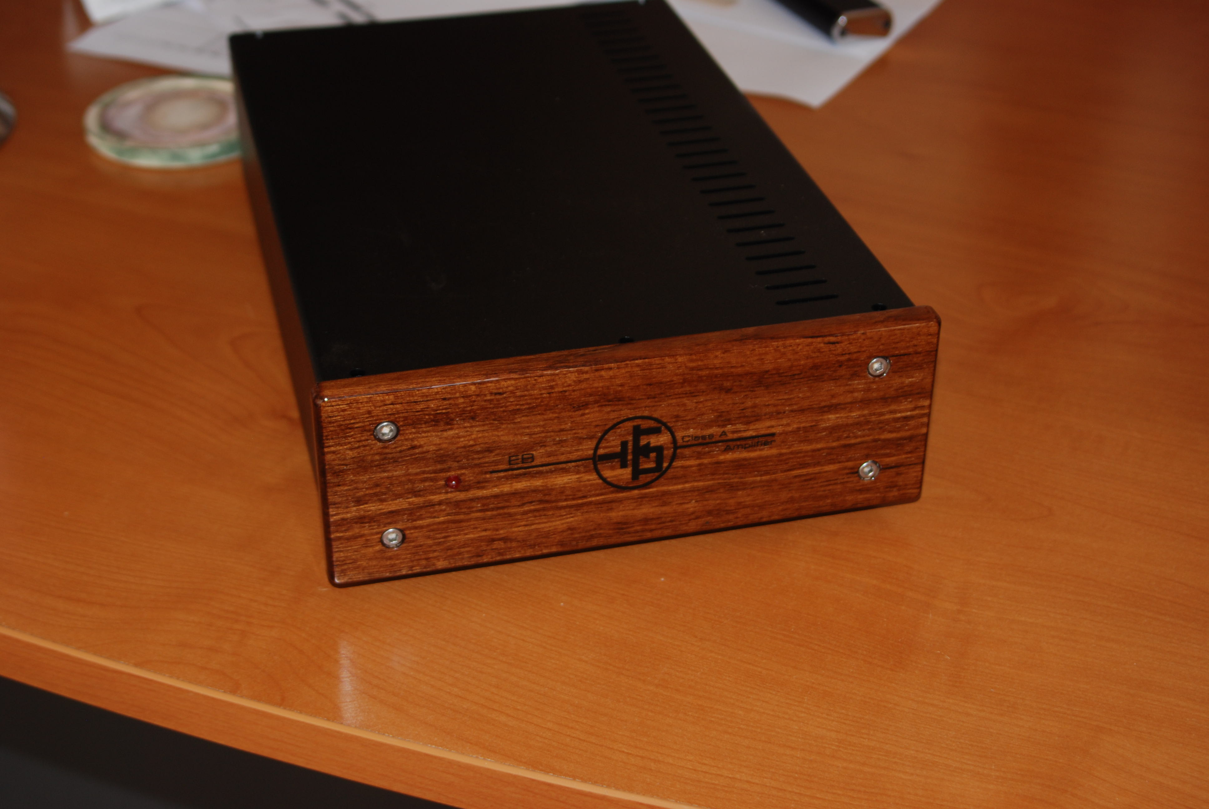

Hey , Very clean &nice build !
That's mine 419 . Vary pleasant pre for the price . It doesn't have tube pre "bloom" but it is very neutral and smooth sounding. I see that you use big capacitor bank . When I built mine few years ago the fashion was "small and fast PSU " I was going to revisit the PSU with bigger power transformers and Pre regulated supply with at leat 10-20mF on the rail.
Rgrds, L
