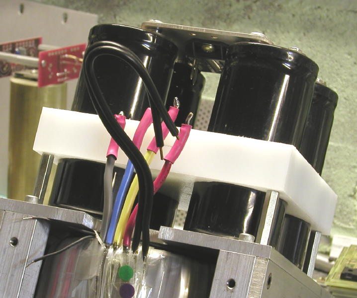

If he doesn't I wouldn't worry. It is really quite easy to wire up a power supply. Just attach the big caps with the circular brackets made for the purpose, which make a stronger and more reliable installation than a circuit bd. IMHO. The diode bridges need to be attached to the case for cooling anyway...
Here's a nice way to wire the PS caps:

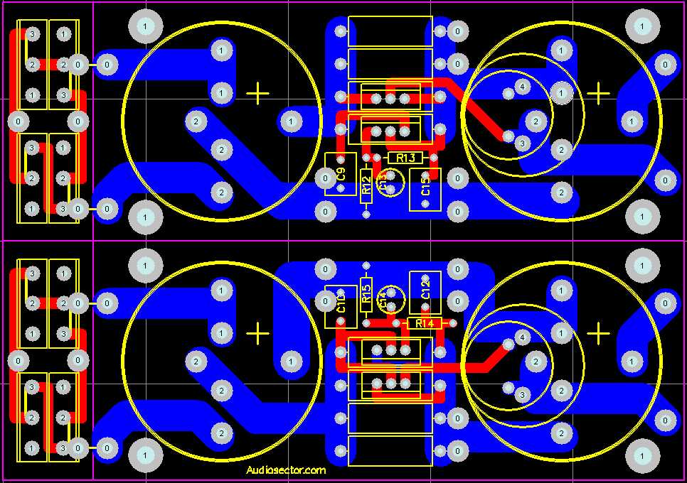

Alright, I will come up with a universal PS board, exactly same size as two amp boards.
That supply will be good for the F amps, as well for other purposes, as I plan to implement option for 3 pin regulators (in place of series resitors) , so many other applications will become also possible (preamps, CDP, DACs, even GC).

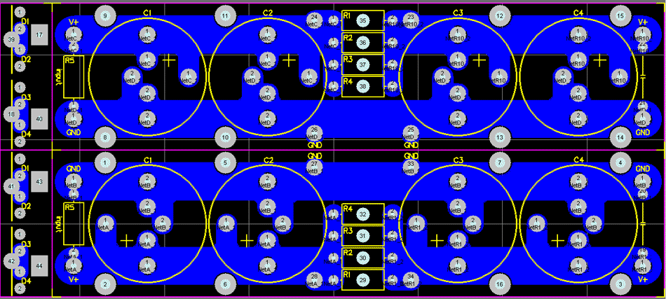

I'm glad I was pursuaded to work on that PS board as it came out prett nice. The size is 3.35 x 4.8".
Starting with diodes, the board will accept standard TO-220 packages as well 2 and 3 pin rectifiers (common cathode) in TO-247 package.
The rectifiers section is separated with a scoring line and it can be separated from main board with diodes attached to chassis or special plate for cooling (pin bending required). Cooling plates can also be attached to diodes mounted directly on a board, when heat dissipation is not that demanding.
The capacitors with diameter up to 35mm (40mm tightly) will fit. What's important though, I created a layout where advantages of 4 pole Jensen caps can be implemented to a full extend: http://www.jensencapacitors.com/audio/white-papers/4pole.html
I was really hesitant to come up with a boad to hold just 4 caps for power amplifier supply. To make it more worthwile, I also included space for regulators in addition to passive filtering. In case the board will be used for a preamp, DAC, CDP, or some other purpose where high current demads are not required, one can install 3 pin regulators in place of the series resistors: LM78XX, LM2937, adjustable LM317, LT1086 and their negative counterparts all will work here. There is also enough space for regulator's heatsinking.

Peter Daniel said:
The output holes on the right are for Jensens only.
There are two more output holes beside resistors (for each rail) and four output holes for ground (per each half of the board).
If I do more holes the board will look like Swiss Cheese 😉
