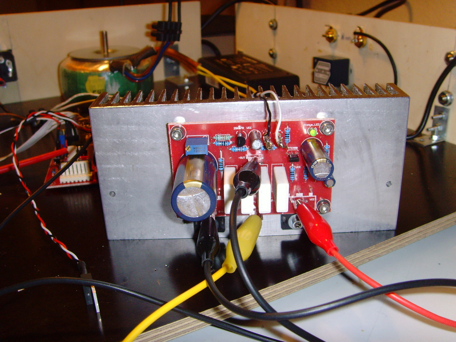

Received PCbs today posting a pic :

Well done, Sachin, I appreciate very much!
This is how the PCB shall eventually look like (see attached image).
I use Nichicon Gold / 10 µF for C3, MPC7x 5W resistors and a DELL PA10 / 19.5VAC - 4.6A LAPTOP PSU.
I am wishing you and everybody else a successful build - enjoy - Rudi

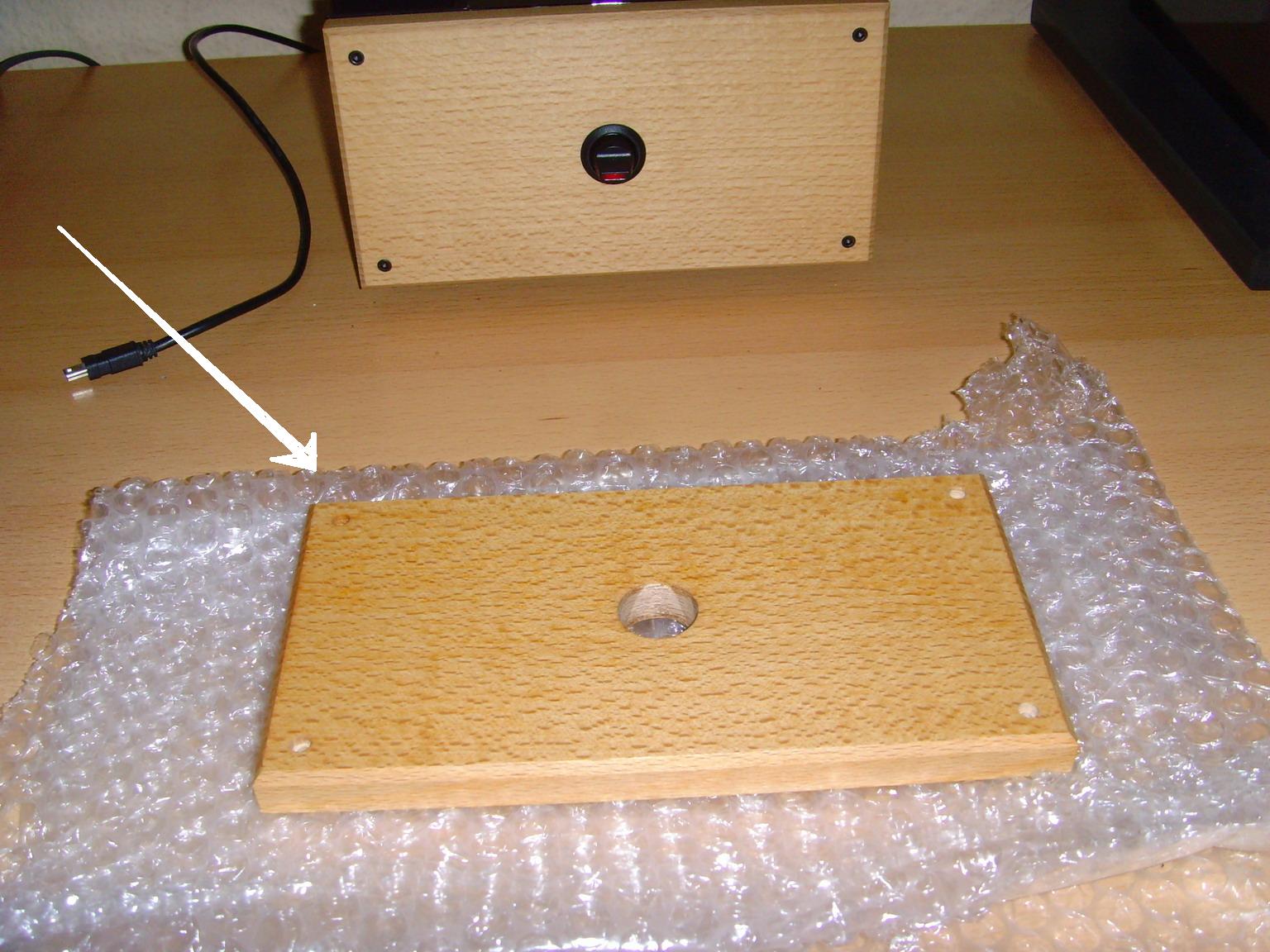

In case that anyone of you will use the same heatsinks, ..., that I used for my ACA#1: I will offer him
my spare wooden front - plate for 1€ + 3.45€ (world-wide shipping).
P.S.: Yes: I am a carpenter (LoL) 🙂 and you will never again have a such pretty front-plate like this one.

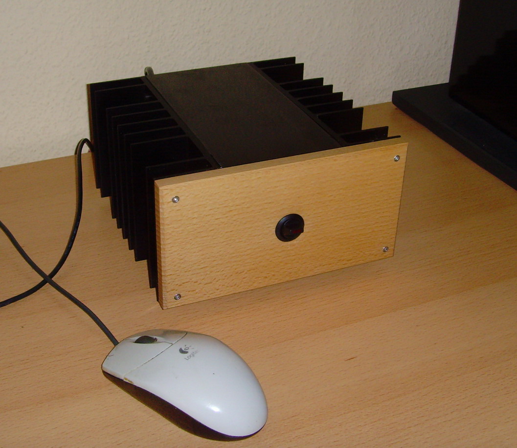

I forgot to add this picture.
Tarzan: it is me, Jane! :
Best regards -You_Tarzan - Me_Jane
Yes really nice piece of wood you have there. I plan on monoblocks and using 2 aluminum lawnmower heads for heatsinks. Might use motorcycle heads since ACA is intended to replace my garage system one day. But things have been known to change...
