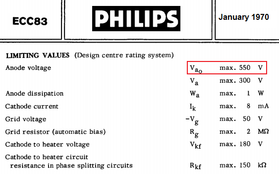

The high powered and very heavy Ampeg V2 has six KT88/6550 output valves, ECC82/12AU7 phase splitter/driver and ECC83/12AX7 pre amp valves running with a 650volt HT off load and over 30 years the ECC83/12AX7s have not suffered.
Mullard do not give an open load value on Anode/Cathode values.
I know from playing with valves and an EHT power supply as an apprentice, (the best way to learn), I found that double triodes we used in our valve 'computer' (ECC81s) withstood 2k5 DC Anode to Cathode before arcing.
So I wouldn't worry as long as the Anode /Cathode working voltage is less than 300 and the current is within the chosen valve specification.

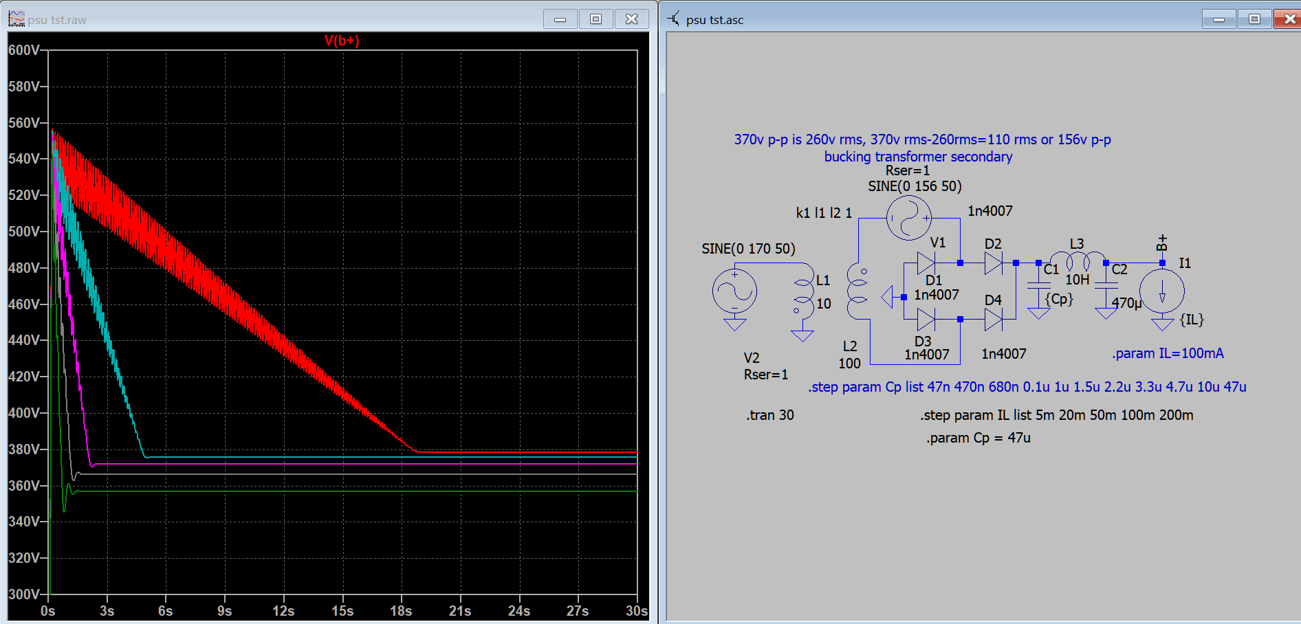

You can get that 375 VDC from that 375 VRMS, with a pseudo choke I/P filter. A pseudo choke I/P filter is cLC. That 1st cap. will be smaller than 1 μF. The exact value needed is determined empirically. Start with 0.1 μF. and tweak away. Use a high WVDC part to prevent failure, if and when an inductive kick back spike occurs.
Go to Heyboer or other competent winder of magnetics for a choke I/P service suitable 10 H. inductor of adequate current handling capability. Choke I/P service beats the living guano out of inductors. So, "an off the shelf" Hammond part has to be derated. Put a 10 Kohm bleeder resistor of sufficient power rating across the 1st filter capacitor. That value for the bleeder ensures the critical current needed for good regulation gets drawn.
Unlike cap. I/P filters, choke I/P filters allow access to the full RMS current of the power transformer's B+ rectifier winding. Therefore, you more than make up the 38 mA. lost in the bleeder.
FWIW, choke I/P filters are a simple way to get a reasonably well regulated B+ rail. They are frequently found in radio transmitters to assist in carrier frequency stability..

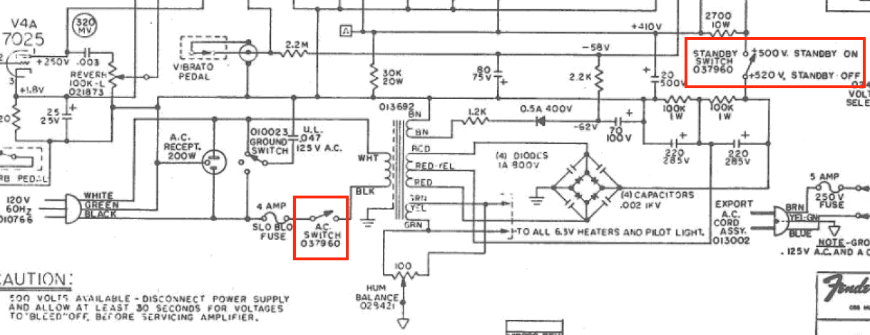

You can use the OLD guitar amplifier trick: add a Standby switch, which controls the HV voltage.
You turn main Power switch ON, wait 40 seconds for filaments to warm up, turn Standby ON.
That said, why CLC?
You do NOT want to start with a C which inevitably will charge to peak voltage.
Start with L and simply wait 40 seconds to create a current demand which will let it do its job.
That will be the best option since it will "erase" your RMS to Peak confusion 🙂 but IF you go the C input and higher voltage route, look at the classic Fender Twin Reverb power supply , including the Standby switch.

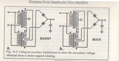

Another approach is to buck down the secondary voltage, has better regulation and lower initial peak surge. I use 3x1000u/200V=330u/600v in series and resistor dividers for 2nd capacitor, very quiet, it's also much cheaper than 450v cap of same value.

Thanks every one for your replies. It sounds unlikely that I'm going to blow out my tubes during warm up.
Ketje specifically posted from a datasheet that showed an "open anode voltage" limit, which the datasheets I was using(Sylvania and many others) definitely do not have. (It seems like 12AX7 versions don't specify this, while ECC83 do, kind of weird). Having played with much higher voltages in the past (with the intention of producing arcs), I thought 300V was surprisingly low. These tubes are much smaller than they looked from photos and there's two triodes, so just wanted to double check.

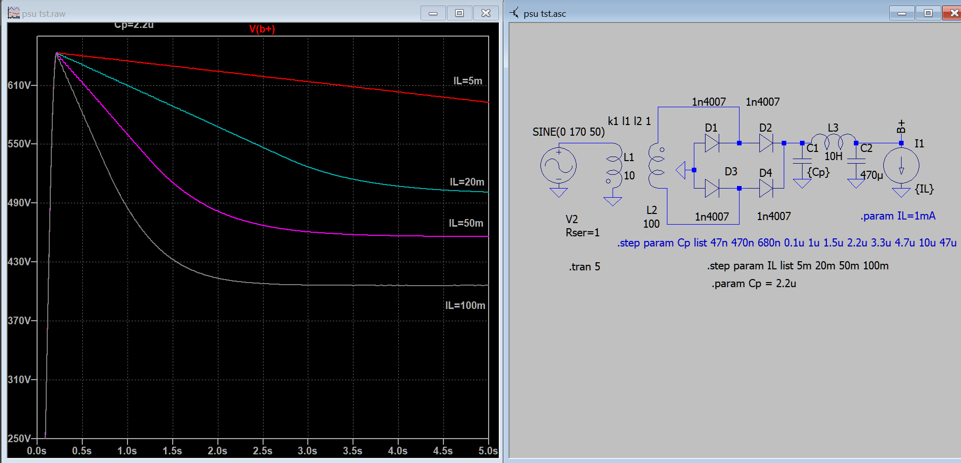

I run the simulation as suggested, see if any help. For other values you can run the sim again if you know LTspice or call us again.
TIL about these parameters in LTspice, that's really useful.
