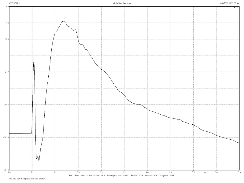

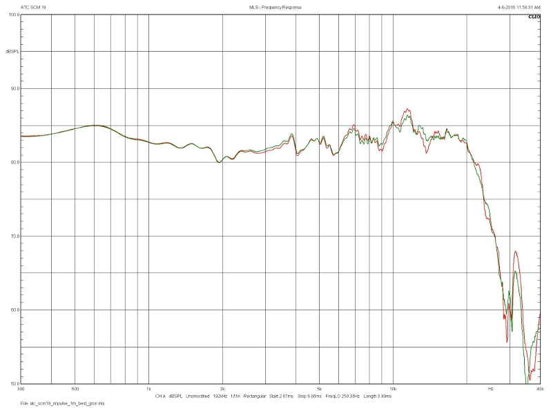

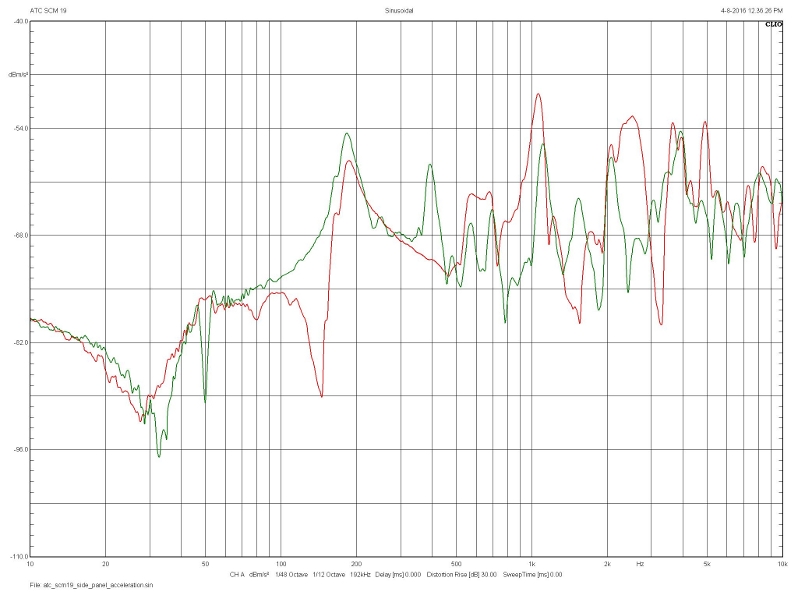

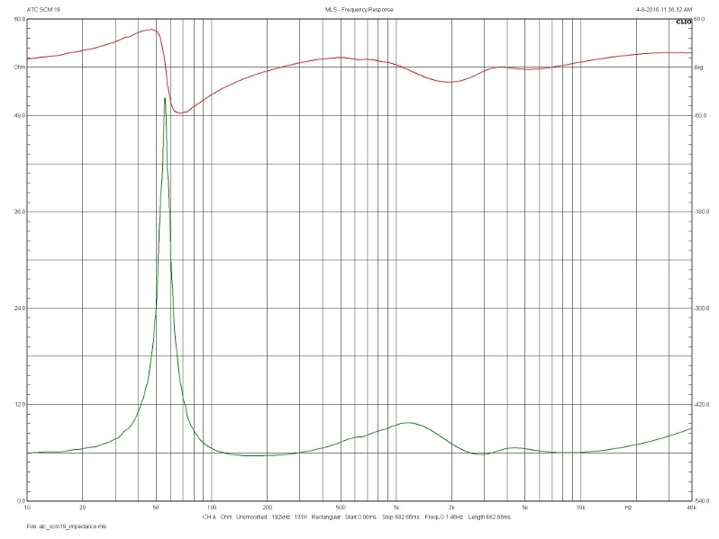

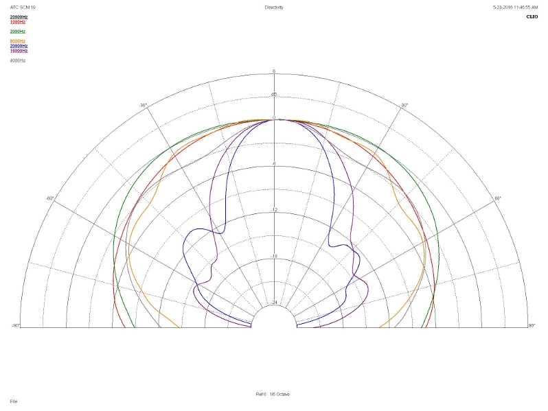

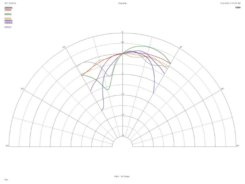

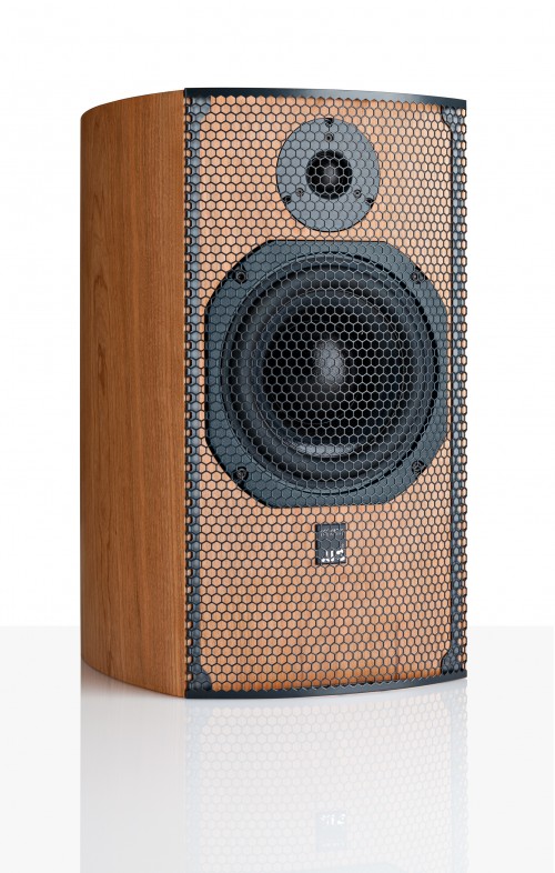

The fact is that we have a bunch of favourite older speakers that fall into the (approx.) 19L / 4R (min dip) 90dB camp. Sorry, no measurements available.
If we were to buy a new speaker, something like the ATC SCM11 or the bigger ATC SCM19 would be on the cards - depending upon the room size at that time.
Given that (I understand) the ATC SCM19 is the more difficult of the two speakers to drive, I have provided measurements below.
So the question now becomes: How would the TRANSCENDENT SOUND BRUISER fare, driving the ATC SCM19 (V2) loudspeaker?
Listening Habits Note: We do a lot of late night listening. We are not interested in rocking the neighbourhood, but occasionally like to let our hair down. Music ranges from CLASSICAL to ELECTRONICA and everything in-between.
I hope this information helps to answer the questions I have about the new kitset TRANSCENDENT SOUND BRUISER amp - and big ups to AVMENTOR.NET for their very thorough measurements of the ATC SCM19... ATC SCM19 | Review Lab Evaluation - AVMENTOR.net

With the Bruiser you will likely not have the electrical damping you need with that large a resonant peak. The rest of the spectrum is fairly flat but there will be a bump up at just above 1kHz. It might just counter the trough in the measured FR.
You might well have to push your boxes toward aperiodic to kill that resonant peak.
It's a sealed box design.

The effect of the highR can be looked at as bump up in the Qt so the box Q will move up. Or that as the impedance rises so does the output power creating a peak. Same thing. Boomy bass.
Adding aperiodic ducting on the back and appropriate damping can lower the resonance peak.
