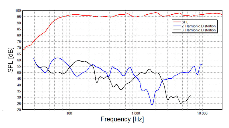

Giving another look at the spectrum, on the contrary giving just bellow 1% , the 3rd order harmonic is -26db . This is 5% and it cannot be of opposite phase . If you are looking HIFI tube amp with less than 0.1% , chose Williamson or Müller type . It is to know that loudspeakers ca very easily reproduce high distortions . Bellow is the curves of a small size Seas kit flung at Loudspeaker kit SEAS Mimir, with cabinet kit birch plywood 18 mm thick you can see low distortion speakers are not less than 1%. When it comes to pickup cartridges that many vinyl lovers appreciate, you find the measurements of shureV15 V ,revered by radio broadcast ,recording studios . 1.8% second harmonic 0.5% third harmonic 3%IMD (right ) . SE 2A3 generates 2%distortion at 3w . By this, if you see one day these components are given away for free , walk away to avoid being treated to be an Audiophool by just hatched ones .
