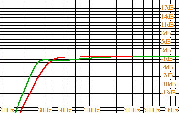

If cost is as big a factor as you say, try a Blueprint 1001. Sure it is only a 10", but with 16 mm excursion it moves as much air as 12" with a 12 mm excursion-which is itself a very very long excursion.
Cost: $81 plus shipping.
http://www.blueprintdrivers.com/
Here are two possibilities, (ported).
The red shows a 1 cu ft box tuned to 29 Hz
The green shows a 2 cu ft box tuned to 25 Hz.
Oh yeah. I figured out the sensitivity from the Thiele small numbers. It is 86 dB @ 1M/1W. that is 89 dB @ 2.83 Volts, the way some manufacturers measure it.

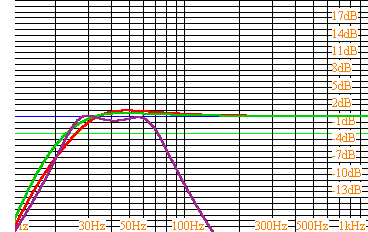

Blueprint 1201 for $91.
Following are 3 choices.
Red is 3 cu ft box tuned to 21 Hz.
Green is a 4 cu ft box tuned to 20 Hz.
Purple is a 4th order bandpass box, 3 cu ft total. Front is 1.25 cu ft, tuned to 41 Hz. Rear is 1.75 cu ft, sealed.
You should know the following:
A) I have never built a bandpass box, these graphs are from WinISD.
B) I have never used Blueprint Drivers, but they are highly recommended by others on this forum.
As you can see, the 4 cu ft box is about 4.5 dB down at 20 Hz. Pretty good.
I have not run the numbers to establish the sensitivity of the 1201 yet. I will do so shortly. My guess is that it will be about 1 or 2 dB more sensitive than the 1001, which is 86 dB @ 1 watt, or 89 dB at 2.83 volts.
Good luck!

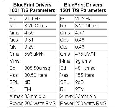

blueprint subs
where can I find specs on the blueprint subs? I am impressed by their looks, descriptions, and most of all the price of the 1201!
-andy
-andy
Andy:
Here is the link-right now they have only the 01 series in stock:
And here are the Thiele Small parameters for the 1001 and 1201.
The sensitivity for the 1201 was calculated by BoxModel, using the Thiele Small parameters, as 86.6 dB @ 1M/1W., or 89.6 dB @ 2.83 volts. The sensitivity for the 1001 was calculated as being .6 dB less than the 1201.

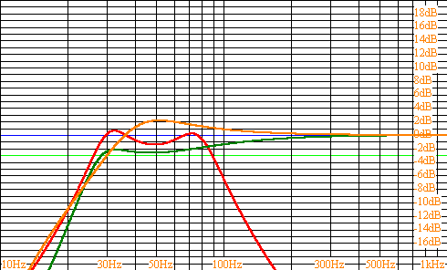

Well, just keeping your options open. The following 3 graphs are for 2 cubic foot enclosures.
The red is a Blueprint 1201 in a bandpass enclosure. Front chamber: .85 cu ft tuned to 48 Hz. Rear chamber: 1.15 cubic ft, sealed.
The orange is a Blueprint 1201 in a 2 cubic ft enclosure, tuned to 25 Hz. A 2dB bump is not really outrageous.
The green is a Peerless XLS 12 ", (5 ohm) in a 2 cubic foot vented box tuned to 27 Hz.
Good luck whichever way you go.
