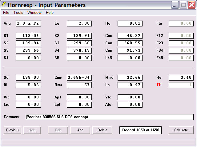

would these be ok in a tapped horn or folded, any ideas, i got two the price is good

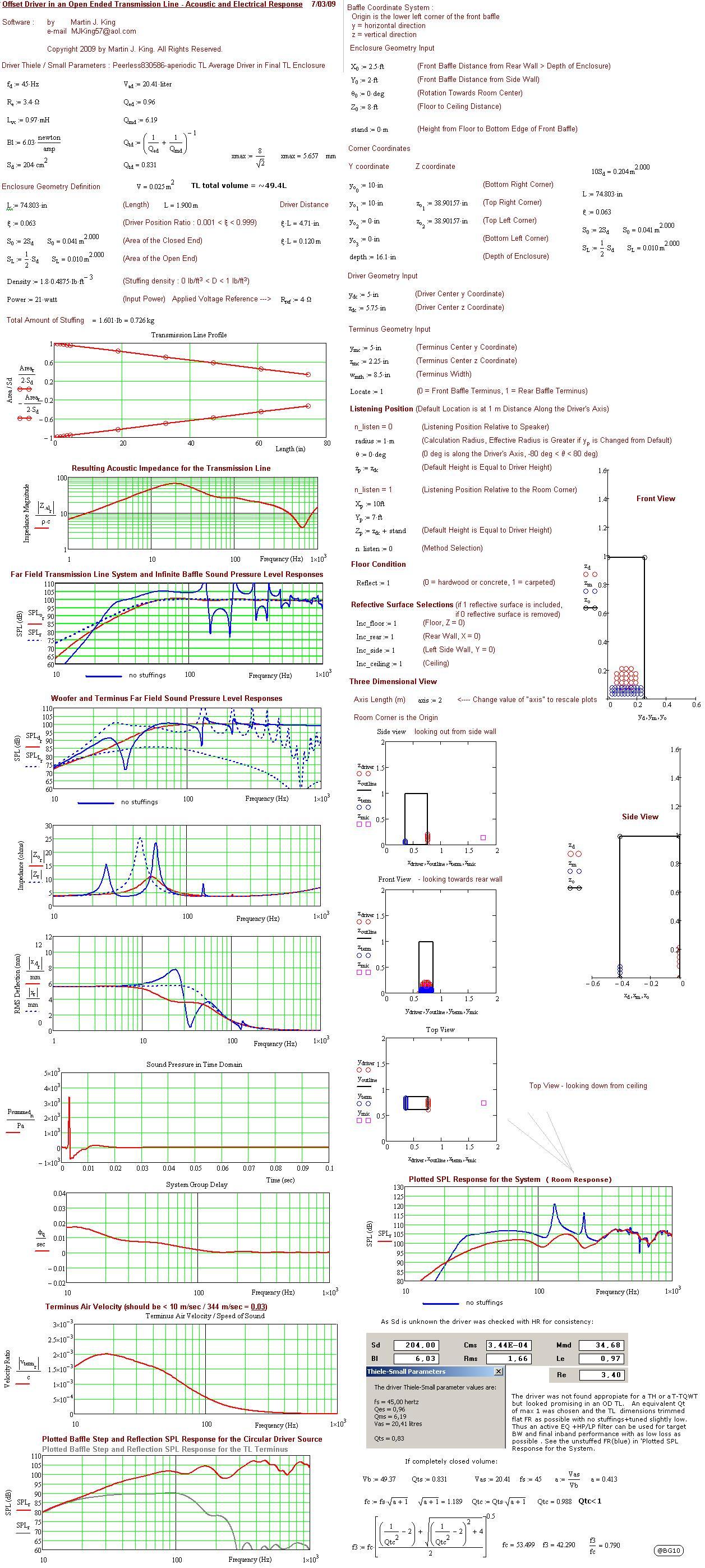

FYI, A TL simulation:

I thought the bucking magnet *decreased* the BL slightly, and that you get in increase in the field when you dispense with it. But certainly not by enough to make a speaker more horn-friendly....
IME, adding a magnet either did nothing or slightly lowered Qes, ergo taking it off may increase it, but I agree that it probably won't be enough to audibly affect the design. That said, there was a small Audax that could be had either way and the shielding dropped it almost 20% IIRC, but I've never seen anywhere this much on the 8"-up drivers I've messed with and finally settled for using cold rolled steel (CRS) sheet in the cab to shield larger, more powerful drivers.
GM
Well, we'll find out soon enough. I will measure a driver, then knock off the bucking magnet and remeasure. If they're not useful without the magnet, I'll send them out to live on the shelf of useless woofers I have out in the shop....

PA-style tapped horn bass on the cheap - if it all works out. In simulation-land with fairy-tale parameters, I get >100 dB with a watt from 30 Hz to >120 Hz from a pair of $20 12" drivers, and the model says the drivers reach excursion limits at just about the same time as thermal limits.
Downsides? It is a BIG enclosure for a pair of 12s, and it all hinges on manufacturer parameters currently - I'll get actual driver measurements soon (probably Tuesday). I'll measure the M&K's at the same time.
Turns out that the specs were reasonably close to the listed ones. The driver is a Parts Express buyout, item number 299-246, which is a Miller & Kreisel badged Peerless 830586 8" SLS Shielded Woofer.
They'll work well enough in a tapped horn - with or without the magnet. They don't take a lot of power before excursion gets silly when asked to play low, and the cabinet gets pretty big. I've got other stuff to do, so I will not be playing with them any time soon.
